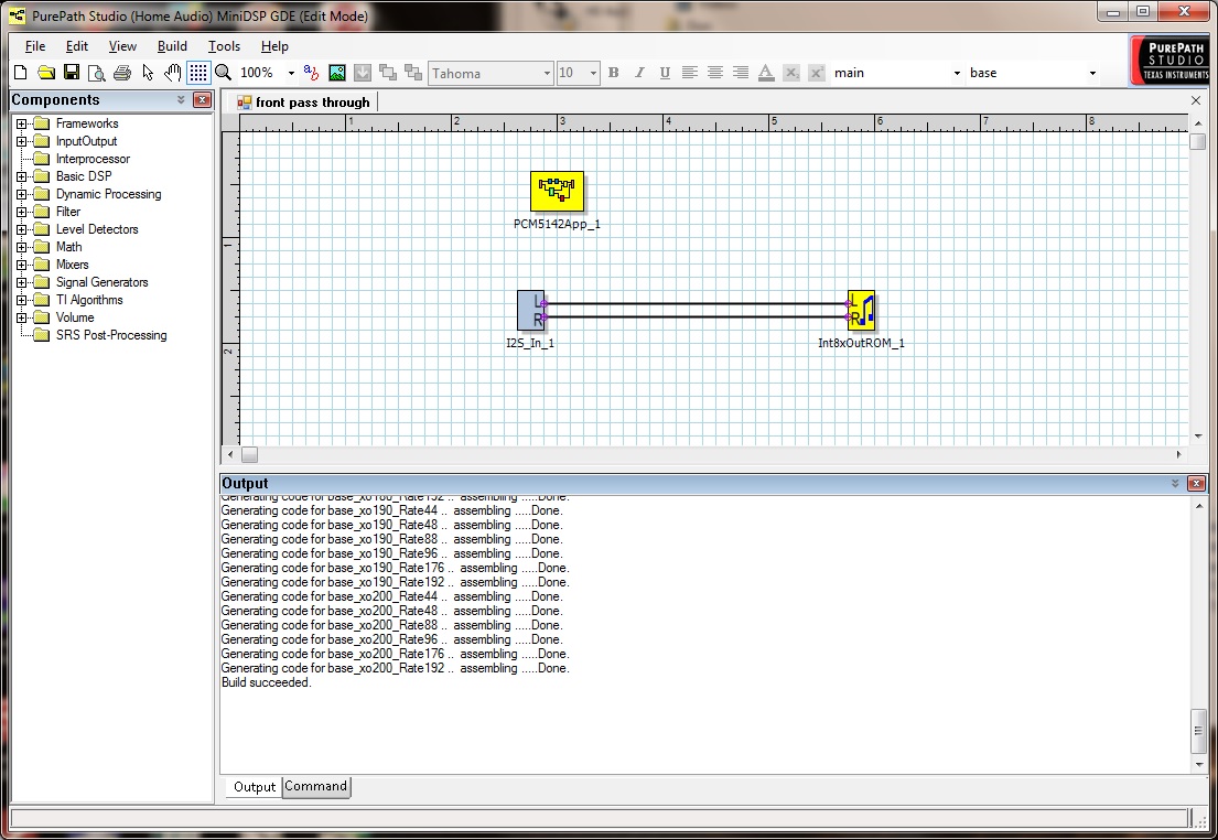

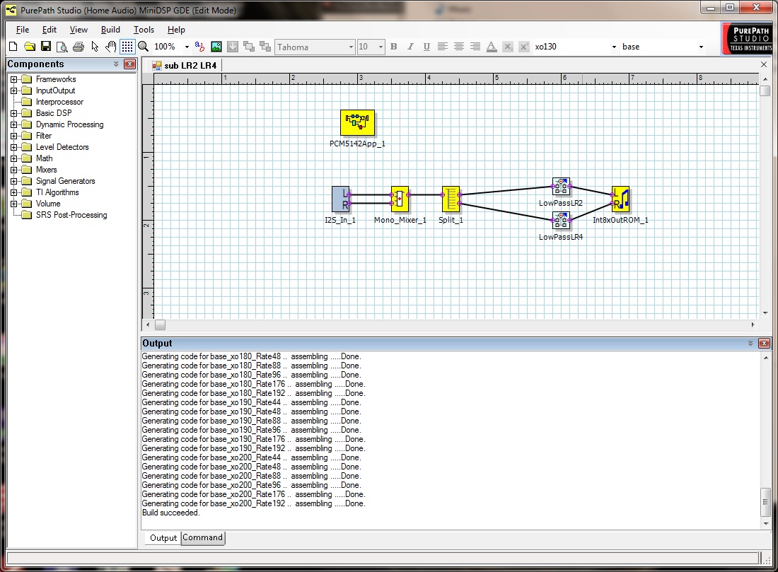

In the meantime you can try the firmware from post #91. It uses a less aggressive BW2 instead of LR4 for DAC#0. If your fronts have a sealed woofer it will match slopes much better to the subwoofer.
Tonight, I'll post a firmware pkg that is pass through for DAC#0 (no HP filter).

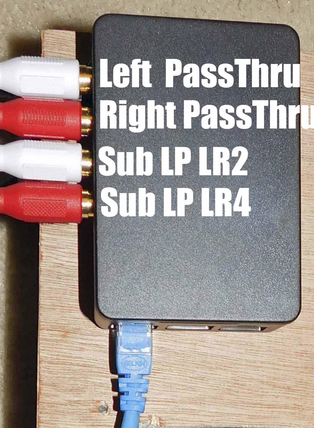

Firmware - DAC0 Front (L&R) pass thru, DAC1 sub LP LRx
@komerdoor - this is for your evaluation. You can always mix & match with other firmware in this thread.

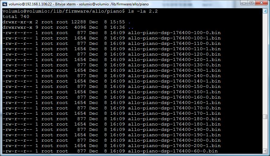

Ok tried it. I do not get any sound. Both firmware binaries loaded fine, so I am not sure if this is because I use the Allo Volt. I replaced the 2.2 firmware and switched to 2.2 mode. It works again after I restore the original firmware.

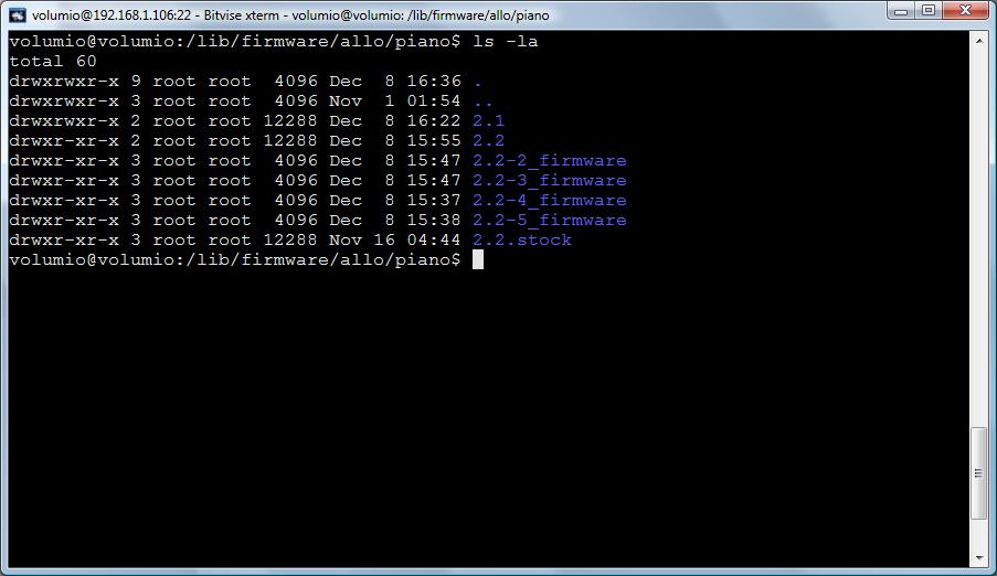

^ I just downloaded and tried 2.2-5 and it works fine via Volumio. It's unlikely that the amplifier shield is causing the problem. It's more likely a problem with the copy, or permissions, or "sticky" configurations.
I've put screenshots of the directory permissions and contents of the 2.2 directory after I copied the 2.2-5 firmware into it. Note the file sizes which are related to the firmware build.
With Volumio, 1) I copy the firmware files over to the 2.2 directory, 2) select the mode I want, 3) reboot the system. I can see from dmesg that the old configuration (sticky) is initially loaded then it's overwritten with the new configuration.

Thank you. It works, but only if I set my MPD settings to the following:
audio_output_format "192000:32:2"
Instead of:
audio_output_format "384000:32:2"
Kernel log of firmware being loaded when I play a song using the 384000 setting in MPD:
Code:
[  134.775288] pcm512x 1-004c: Dsp Firmware File Name: allo/piano/2.2/allo-piano-dsp-192000-60-0.bin
[  134.987251] pcm512x 1-004d: Dsp Firmware File Name: allo/piano/2.2/allo-piano-dsp-192000-60-1.bin

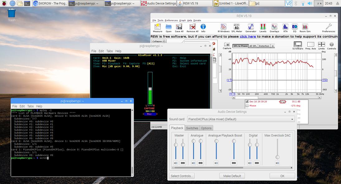

REW + UMIK on the RPI
I wanted to see if I could do measurements directly on the RPI using the Piano2.1 and the audio processing chain. This means temporarily attaching a monitor, keyboard, and mouse to do the install setup. I'll see later on if I can export the display and run it remotely.
Using a separate SD card, I loaded NOOBS 3.0 Download NOOBS for Raspberry Pi , booted and installed Raspbian full. There is s/w I don't need that can be removed (mathematica, scratch, etc) using [menu][preference][add/rem software] to free up space. An 8GB SD card is enough and I used 65% of it.
Then REW is installed from REW - Room EQ Wizard Room Acoustics Software by downloading the "Linux Installer" then you change the permissions of "/home/pi/download/REW_linux_5_19.sh" using "chmod 777" then run that script to install REW. The stock Raspbian Java worked fine and I did not need to install the Oracle version.
The Piano2.1 was not automatically detected. So enable the I2C interface using [menu][preference][rpi config] and in the "interfaces" tab enable I2C, remote GPIO, VNC, SSH then OK. To enable the Piano2.1 overlay edit "/boot/config.txt" to add the following, then reboot.
Code:
# /boot/config.txt
# additional lines to add overlay for piano
audio_pwm_mode=2
dtparam=i2c_arm=on
dtoverlay=allo-dac-plus-pcm512x-audio
Then make the piano2.1 controls visible using [menu][preference][audio device] and [select controls] and toggle on all 25 radio buttons or some subset you need. You will now see all the controls in Alsamixer and see the soundcard with "aplay -l".
Plug in the UMIK-1 mic and it installs no problem and will be recognized in alsamixer.
Launch REW and it will prompt for the UMIK cal file. Set the preferences to use the Piano2.1 and UMIK and make a measurement. Display screenshot pic below.

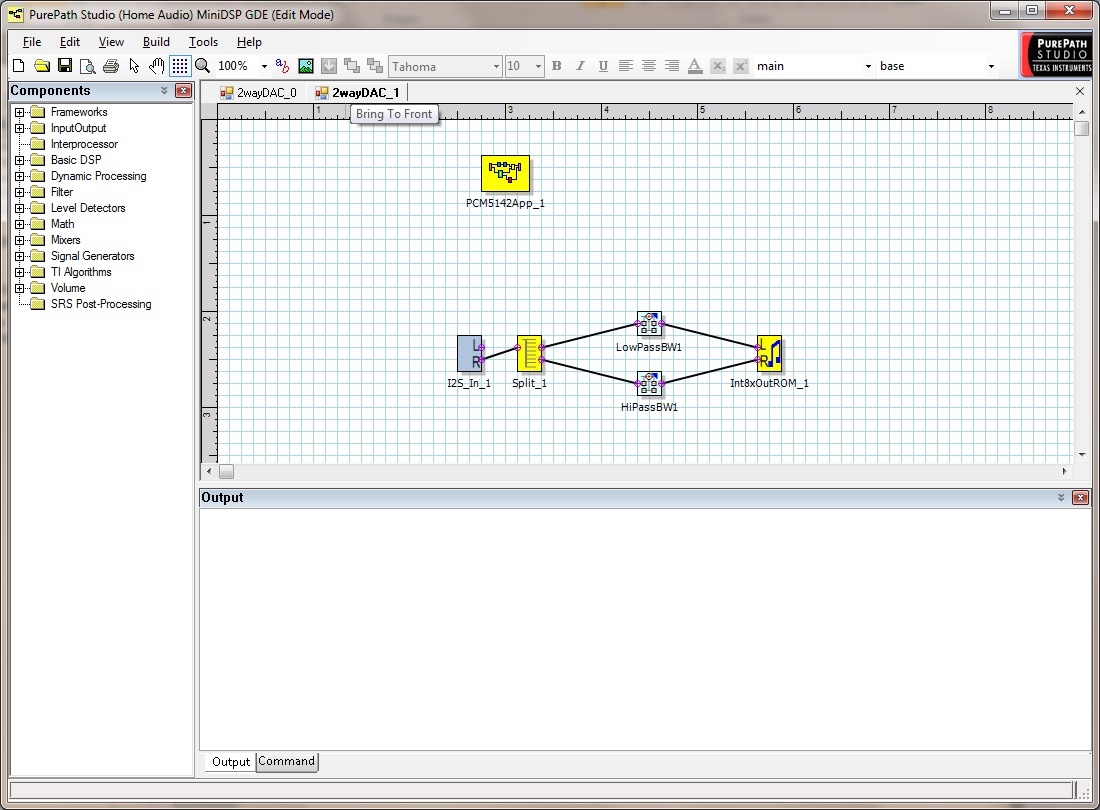

I'll generate FAST / WAW firmware builds for both 1st and 2nd order systems and post them.

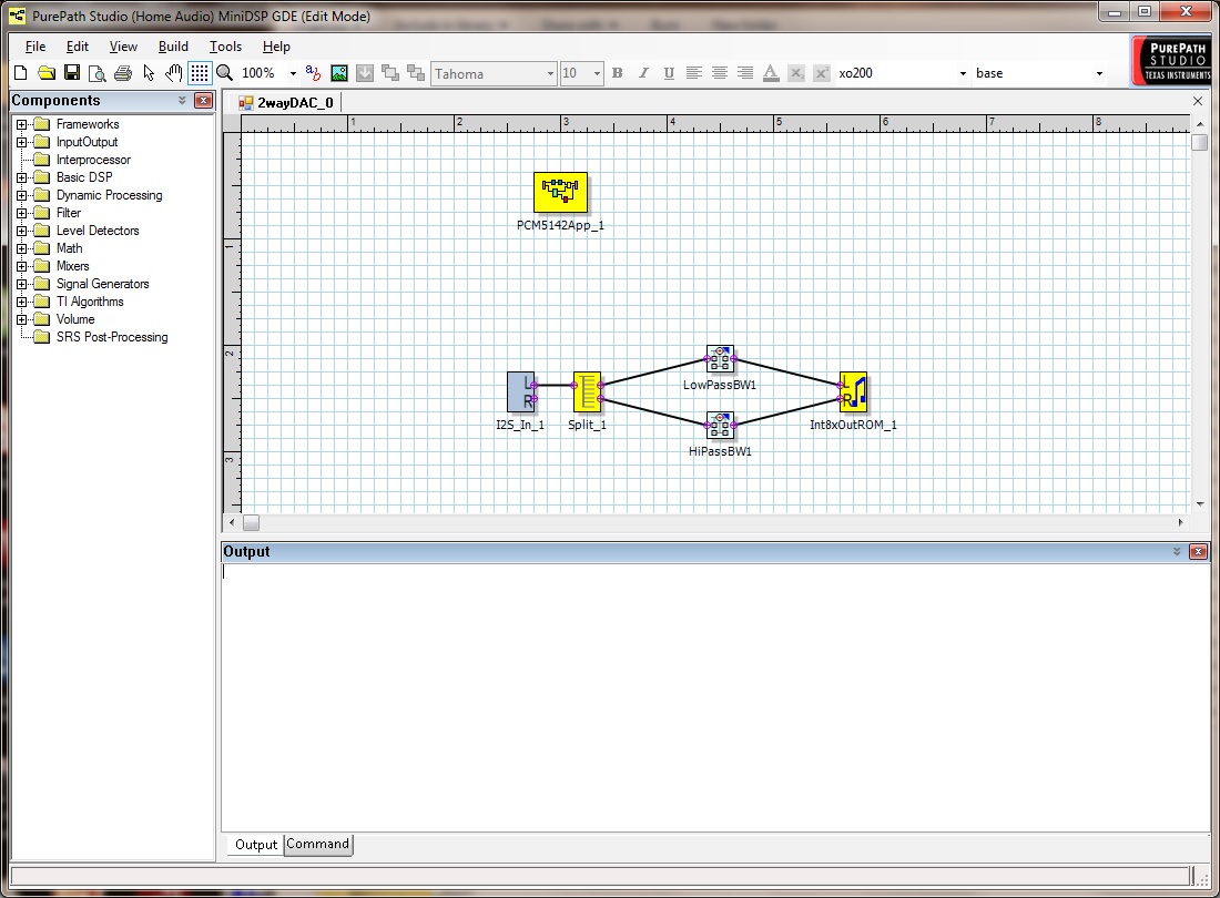

Piano Firmware 2.2-6 - FAST/WAW 2way using BW1
This replacement 2.2 firmware is for implementing FAST or WAW configurations where a woofer and a full range are used together. These XO points are higher than used for a subwoofer [60..200] but lower than used for a tweeter [1000-3000]. So This addition sets the XO at [200-1000] using a modest 1st order Butterworth (BW1).
The mapping between the Volumio menu and actual XO is:
Code:
- to select the XO point using Volumio mode 2.2 settings using this cross ref
		- mode2.2 sel -> XO freq
		- 60 -> 200 Hz
		- 70 -> 250 Hz
		- 80 -> 300 Hz
		- 90 -> 350 Hz
		- 100 -> 400 Hz
		- 110 -> 450 Hz
		- 120 -> 500 Hz
		- 130 -> 550 Hz
		- 140 -> 600 Hz
		- 150 -> 650 Hz
		- 160 -> 700 Hz
		- 170 -> 750 Hz
		- 180 -> 800 Hz
		- 190 -> 900 Hz
		- 200 -> 1000 Hz

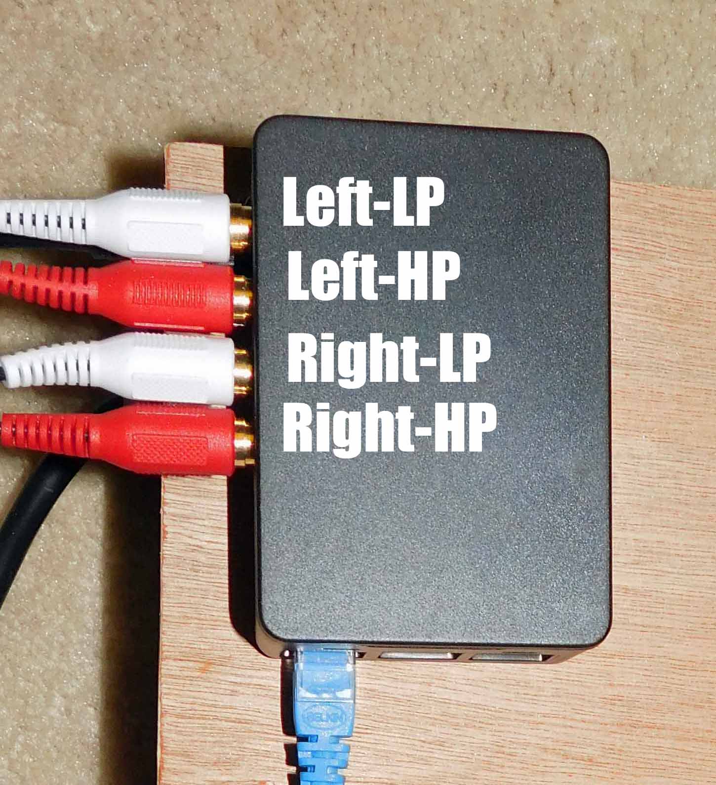

The schematic, readme, projects files and the firmware (2.2-6) are listed below.
