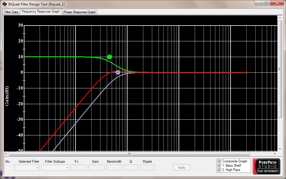

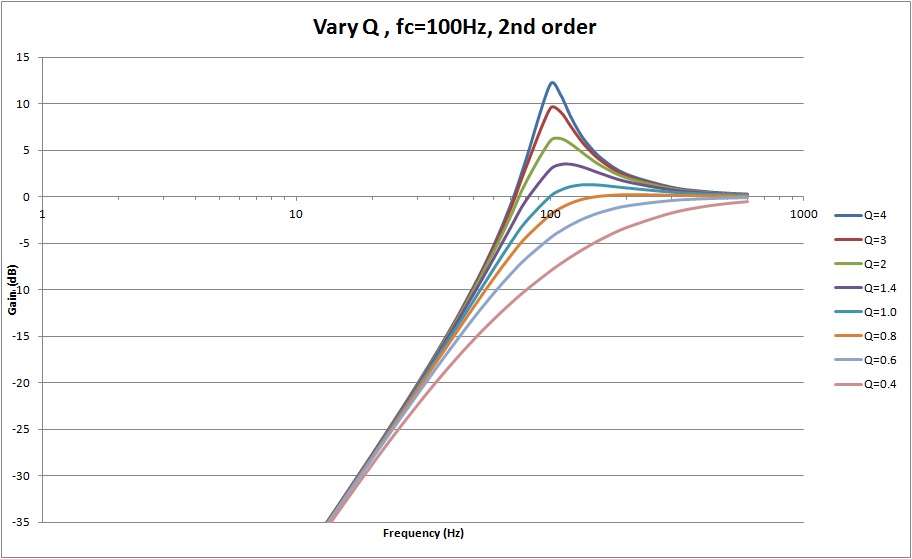

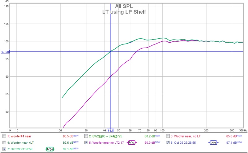

I was looking at the LT ( Active Filters ) and it looks like a LP shelf filter. So I tried a short cut to see if I could use one. The attached note shows some math and the reasoning behind it.
The first graph is a generic 2nd order filter with variable Q and fixed 100Hz cutoff. I compared my woofer's response curve (second graph) to the generic curves and estimated Q=0.8 (rolloff knee shape) and Fc=65Hz (-3db point). I added a 2nd order LP shelf (12dB/octave) and set the shelf's transition to "end" at 65Hz with gain=15dB. In EQ APO the start cutoff is 1 octave back at 30Hz or its center is midway at 45Hz. The result is a shift in the driver response from 65Hz to 45Hz.
The shelf filter can be digitally implemented in many places (RPI, DAC DSP). Only the LADPSA plugin hosted by Ecasound (on RPI) allows a Q adjustment which would be required to fix a peaky/saggy driver response. Alternatively, all these places also allow specifying custom biquad's filter parameters, it just a bit more work.
- EQ APO => "Filter: ON LS 12 dB Fc 30 Hz Gain 15 dB"
- LADSPA => "el:RTlowshelf, 15, 30, 0.8 "
- TI DAC => "BassShelf, Fc=30, G=15"

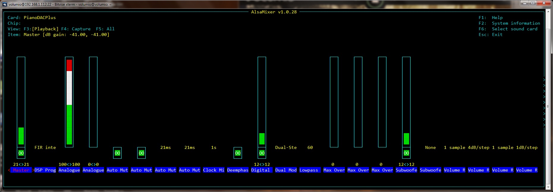

Piano2.1 Audio Controls
There are 2 stereo DACs on the hat and they have some settings that are not directly accessible from Volumio.
I open a terminal window (via SSH) and start "Alsamixer". Press F6 and select the Piano and get access to all the controls (pic below). The master volume controls DAC#0 and the "subwoofer" controls DAC#1. There are also a few interpolation filter presets (qty5) but I can't tell the difference.

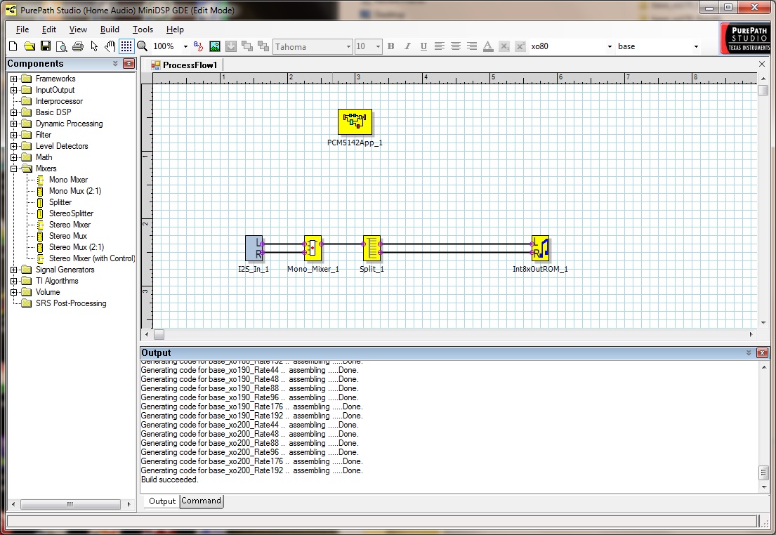

A note on using TI PurePath GDE for Volumio

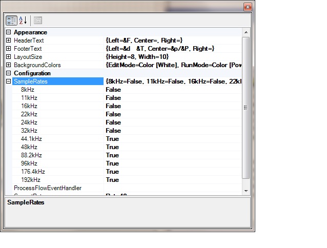

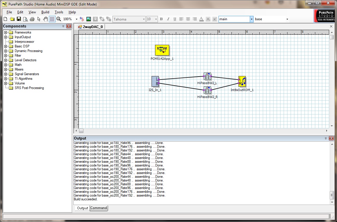

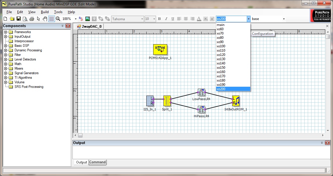

The firmware loaded onto the embedded DSP's is generated with TI's PurePath GDE. Volumio currently expects 15 XO points and 5 sample freq per XO point. That's 90 firmware binary files per DAC and there are 2 DACS, so total 180 files for a complete firmware set. They are expected to be read as XO points labelled as [60,70,80,90,100,110,120,130,140,150,160,170,180,190,200Hz] and sample freq as [44K,48K,88K,96K,176K,192KHz]. That's a lot of files to generate without some shortcuts or help.
In PurePath, there is the option of "configurations" and "overlays", and both allow you to use the same schematic or signal flow and just change the parameters in the filters. I can't locate an explanation for the differences but I only get reliable results from using "configurations" as shown in pic#1 pulldown menu. You can also select all the supported sample freq per configuration via the view properties shown in pic#2. When you select "build", all 90 "cfg" files will be generated. The attached PurePath project zip file is for DAC#0 used for the left speaker in a 2way active crossover used at post Raspberry Pi with Piano2.1 DAC DSP and Volumio2

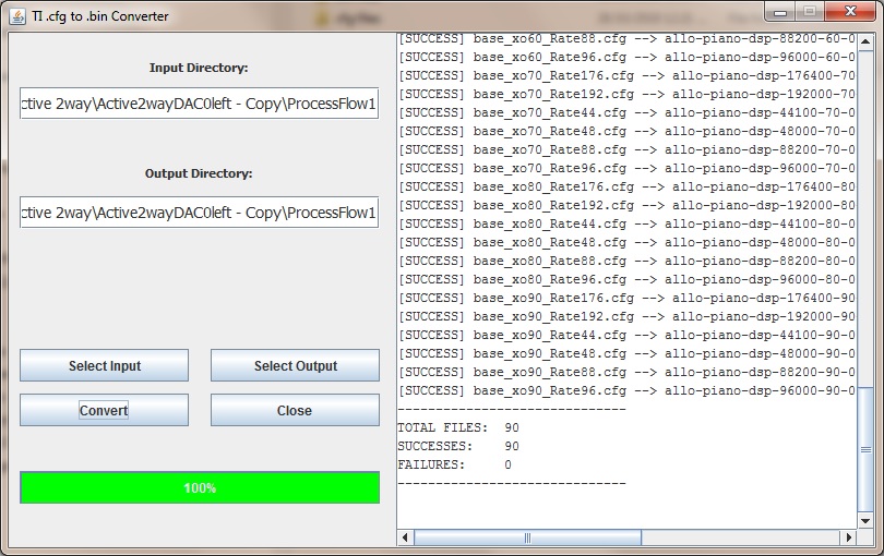

The TI naming convention and format are not directly usable by Volumio. They need to be renamed and converted to bin files. My son was kind enough to write a java script (zip attached) to perform this operation on a entire directory of files. The conversion renames the files from something TI auto generates like "base_xo60_Rate48.cfg" to "allo-piano-dsp-48000-60-0.bin" and processes the file to make a suitable firmware bin. Files ending in "-0" are for DAC#0 but you can rename them to end in "-1" for DAC#1. The entire directory of bin files can replace the stock Volumio ones. The file naming convention is fixed to allow selection via Volumio's menus, you'll need to keep track of the actual mapping of what you really put in those firmware files.
DAC firmware : sub and a sealed woofer
I have another project with an active 3way and I was trying to integrate a sub. The woofer is in a sealed chamber so it rolls off 2nd order at -12db/oct @fc=70hz. Since the 3way has LR4 xo's I wanted everything to have LR4 Modular active 3 way - work in progress.
I made another firmware build that replaces the Volumio 2.2 DAC firmware directory (/lib/firmware/allo/piano/2.2). Since LR4=BW2*BW2 I added a BW2 to the LR outputs to form a HP LR4 on the woofer, and the XO is selectable via Volumio. The BW2 HP on the LR channels reduces LF woofer movement and appears to make the woofer sound cleaner during LF periods.
I also added an LR4 to the sub outputs that have are selectable XO. The left sub output has just LP LR4, while the right sub output has HP LR4@16Hz and LP LR4 selectable. The sub HP is for one of my subs without a HP to prevent exceeding Xmax. So the sub and woofer can cross at a common XO using LR4 slopes.
The TI PurePath schematics, project files, and firmware are below.

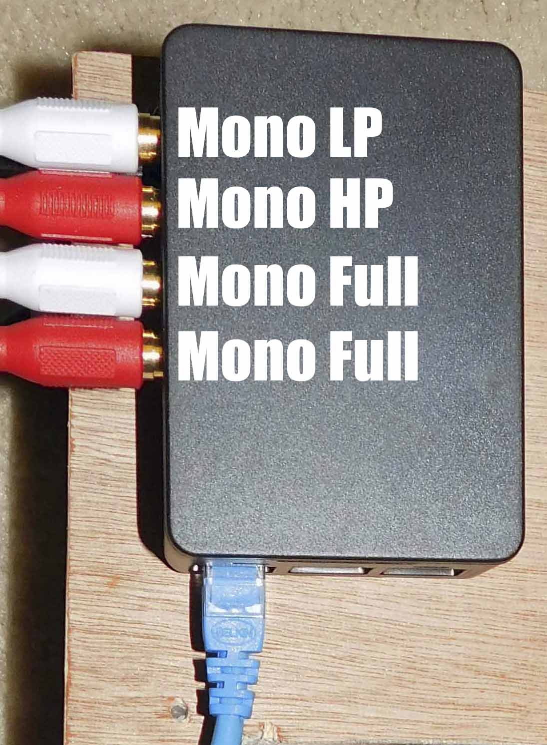

hi
First I want to thank donVK I just make my first test today 2.2 active x over
it run quite nice but to compare I wonder if you could make one side
mono signal configuration on RCA1 Left LP RCA2 Left HP and RCA 3 mono full range
I want to compare in blind test the difference between mono bi amp on one side and classic passive x over ( and phase correction with 3cm path delay)

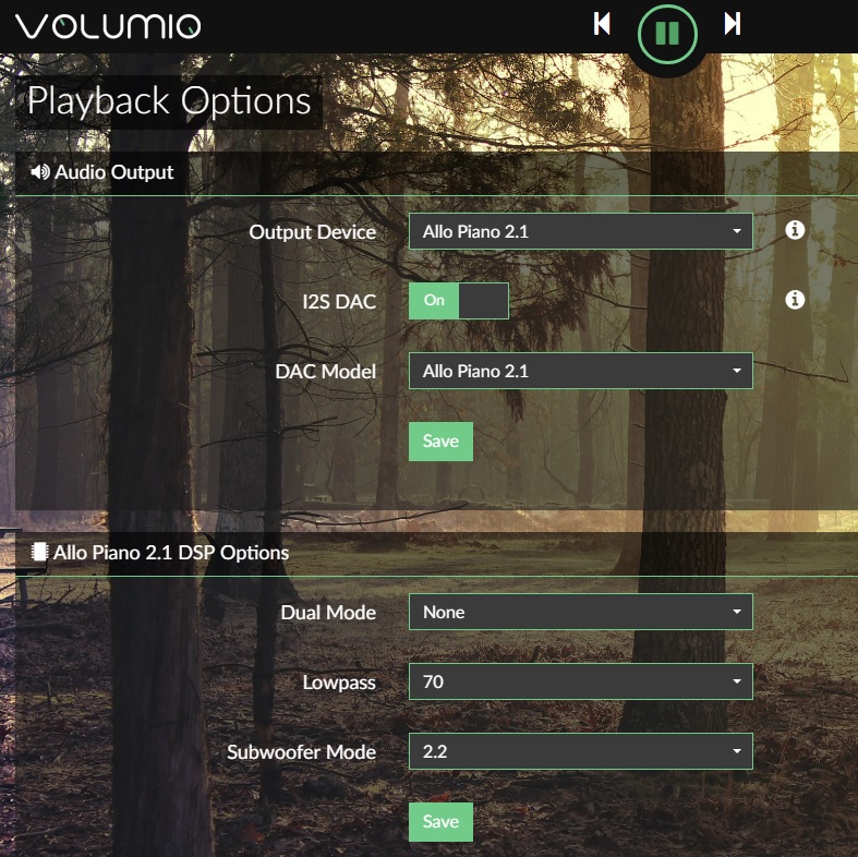

Getting the fronts and sub to integrate properly is dependant on the type of fronts (sealed, BR) and subs (sealed, BR, BP6, etc) as the acoustic slopes are different. Many commercial subs also have an Fc adjust that may interfere if its set too low.
Volumio has 2.0, 2.1, 2.2 modes and the firmware in those directories (lib/firmware/allo/piano/x.x) is loaded. I have received sample projects from Allo and it appears to be:
Mode 2.0, DAC#0, DAC#1 : no DSP firmware is loaded.
Mode 2.1, DAC#0 has no DSP firmware, DAC#1 has LP LR4 firmware
Mode 2.2, DAC#0 has HP LR4 firmware, DAC#1 has LP LR4 firmware

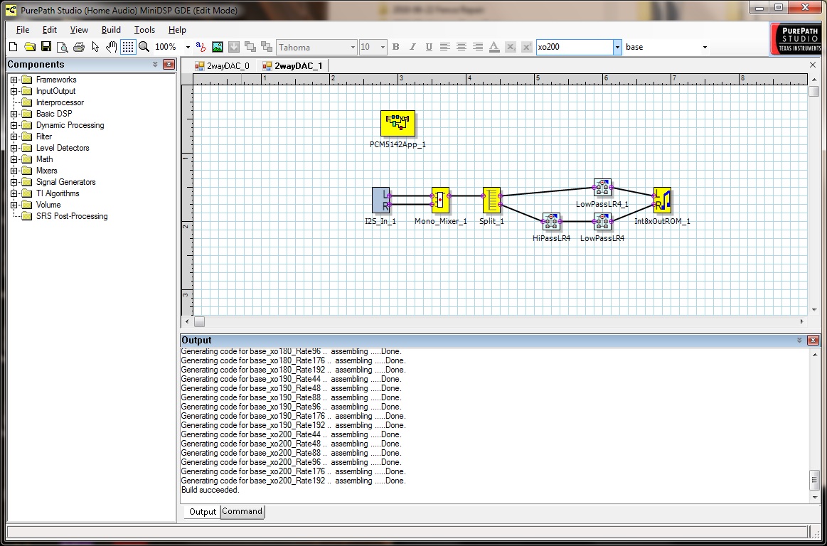

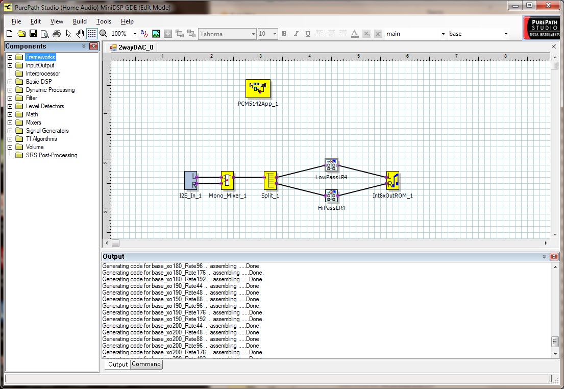

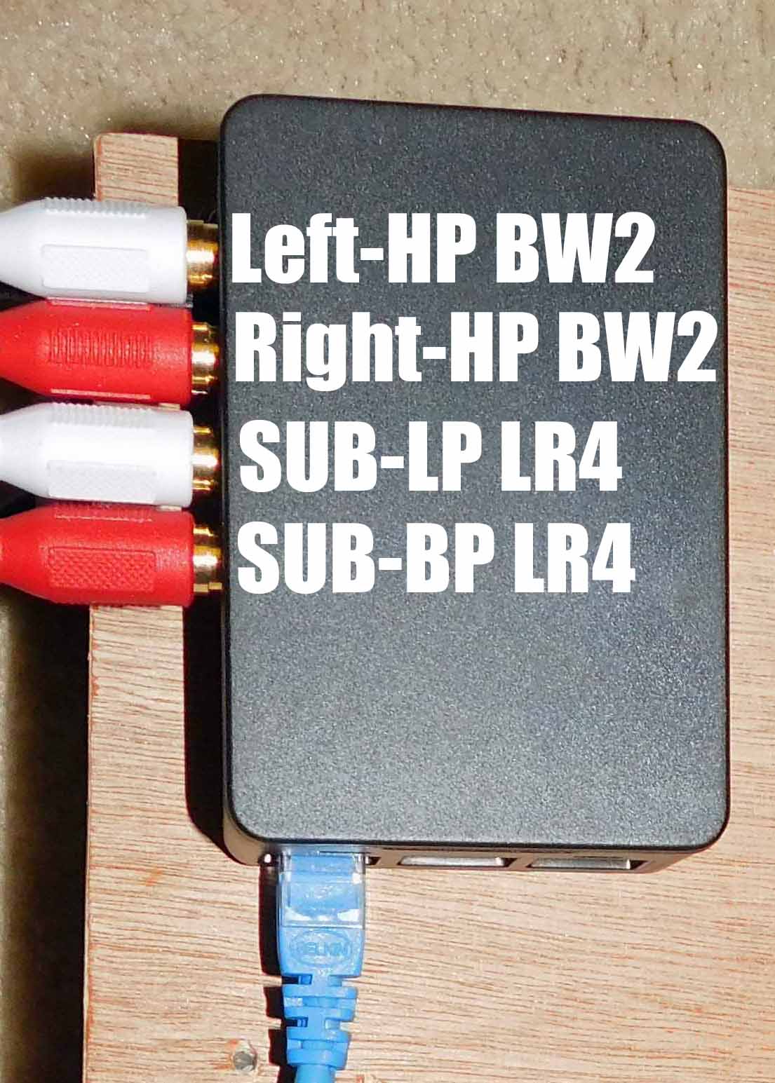

Test firmware : mono active 2way vs mono passive
@runni : try this firmware for your comparisons. Pinouts shown in the diagram.
The XO mapping and cautions are the same as before at post *76 Raspberry Pi with Piano2.1 DAC DSP and Volumio2 . You'll replace the 2.2 firmware directory and select mode 2.2 from Volumio.
I do not have a purepath license and want to ensure my speakers their full range is used instead of HP filter. In Allo their purepath documentation (see attachment) they show that the sub L/R are mixed to mono then filtered using 2 biquad filters while the speaker L/R are only filtered using 2 biquad filters on each channel. I only want the sub to be filtered. Not sure what the difference is beteen the LP/HP and biquad (and why they use 2 in serial) 😀
^ I would use the Allo docs as just an example. In the diagram a single biquad instance can implement a 2nd order function. In TI PurePath you can create a block with many biquads and label it whatever you want. I relabeled the block with the function that it is "LP LR4"
It seems you want mode 2.1 as shown post #96 above. This means you need to load DSP firmware on DAC#1 only.
How do you determine what firmware is loaded on each DAC in your setup?
Ah of course. I just read the documentation and the -0 and -1 at the end of the firmware name are for sub and speaker. So I can just remove all speaker firmware then 😀. Thanks.
