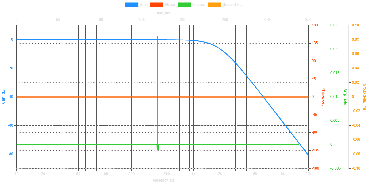

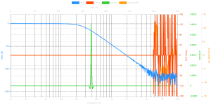

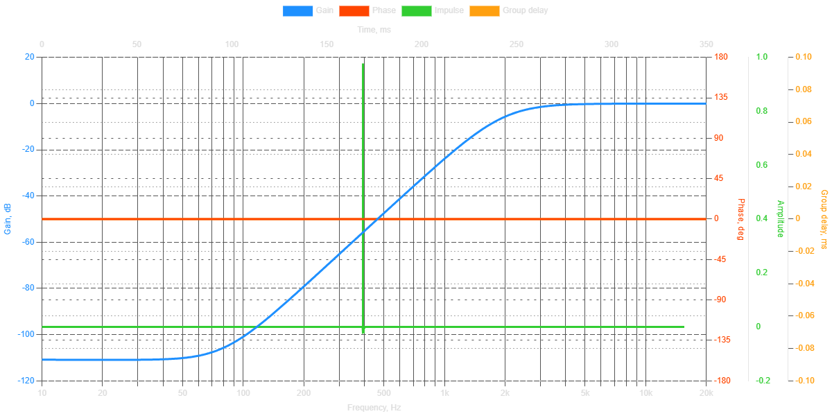

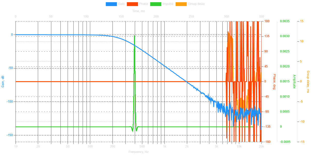

Problem: rePhase FIR filters don't have the expected crossover point when loaded into CamillaDSP.
Using free program rePhase tab 'Linear-Phase Filters' I have created FIR filters for
High Pass 2khz Linkwitz-Riley 24dB/octave
Low Pass 2khz Linkwitz-Riley 24dB/octave
Low Pass 300hz Linkwitz-Riley 24dB/octave
On every filter I use 65000 taps, format=24 bits LPCM mono (.wav) with all other options as the default.
(FFT length = 131072 samples, centering = middle/use closest perfect impulse, windowing = hann, optimization = none to -100 dB, rate = 44100hz.)
These filters are all copied to the RPi5 folder ~/camilladsp/coeffs and loaded into CamillaDSP as new (+) filters of type= Conv subtype = Wav. I use these FIR filters to substitute for the corresponding IIR (biquad) filters which are 4th order Linkwitz-Riley in CamillaDSP running on the RPi5. With the same crossover points and slopes, any differences between the FIR and the IIR filters should be related to phase, provided the FIR filters are constructed properly.
The filter gain curve plots correctly in the rePhase window with 6dB down at the Crossover Frequency. However CamillaDSP tab Filters >plot shows the Crossover Frequency for a 2khz Low Pass filter as 6dB down at 9khz instead. The same thing (ratio of about 9/2) happens on the 2khz High Pass and also the 300hz low pass filter. And even my old ears can definitely tell that the FIR filter was basically muting the tweeter, and forcing the mid and woofers to play way too high hz.
I have now generated the rePhase FIR filters with Crossover points at a multiplier of 2/9 so that instead of the crossover point at 2000hz, I used 450hz. And for the crossover point of 300hz I used 60hz. Now the filters plot correctly in CamillaDSP and my ears are feeling much better! The FIR and the IIR filters are sounding much more similar Critical listening will be needed to compare them. See .png format CamillaDSP plots attached. CPU with FIR is averaging 14%, with IIR (biquads) was averaging 1.9%.
In any event I suspect the 9/2 ratio in the expected vs actual FIR crossover points has something to do with the rePhase parameter selections.
One additional note I realized. My initial listening test with the "original" FIR filters was directly on-axis at my usual listening position about 9ft away from the speakers. Working on my PC I'm near field (3ft away) and 45deg off axis from the right speaker. With the FIR filters applied, the tweeter was essentially muted below about 7500hz, my 8in woofers driving up to 9khz beaming like crazy and on-axis I was still hearing the highs on-axis. But off-axis all the highs vanished with the (uncompensated) FIR filters. The IIR filter was giving normal off-axis performance from the tweeter (2khz high pass) and keeping the 8in woofer where it belonged 2khz low-pass. (my speakers are Klipsch KSF-10.5 with horn tweeter and dual 8in woofers sharing the space space).
Compensating the FIR crossover points restored the speaker performance and the off-axis performance is back to "normal".
When listening to your speakers in an A/B comparison, I suggest on-axis and off-axis listening. Off-axis can reveal major problems you might not notice on-axis.
Found mistake in the FIR filter and corrected.
I have CamillaDSP capture rate set at 192khz.
The rePhase FIR filter must use the same rate.
I originally had the FIR filter rate at 44100.
Setting the rePhase Linear-Phase Filter rate = 192000 hz has solved the issue.

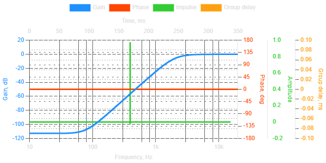

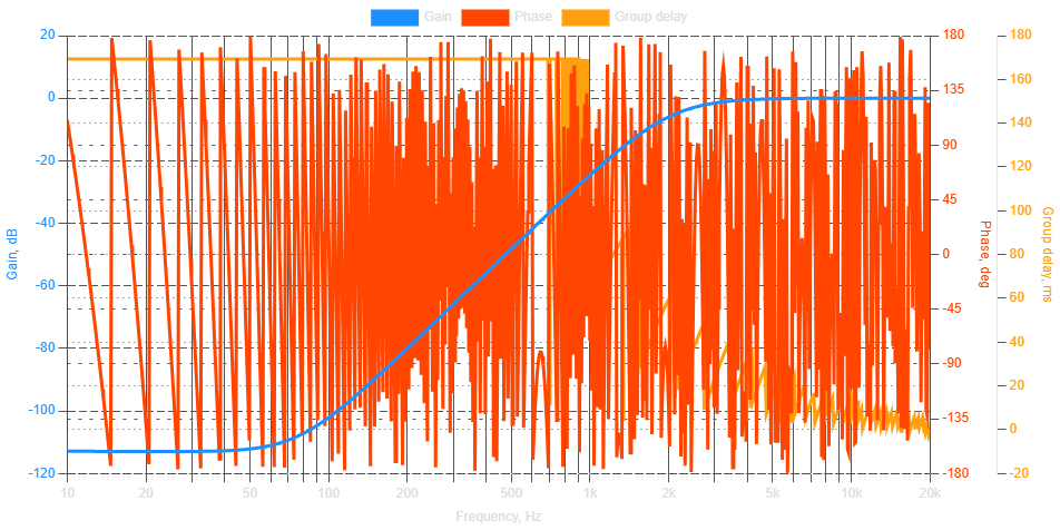

CamillaDSP response plot question.
I have CamillaDSP 2.0.3
pyCamilla2.0.2
Backend 2.1.0
In the Camilla GUI Filters tab, I plot my FIR High Pass 2K filter (RePhase linear-phase High Pass Linkwitz-Riley 24dB slope 2khz) and it appears as expected. No phase shift and no group delay.
But in the Pipeline tab when I "Plot Response of this Step" it shows the gain curve correctly, but phase and group delay are a mess.
Is this just a bug in the filter response plot?
pyCamilla2.0.2
Backend 2.1.0
The graph simply takes into account the constant delay time of the FIR filter. The longer the FIR filter, the more delay it introduces into the signal.Is this just a bug in the filter response plot?

Updated to CamillaDSP 3.0.1
Updated to the CamillaGUI-backend to 3.0.3
pyCamillaDSP is at ver 3.0.0
This is running on a Raspberry Pi 5 with the latest updates.

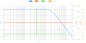

There appears to be a bug in the CamillaGUI where in the Pipeline tab, when adding a Filter, an error message pops up with "channel unexpected." Apparently this bug has been an issue in the past as there is some existing message traffic on the diyAudio forum.
It is possible to directly edit the .yml file using a text editor such as nano. This is necessary by CamillaGUI forces you to select a channel when adding a Filter to the Pipeline. You cannot "unselect" a channel so that they are all blank. Below is my .yml file which also includes biquad filters which I have not applied in the pipeline.
When you generate a .yml file from "New Blank Config" in the Files tab, add your filters, your mixer, and add your Pipeline filters. CamillaGUI will show errors because it will add lines to the Filters section with channel: <number> which you will need to replace with null, as well as in the Pipeline section it will improperly format the filter channels. With my FIR Filters the line channel: null remains, but for biquad filters the line is deleted entirely. You may notice in the Mixer section i have dest: 6 and dest: 7 as muted: true because these are either Center or LFE (on my 7.1 surround AV Receiver) and would otherwise bleed into channels 0-5. The first filter in the Pipeline section I have in bold. This is the proper format needed to be edited manually from the buggy script which the CamillaGUI will generate. The other filters in the pipeline need to be the same format. With the .yml reformatted and saved you will see in the CamillaGUI Pipeline tab the filter being unassigned to any of the channels. The channel assignment for the filter in the pipeline will be active on the filters listed in the .yml file.
File Contents below

After all of this debugging the CamillaDSP logfile is still reporting error when playing streaming audio with mplayer, or when playing music from USB drive with VLCplayer.
Capture device is stalled: processing is stalled
PB: Prepare playback after buffer underrun.
And this is associated with intermittent drop-outs on the audio.
More debugging required, but at least I got the filters straightened out.
