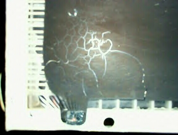

I have taken the socks off and vacuum the panels front and back. It helps a bit, but the popping still there. You can see the acring when all the lights off. It happens to the top right and left panels, but not the middle one.
I cleaned the panel a little bit without having them in the bath tub.
I could not see any lose wires at the time, however I'll double check again later.
I think the panel may need the heat gun fix, but don't want to burn a hole onto it since I do not have even one spare panel.
I just don't know what temperature the film can sustain? Can other member provide some help here?

Acoustat only put the GUN too there panels.......BEfore the Coating was on!
You Can See it the pic here.....
The other Pic is a panel that DOSE NOT WORK anymore....From the HeatGun treatment.....It look Find from the out side of the Panel when your Doin it...
An if you are LUCKy...it may still work.....but let this be the Last thing you do...i have had a lest 16 panels in 35 years... not [one had to have the gun put to them].....But some could have been guned to get the mylar good an tute....Just a littel reakel in the mylare in the corners well not case any prob....but thay all work fine after washing....So get two are more extra panels an have at it....gun it up...hehe
an i never had any wires come lose....Good luck

Where on the cells are you seeing the arcing??

1. Arcing on the top ring and left panels only on both speakers;
2. Between the loose wires and the conductive coating.
Ordered the glue from UK and it may take two weeks to come.
In the meantime, I use the sewing thread to tie them back as temp fix. It seems to stop the acring for the time being.

This is what I found so far;
1. Acring is taking place in all areas, the top ringt and left panels are the most effected;
2. the top and bottom middle panels are the least effected. In fact, it only happened once on one speaker;
3. Acring is not limited to the loose wires area only, it happens to some other areas as well;
4. You can see some acring at night, small pops you can not see;
5. Vacuumed panels a few times, it helped the first time and no great improvements after that;
6. If you leave the panels on charge, they intend to have less arcing occurance after a few hours;
7. I have not washed the panels as yet, I am not sure if this will fix the issues completely;
8. I communicated with the original owner during the weekend. He told me he never had issues as such during his ownership of the speakers;
10. When the speakers play music at a realistic level, you don't really notice the popping noise. It only becomes noticeable when you play the music at very low level at night;
11. I am not sure what to do next since loose wires are not the only cause of this acring between the mylar film and the wires. I'll fix the wires regardless when the glue arrives;
