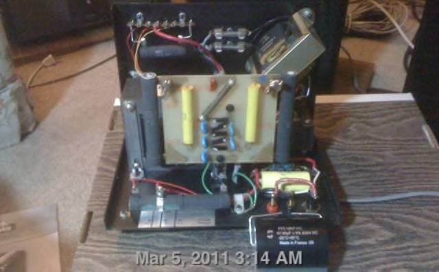

Yes, the caps are a primary upgrade, along with the "C Mod" if it isn't present already. If your trannies have Monster Cable wiring you'll want to replace them, since they corrode, although I think that was probably not still in production when the Model 6 & 8 were released. Other possibilities are replacing the caps & diodes in the voltage multiplier; measuring the preferred setting of the high frequency control rheostat and then replacing it with a fixed resistor; replacing the resistors; new binding posts. Some people bypass the fuses. The electronics are quite old & can benefit from modern components, which can breathe new life & longevity into the speakers. I did many of these mods on my transformer driven 2+2 with excellent results, and plan to do major upgrades to the Acoustat Servo amps I'm now using, as budget permits.
I have no doubt they will sound beautiful as-is, but they can be improved without too much headache or cost. This IS diyAudio, after all.

PS. you must replace the "crossover" caps for 100% polypropylene. And as mentioned check the B+ for the full 5kv... or else shotgun replace the diode multiplier string, and the ceramic caps (go for 10kv caps)

Congratulations on your purchase of the Model 6's. The potential for upgrades will depend on the particluar vintage of the speaker, as well as what mods may have been done after original manufacture.
Do keep in mind that each speaker has two interface units, and therefore you'll need a total of four channels of identical amplification. It is NOT recommended to parallel two interfaces on one amplfier channel.

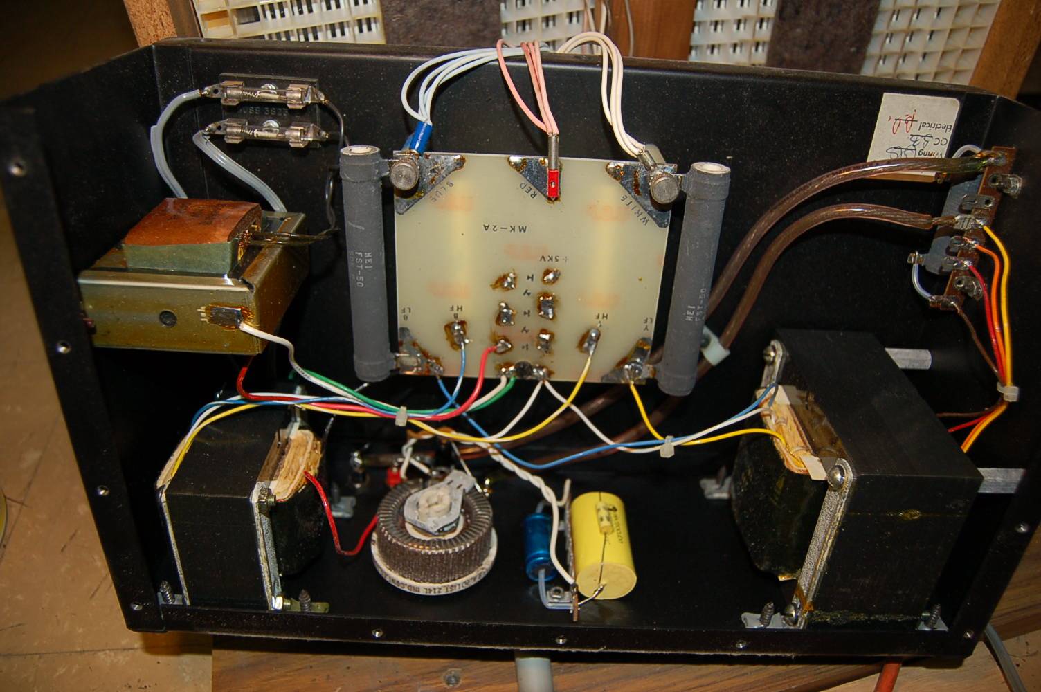

I openned up all 4 transformers and they look the same as the image posted by the other member.
I did vacuuming on one side only and planned to do the other side this evening.

I'll post some images here tonight so that we can have a discussion.
