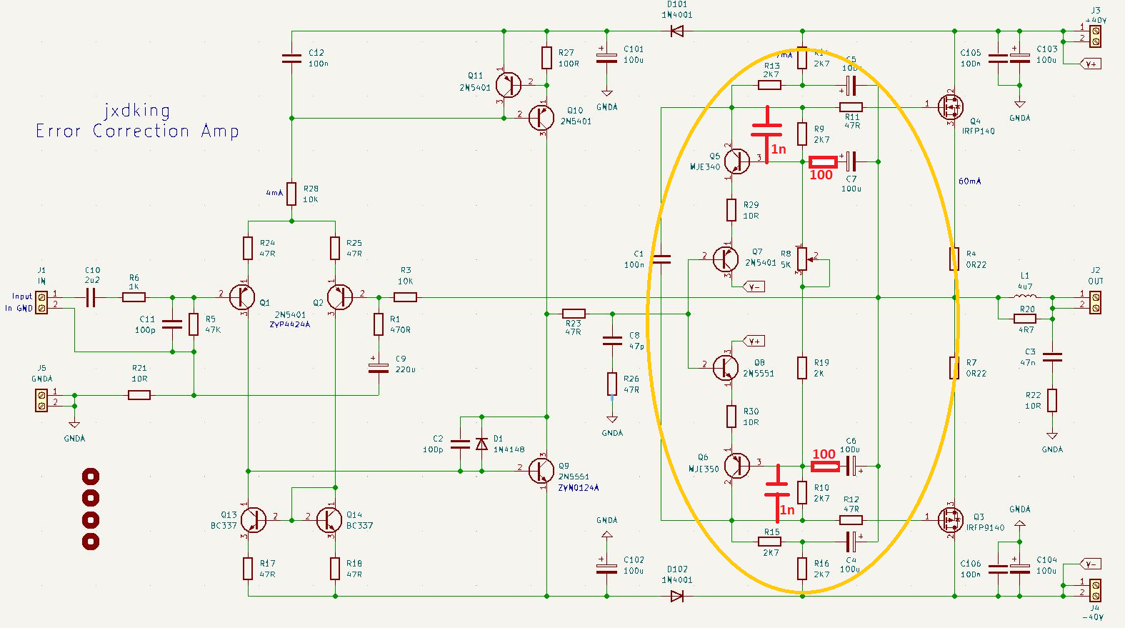

J jxdking Member Joined 2009 Today at 2:21 AM #41 Today at 2:21 AM #41 gregt said: Cordell uses Zobel's on Gates of output MOSFET (47p and 47ohm.) Would that help? Click to expand... MOSFET has hundreds pf input capacitance already. I tried with 100pf. It does nothing.
