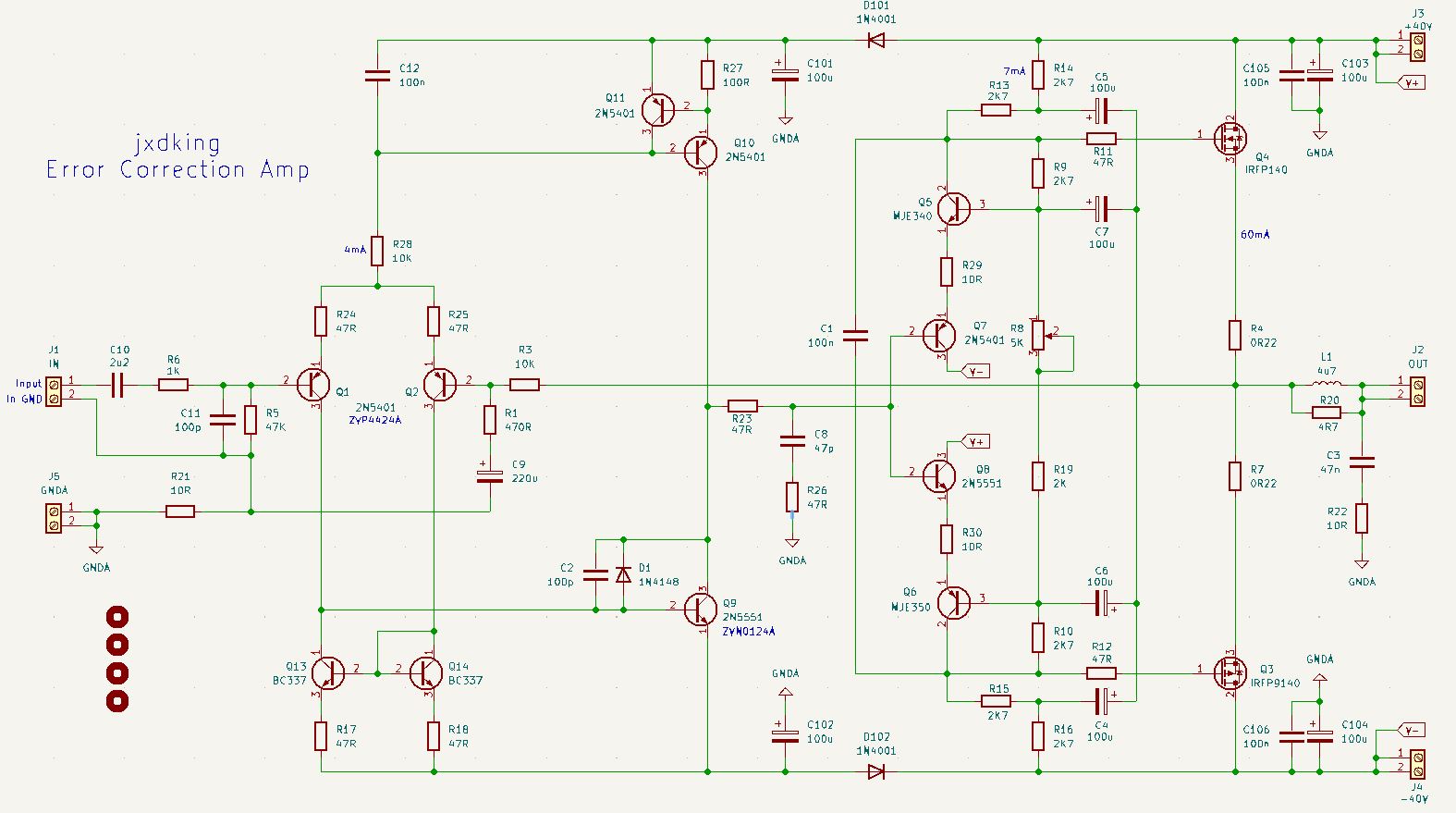

The additional filtering was to isolate the input stage from big current bursts in the OPS.
But I'm no expert! 😎
It is a good buffer.

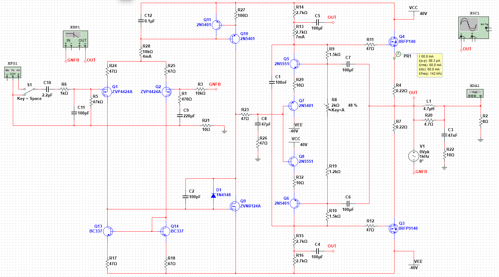

I tested with a good opamp as input and I let the output be 10Vp.
At 1kHz THD was 0.0003% ... that is -110dB.

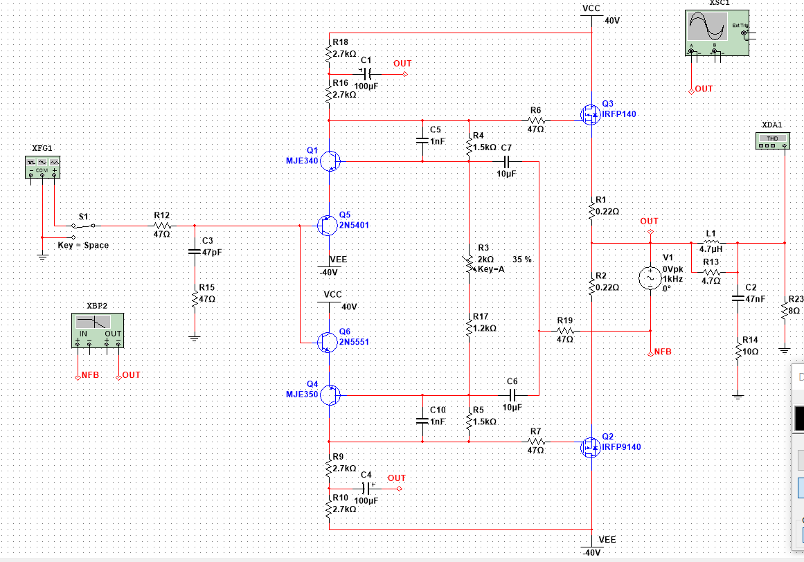

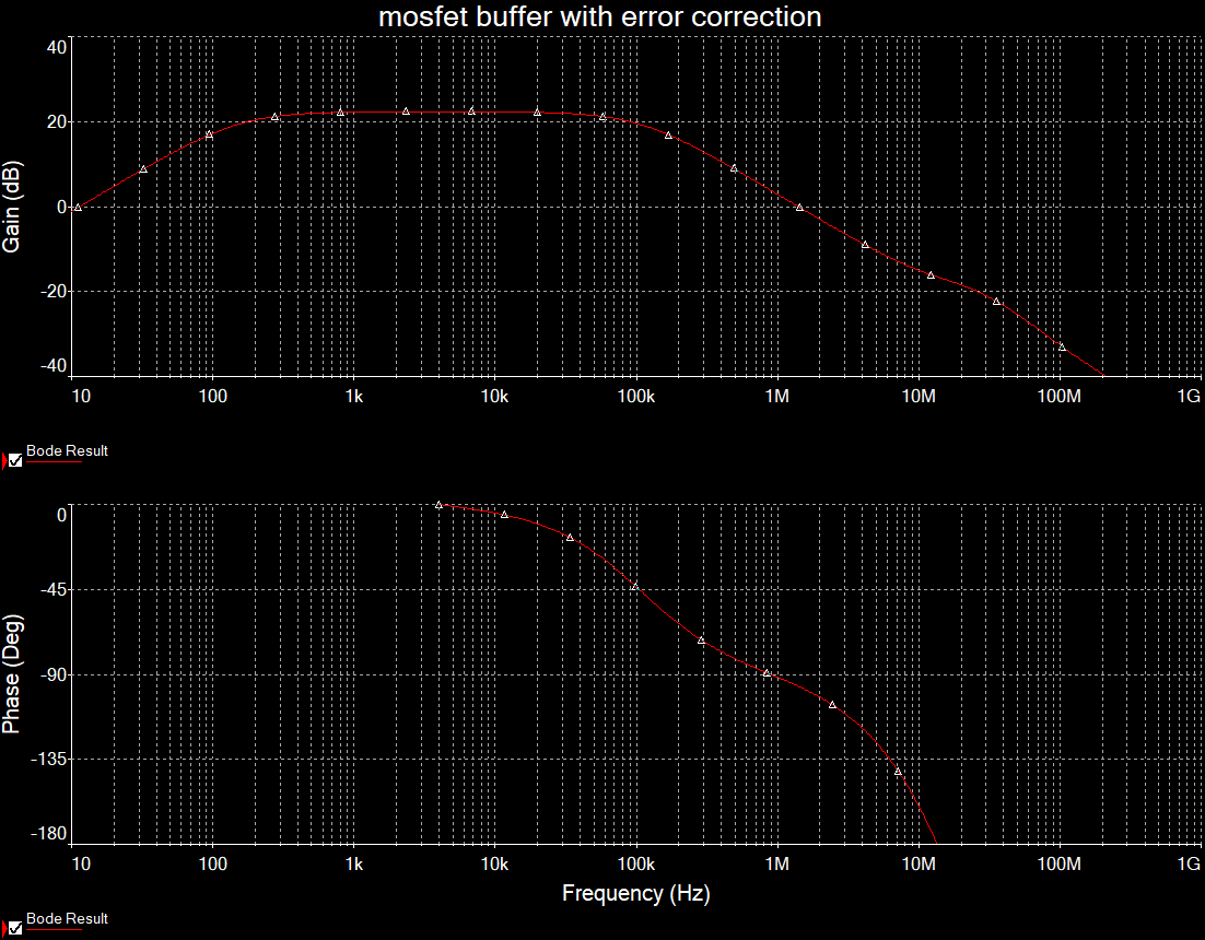

Optimized the resistors' value around the bias network.
Added degenerative resistors R29, R32 to Q5, Q6. This solves the transient current spikes. It also limits the current of Q7 and Q8.

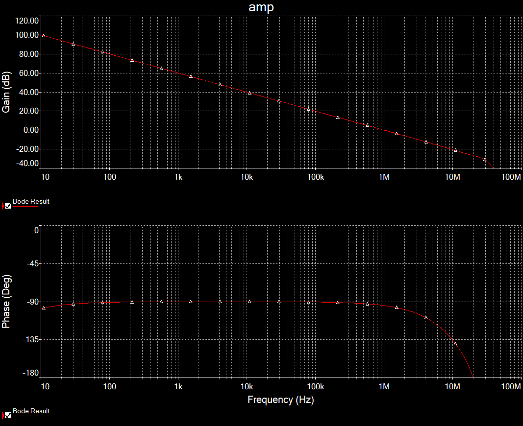

Bode plot
Bode plot

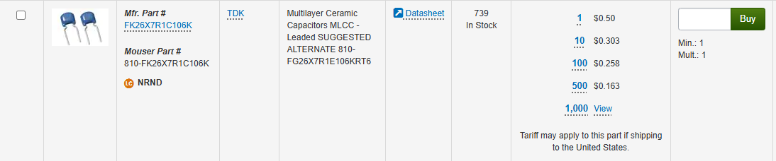

I bought some 10uF ceramic caps before, primary for audio input coupling.C311/C312... 10uF ceramic caps? Sounds expensive!
I realize the voltage here is pretty low. They are perfect here.
The price before tariffs. The 16V version.
The 50V version is about double the price. The 16V version is enough here.
Do you expect more changes to you design? I am eager to make gerbers...I bought some 10uF ceramic caps before, primary for audio input coupling.

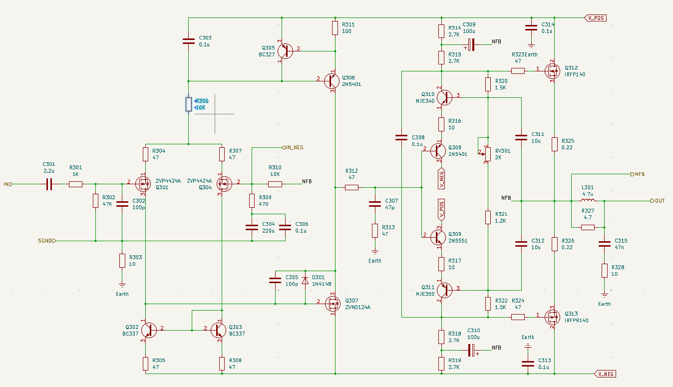

I think that's it.Do you expect more changes to you design? I am eager to make gerbers...
I will put my PCB order this weekend.
