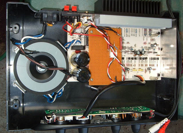

FWIW, this is a picture of what I did:
http://www.polkaudio.com/forums/attachment.php?attachmentid=24838&d=1179091849

Great offer by Stuart (a Brit living in Santa Cruz?)
Accurian Amplifier
All Resistors are gold = 5%
All Resistors are 1/8W unless otherwise stated
Remember to rotate the transformer until the hum goes away. .
mine was low to begin with; after mods, I put it back in a rotated
position. . .noise. . .slow rotated until all hum went away. . . about
three inches from speaker. . .
Main Audio Board
R18 (Y,V,R,Gl) 4/7k 1/8W LED Power Supply
R100,200 (Gr,Br,Br,Gl) 510 1/8W Input
R101,201 (Br,Bl,O,Gl) 10k 1/8W Input

My Mods:
Reroute the input through right side and directly soldered to preamp
board. I like the RCA cables directly connected to my amp. . .I hate
looking for cables. . . one less connection also. . . routed as far away
from the AC.
Brown board over power supply:
Old RCA outputs are still outputs, but now preamp outputs. Amp
is a little noisy for preamp, but nice to have that reduced level. . .
I hooked it up to my little powered sub. . .worked great and was
right level (330ohm/47ohm).
Bypassed the power switch. . . plugged in = ON.
Removed power switch.
Rotated transformer until hum was very minimal.
Routed secondary wires under mount (Blue and White wires)
Near front of transformer.
Need to wire nut the primary AC (Blue /White to brown/black).
