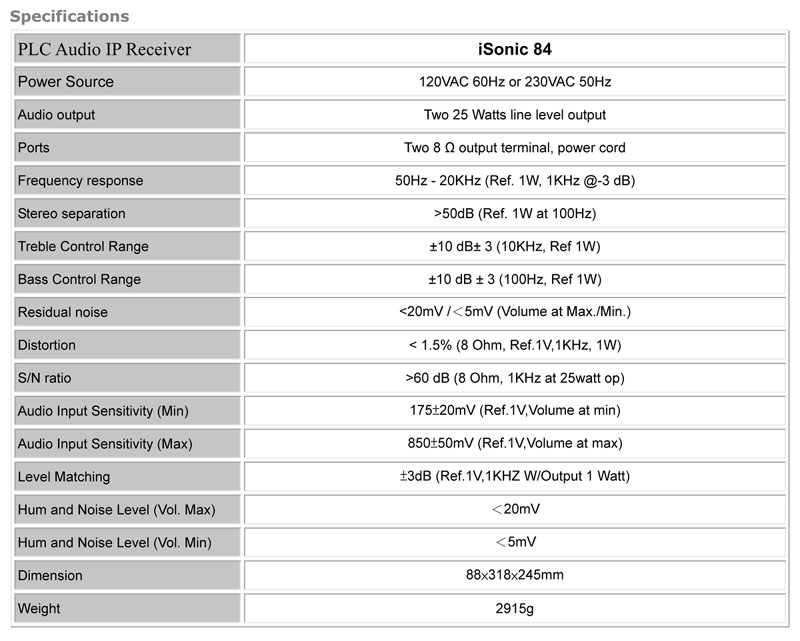

iSonic 84 aka Accurian PowerLine Digital Audio Receiver/Amplifier
Radio Shack # 15-1937
It states sensitivity of 175mV and 850mV, giving it a gain of 38.1dB and 24.4dB (14.14V/8ohms - 25 watts/1.77A).
+-10dB at 100Hz and 10kHz
Noise 5mV to 20mV
