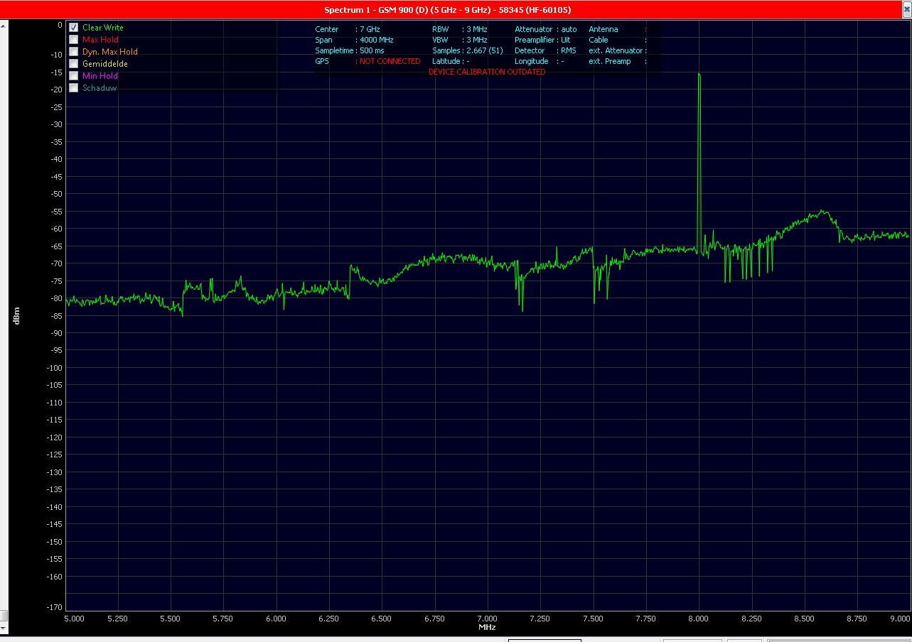

The picture you showed has several scattered pulses over several GHz of spectrum. This is not characteristic of most communications systems except for possibly some covert military spread spectrum system. It could be some sort of purpose built jammer, but what was it's intended target? Frequencies this high are not that easy to generate, especially over that much bandwidth.
That meter most likely is a sampled system. It sweeps a receiver over the intended frequency range and measures a power level at it's internal intermediate frequency (IF). If a high powered pulse at a lower frequency, or near the IF frequency hits that meter hard enough it will generate the random scattered pulses you show. Do repeated readings produce the same pattern, or a different random pattern? If so you may be looking in the wrong frequency range, especially if the meter has a plastic case with minimal internal shielding over the RF circuitry.
Do you see or hear coincident pulses in radio or TV reception? Is any electronic equipment in your house being interfered with?

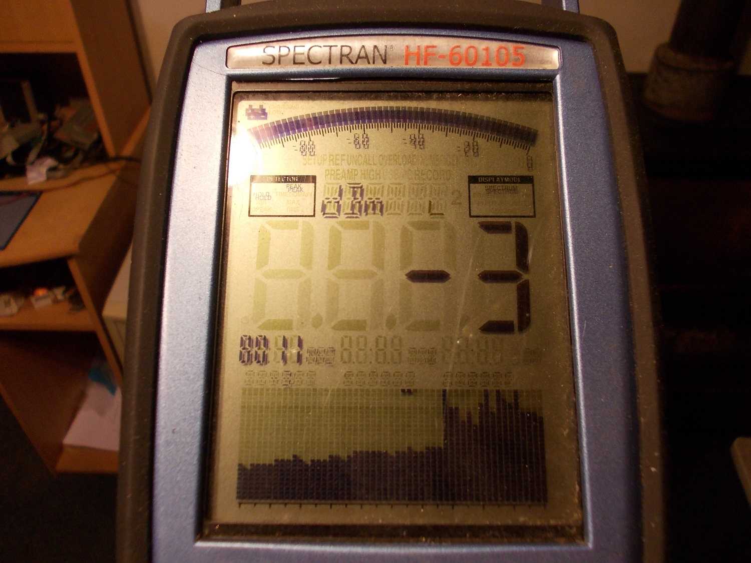

yes meter is sampled, but it is a professional equipment, costs almost 4000 dollar but here it is 1900 euros.
I have contact with the manufacturer and she did say the adjustment needs to set right, like bandwidth and smaple frequency.
Set al power of and measure do not help, a nabure did say in past he has a jammer so he has better wifi, a word from somewhone who do not now a lot about rf, just supid afcouse.
I have measure the signal only on front where I watch tv, tv is not cause, and the signal strength is max +3dB who is not that much that things do disturb, a real strong militairy radar do well disturb equipment, but is quite much stronger.
here some measurement in the home, walk around.

old ones on pictures, measure 8 to max meter 9.4 Ghz. then pulses are more clear, and a pc measurement also with usb cable.

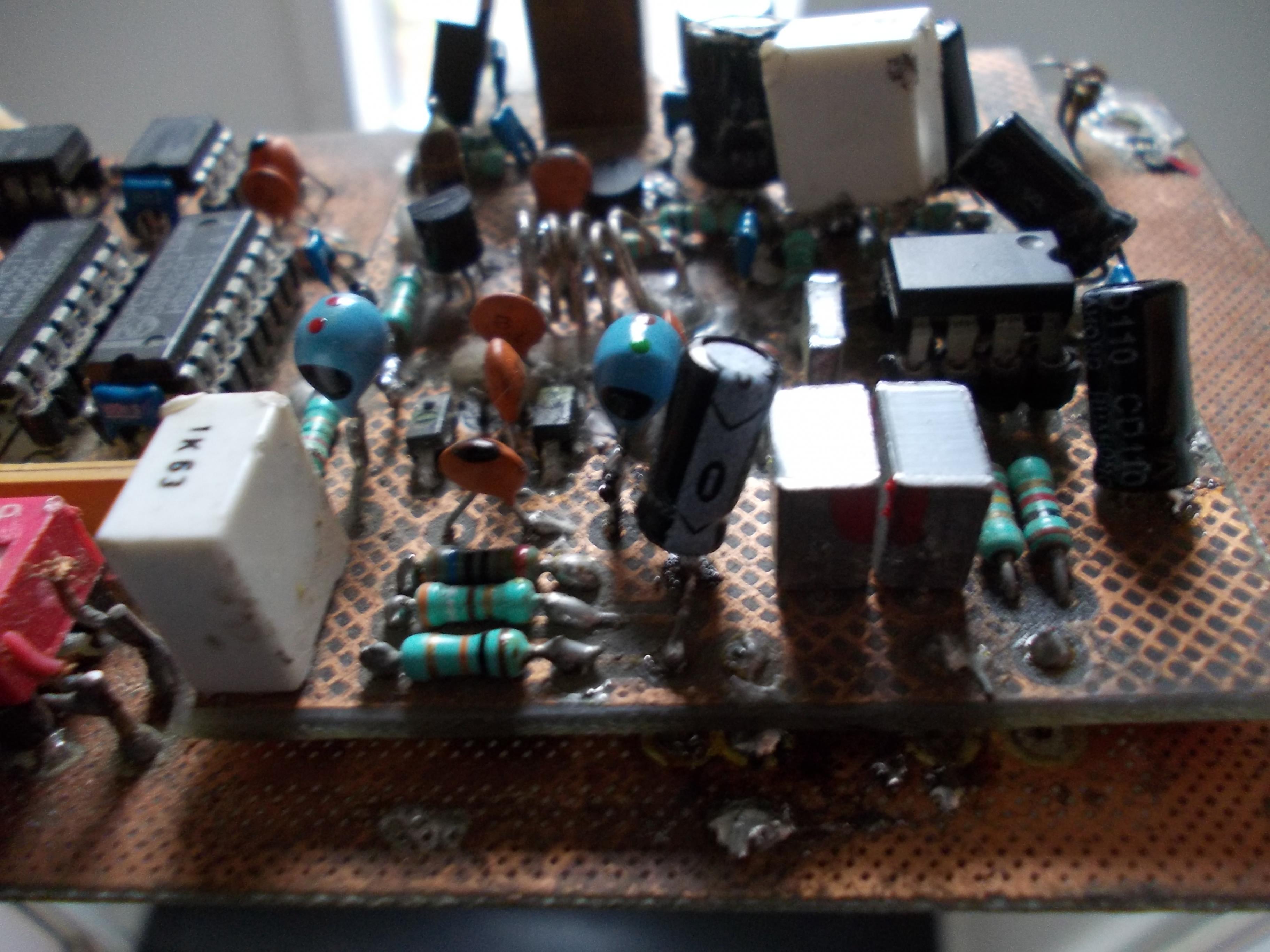

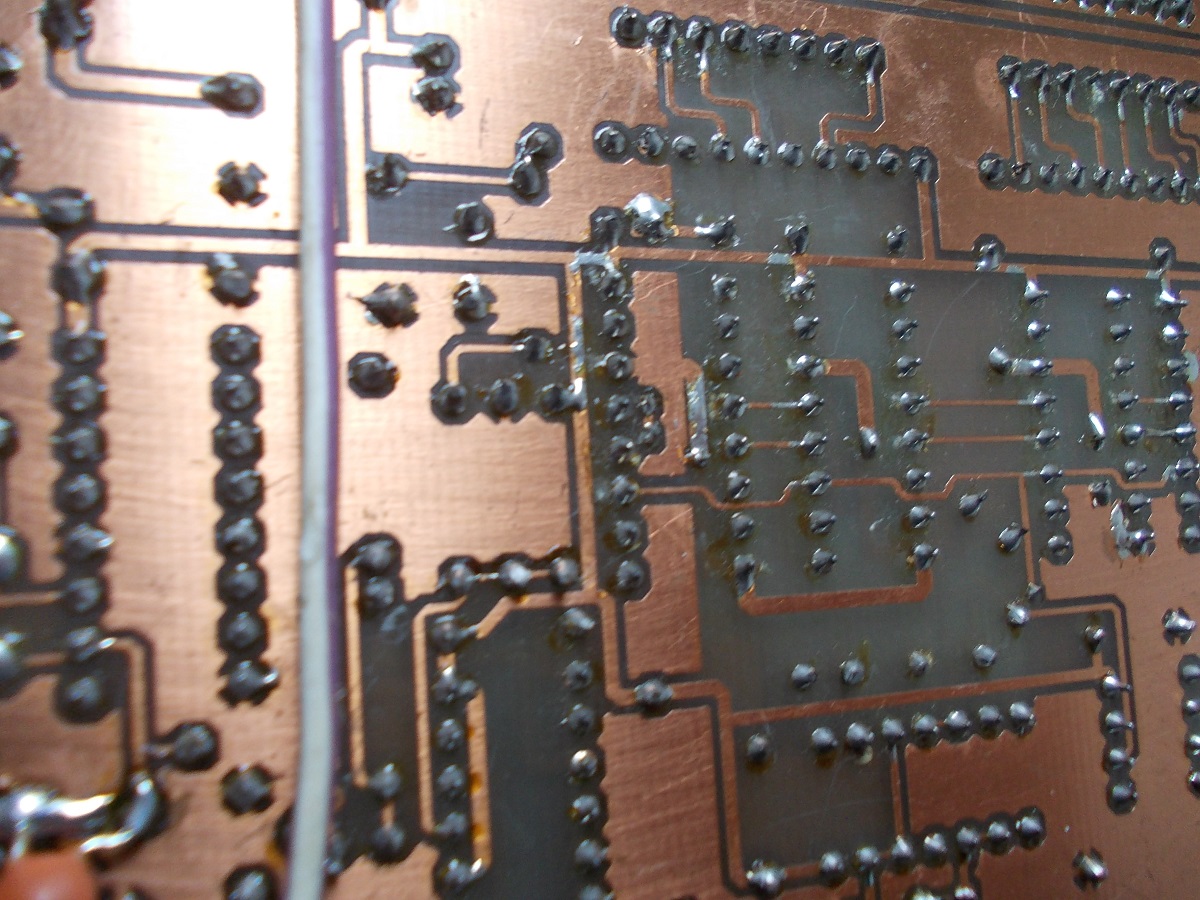

Then I was informed wrong, I did make this PLL 3 meter transmitter, with it we did in very long past have a radio station, it is of very high quality sound and stability and noise, deep still.
i have this I think made in 1996 if I now well, we use always very thin matal for shield the appartments between amplifier stages, who did well, maybe aluminium is better, but can not be soldered.
I am curious when happens if I put these transmittor next to my bed if I get trouble sleeping, this is on 100 Mhz 10 watts but analog and not pulsed. I have that possiblility to test. not pulsed and no trouble then means the pulses are the cause, and not natural.
I did made the pcb with ultiboard that time, the dos version, I have now get out the hasp on that because it is outdated and ultiboard is no more and now property of NI.
