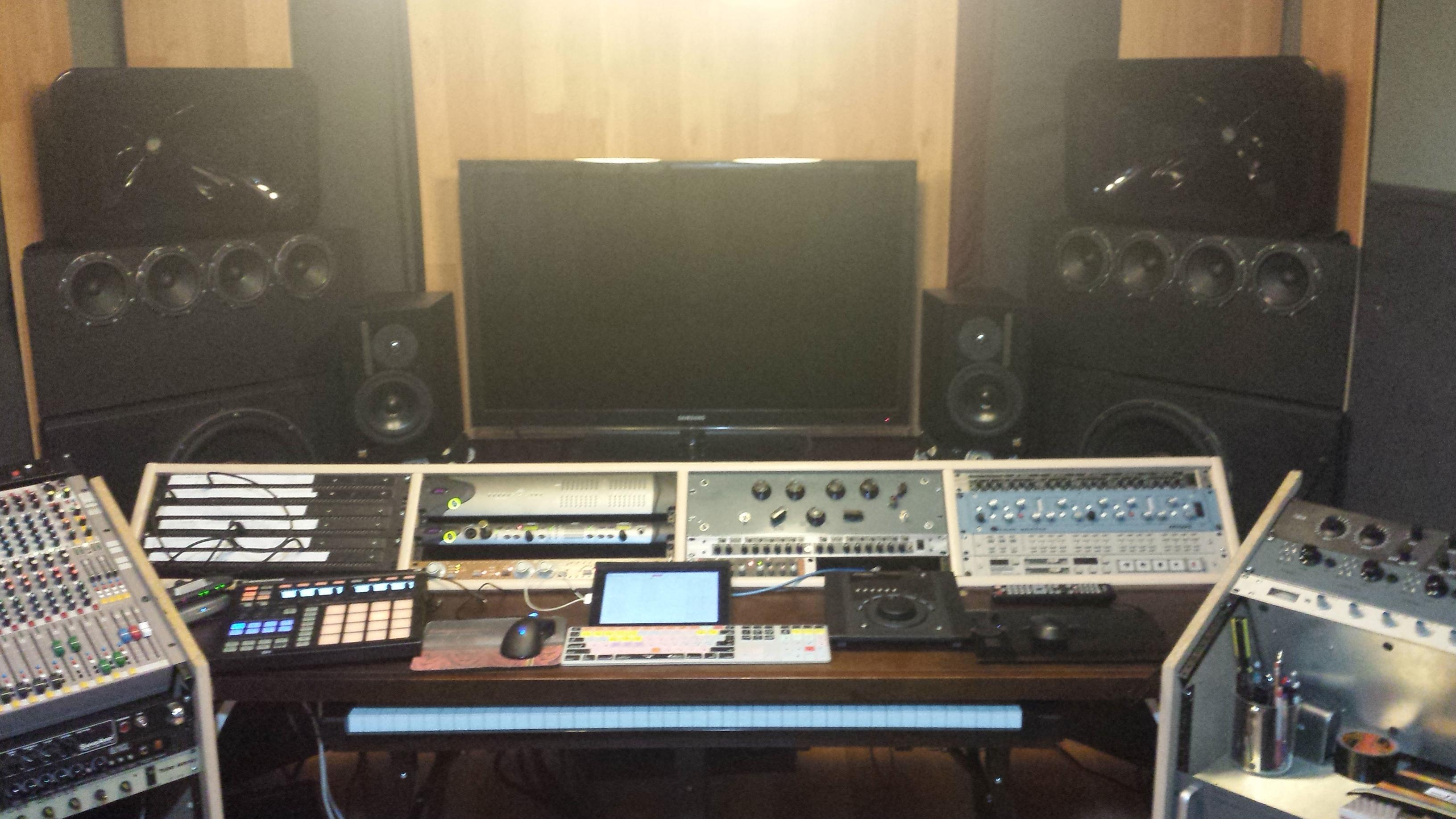

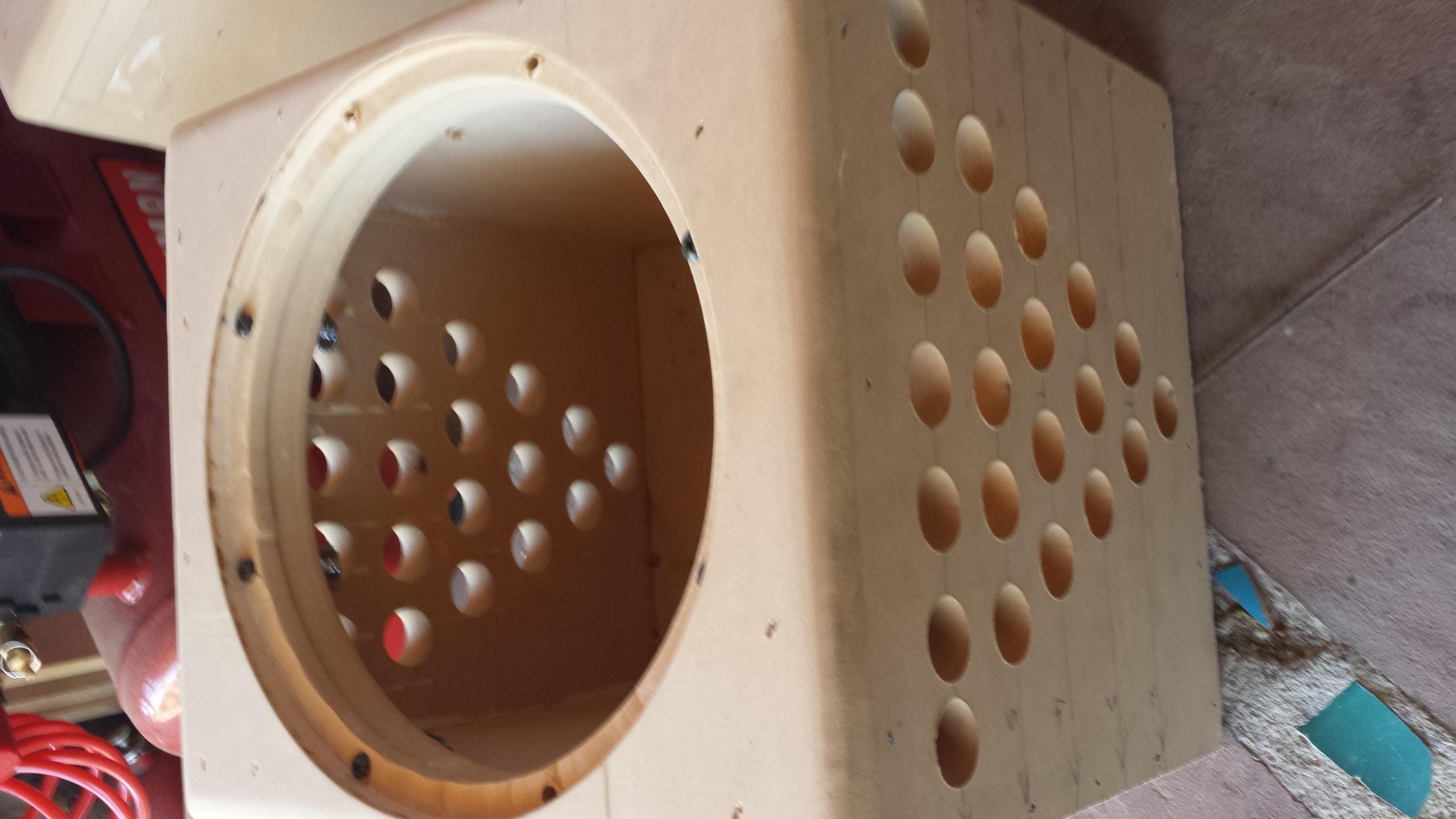

Here is a pic of the setup with the 951's/seos, and the cardiod boxes I've been getting together.
