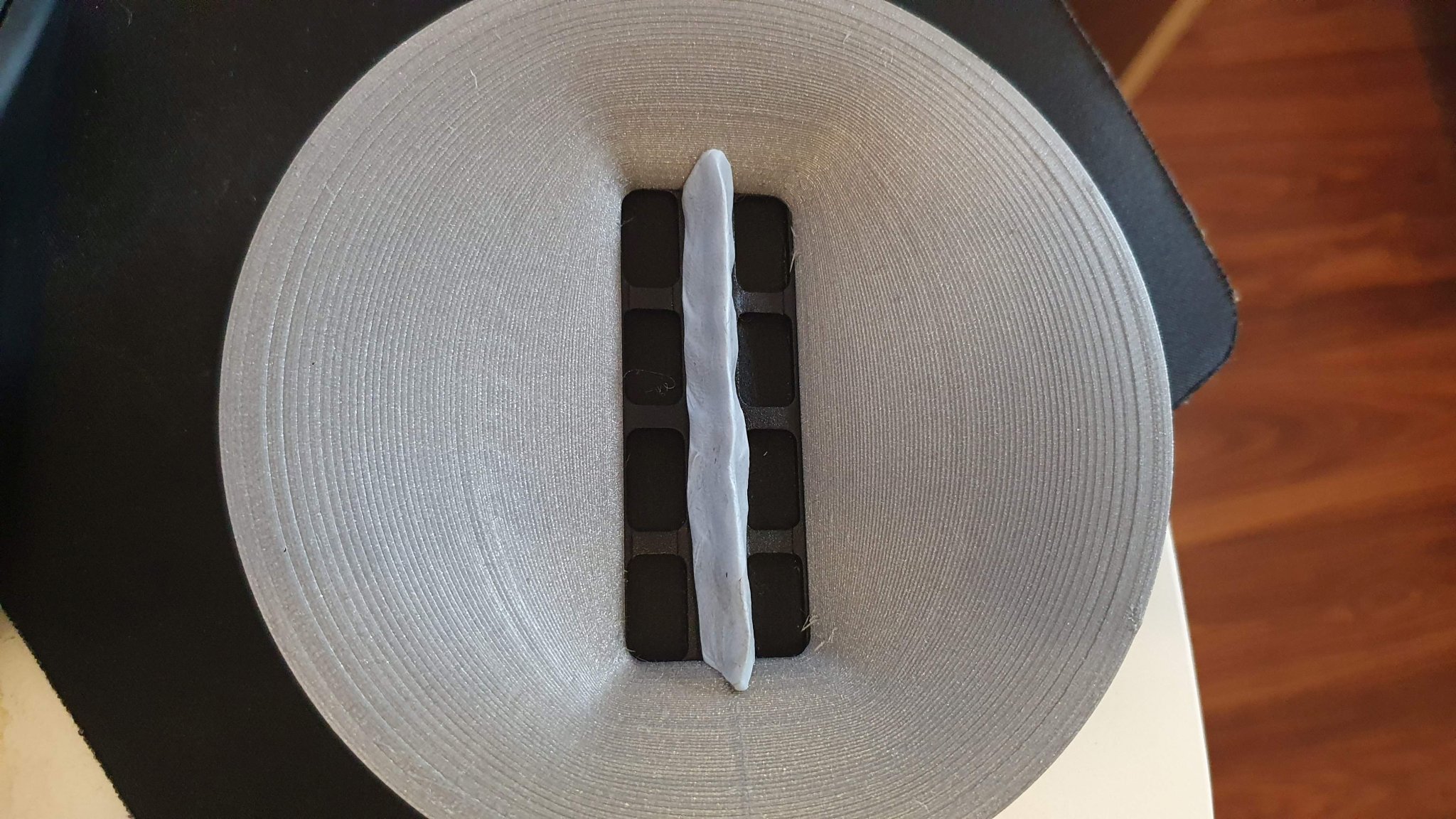

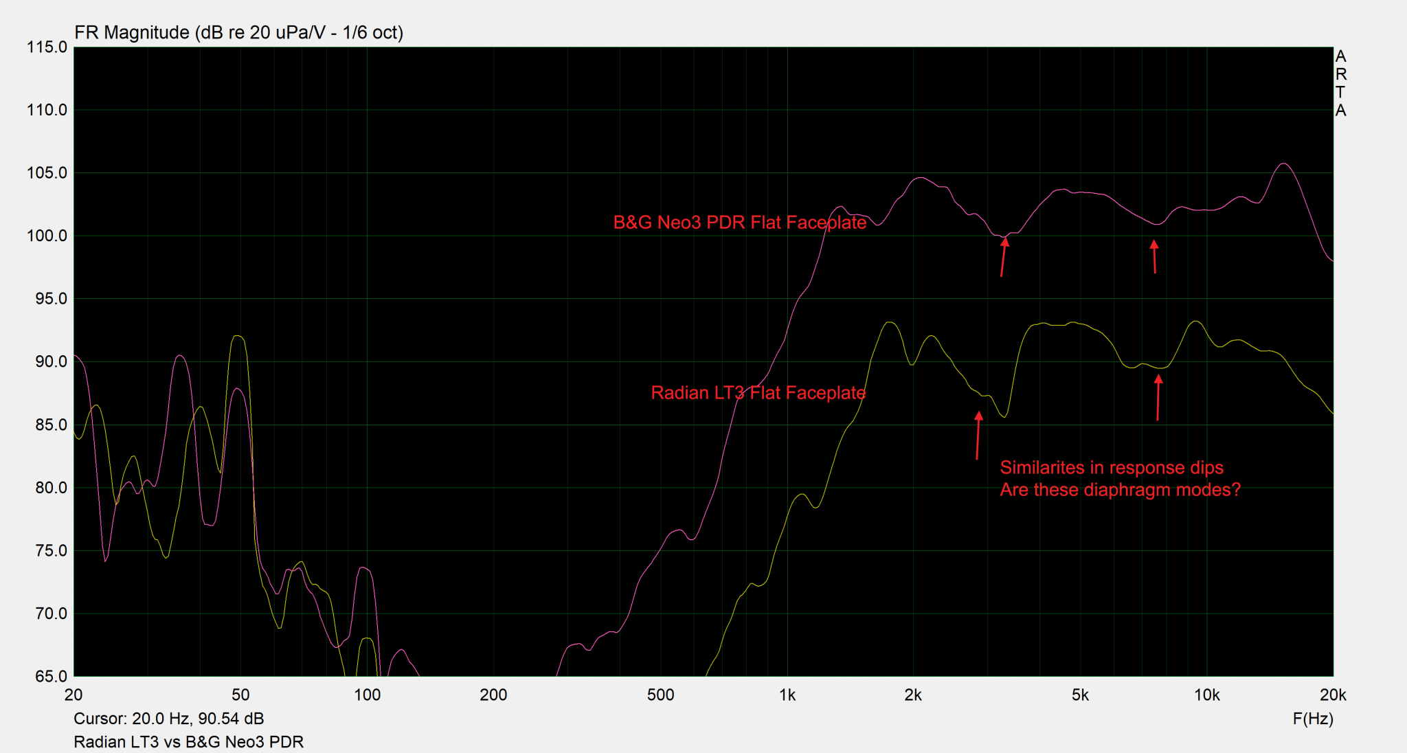

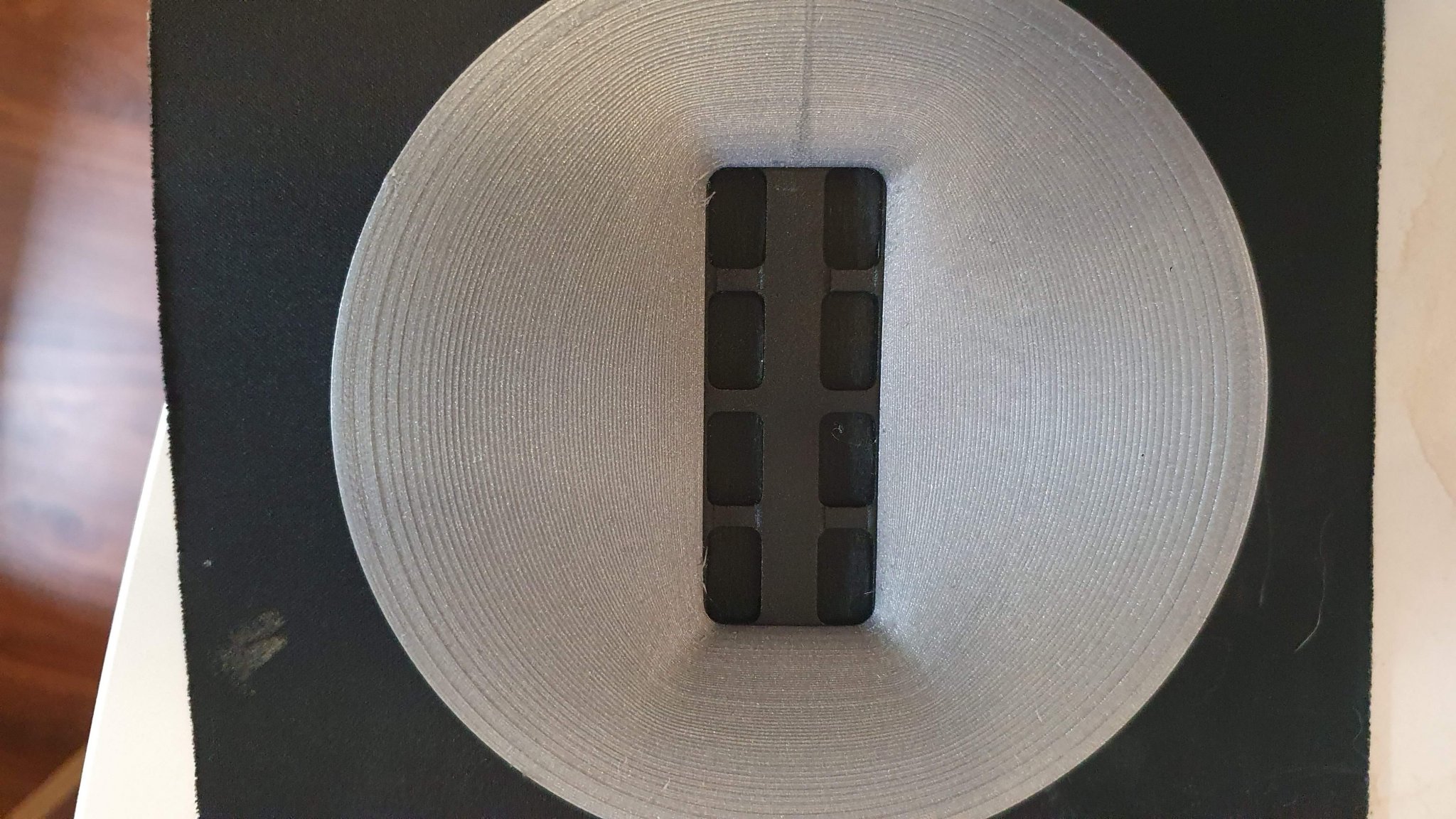

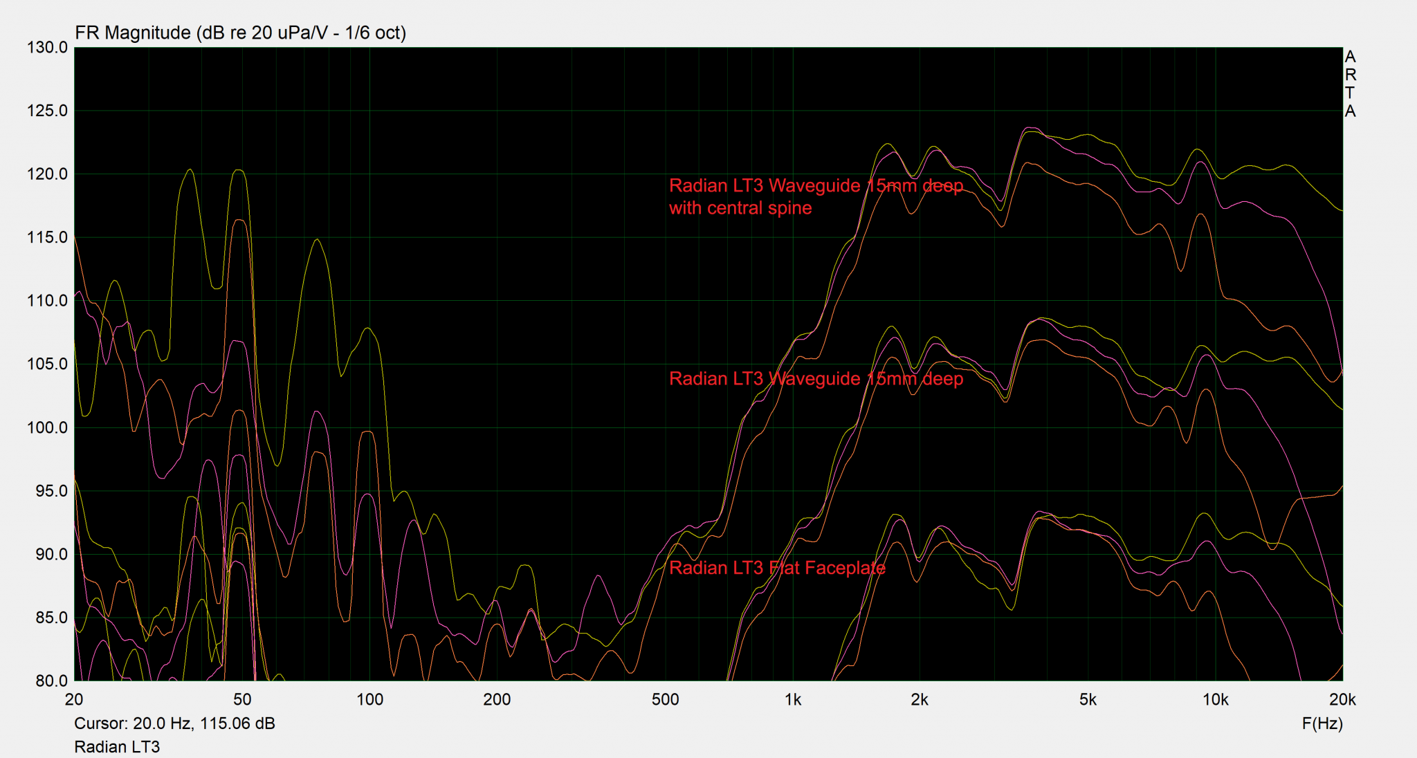

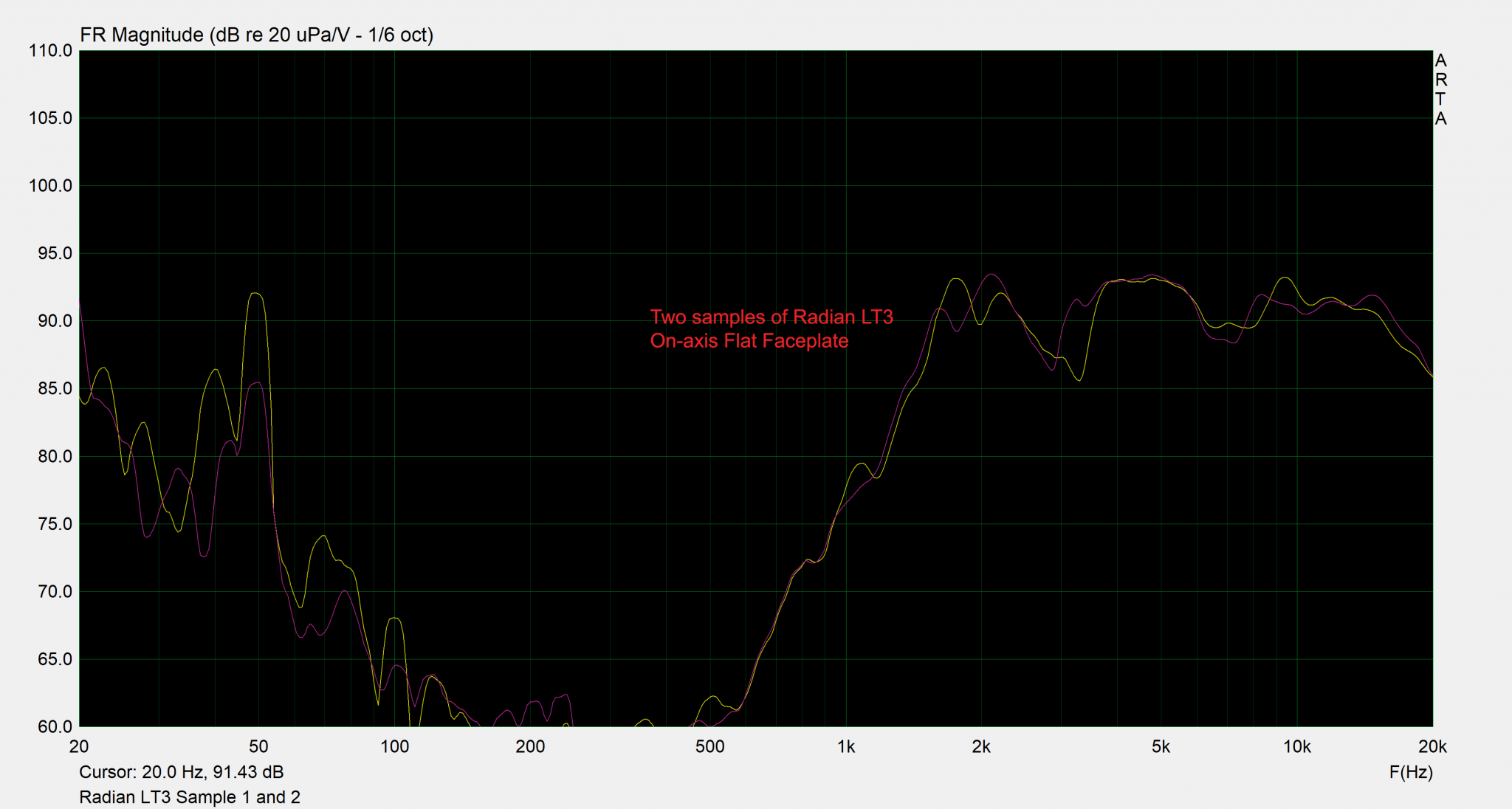

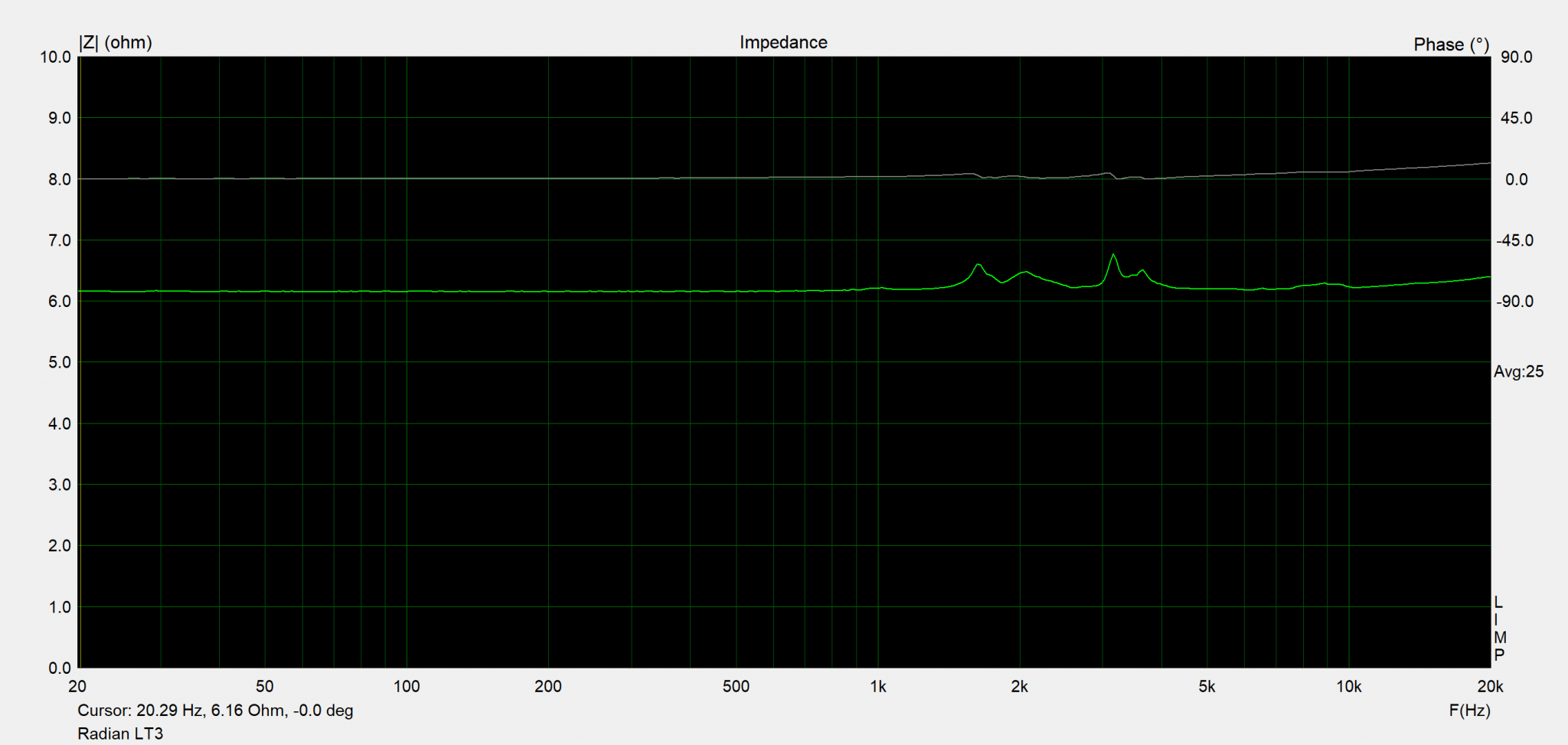

No teardown photos this time, but here are a few response plots of two Radian LT3 drivers I got. I've also attached the 3D model for the waveguide.

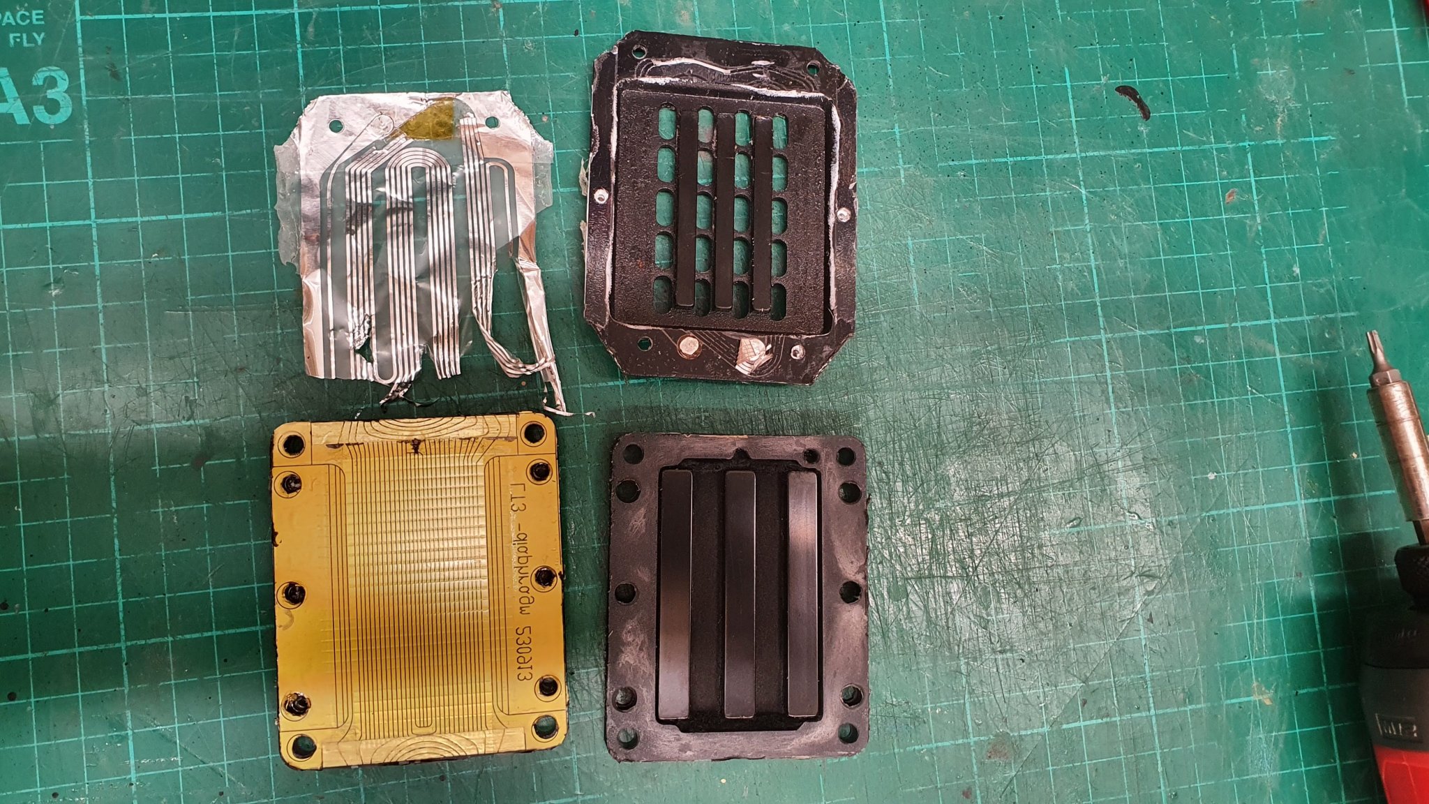

I think these drivers internally must be very similar to the Neo3, only with bigger magnets and fewer but larger holes on the front. There is a striking similarity to the two dips in the response of Neo3 drivers at about 3KHz and 7KHz.

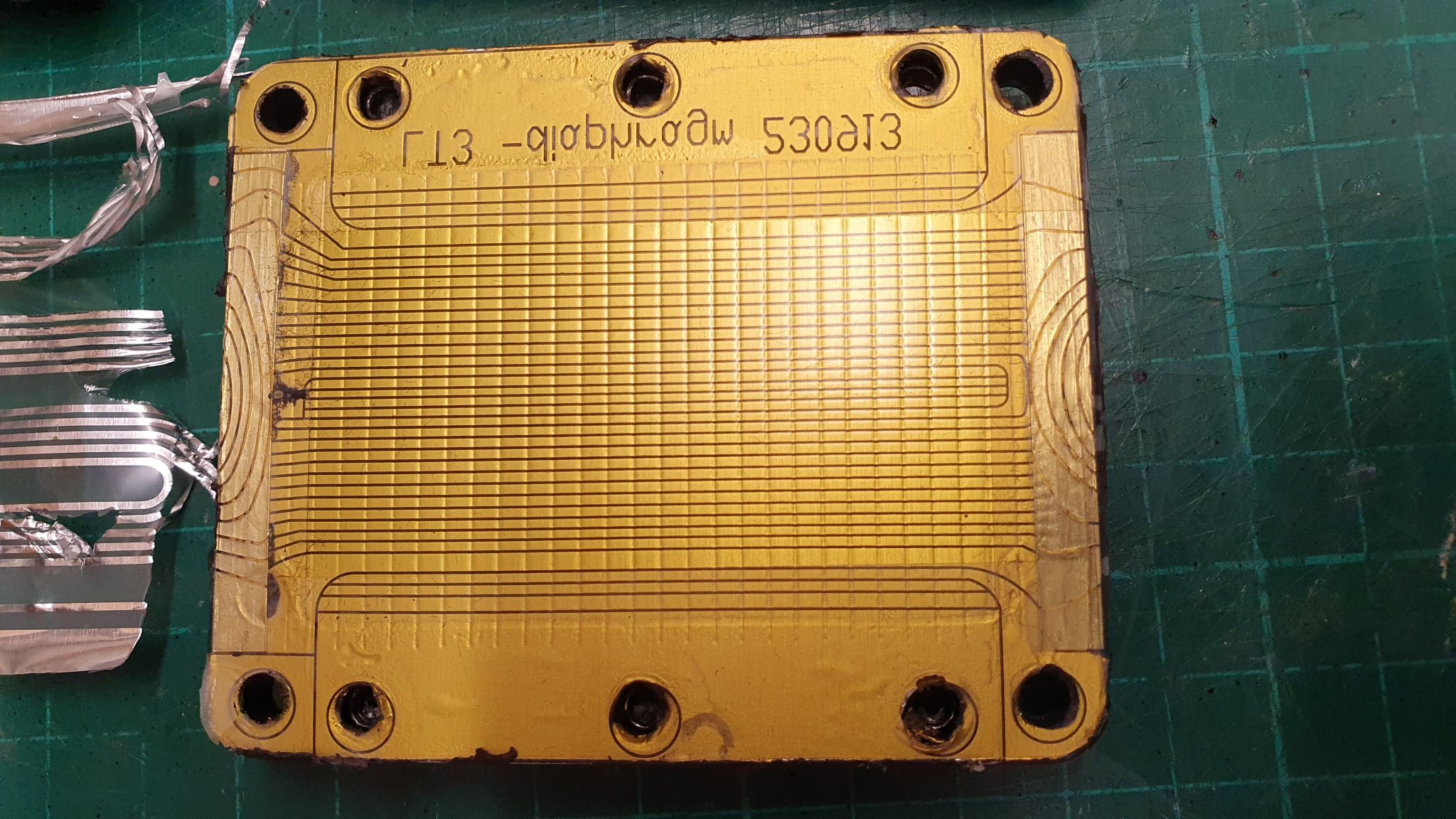

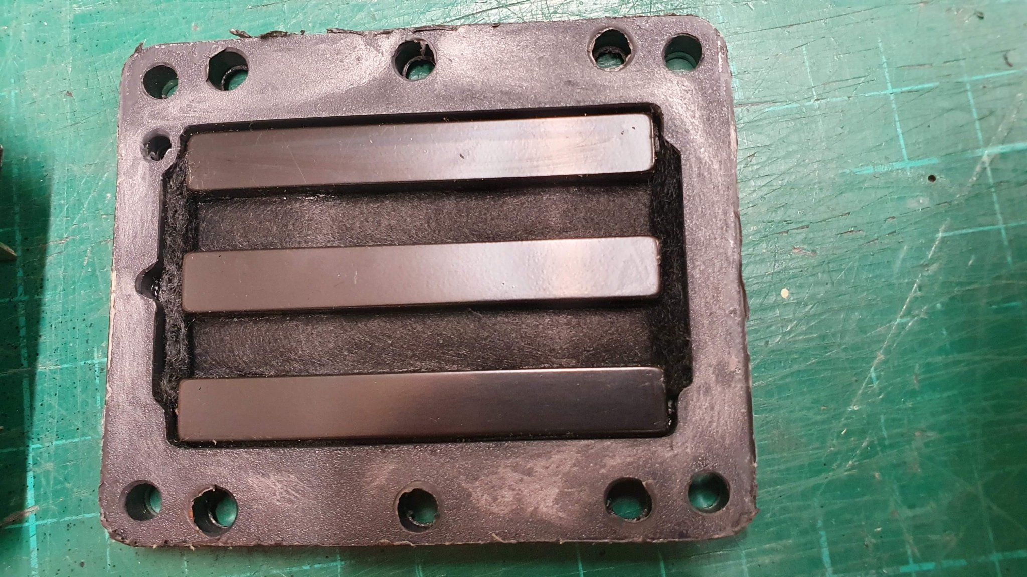

Faaaak curiosity killed the bank account, I just had to see inside but my gosh those magnets are strong!

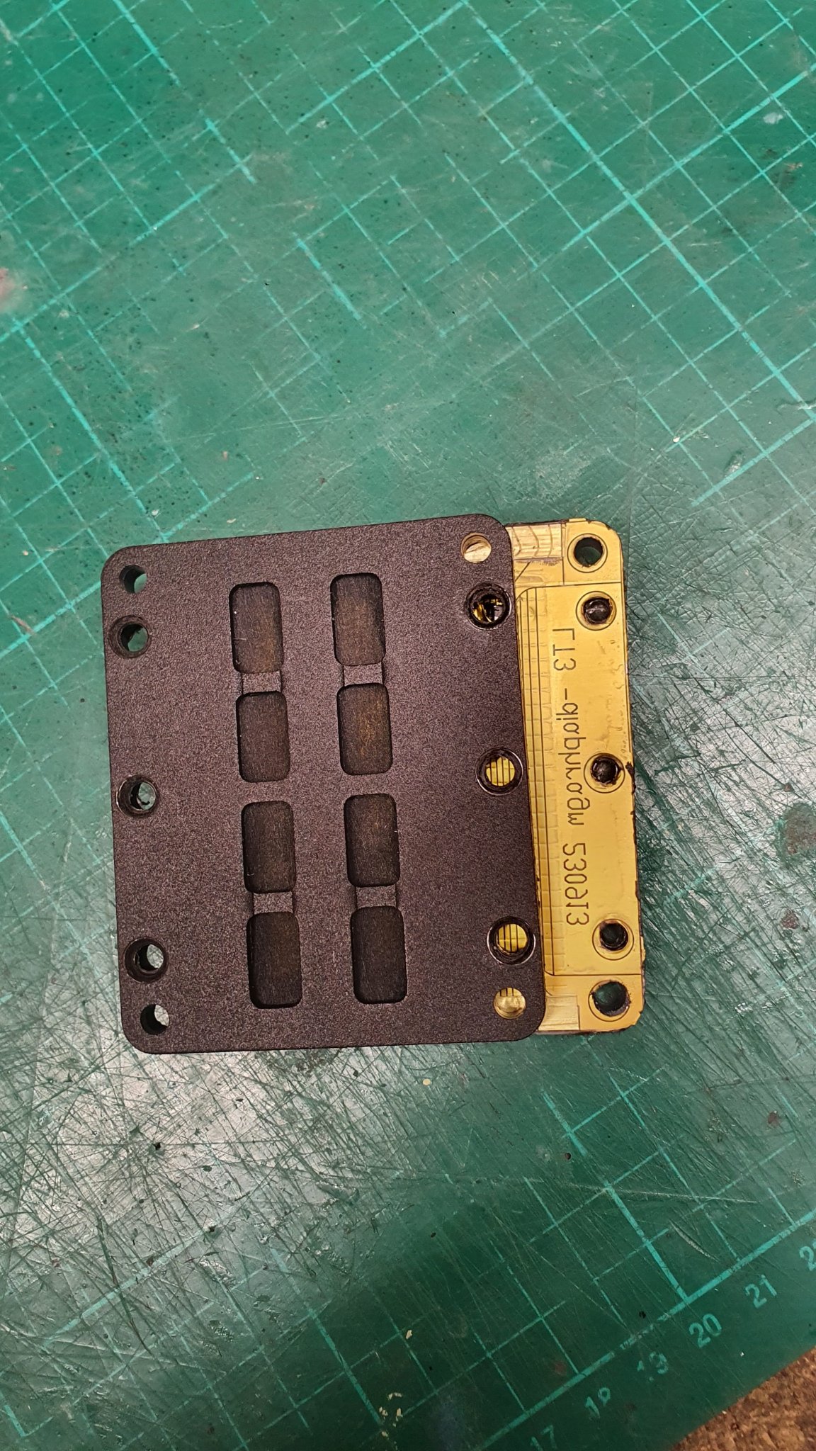

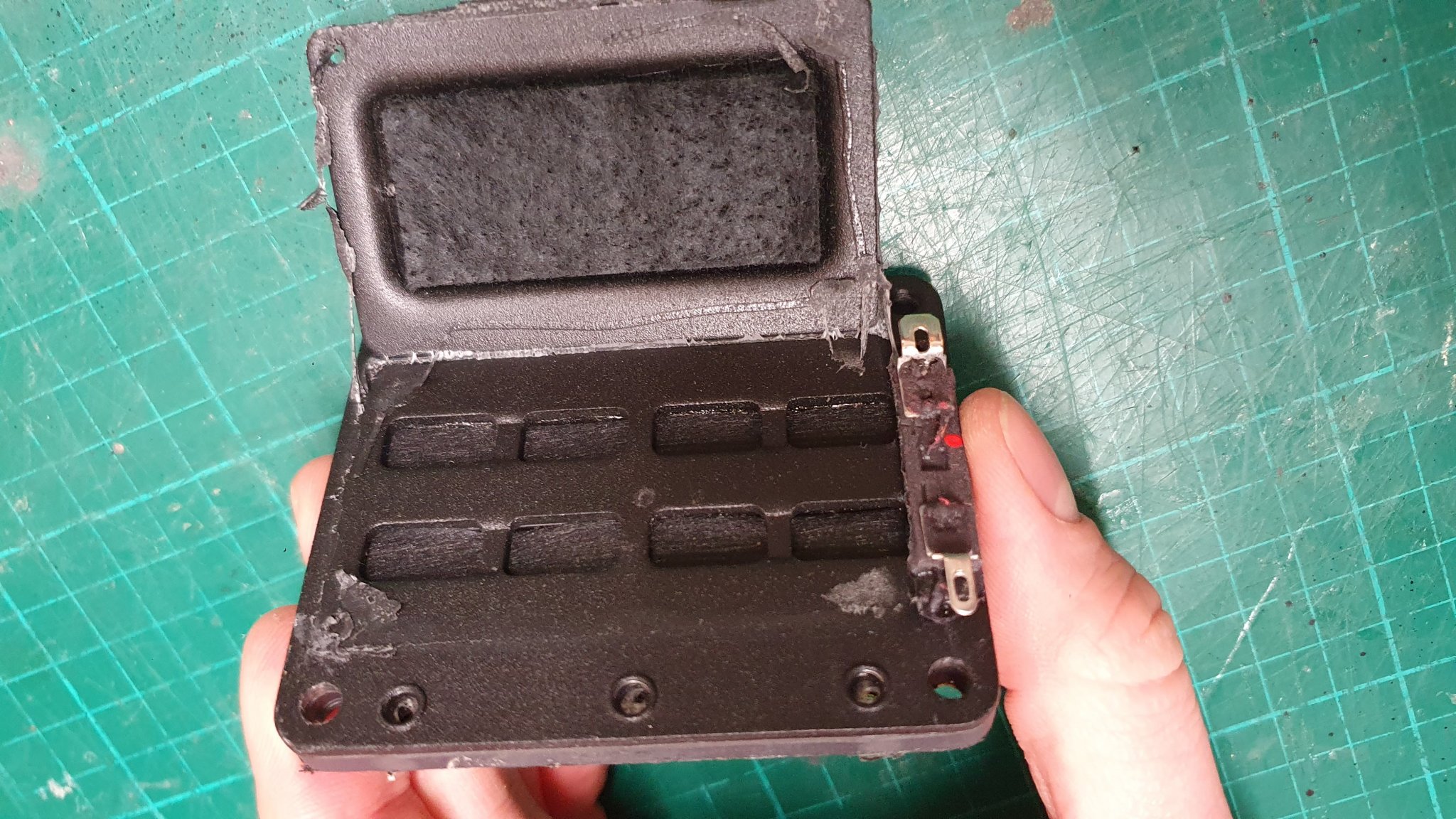

Apparently no damping inside the case, even in the back - only in the rear chamber.

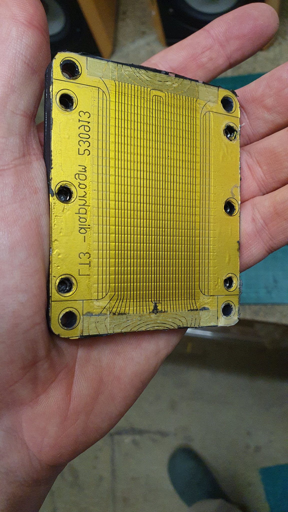

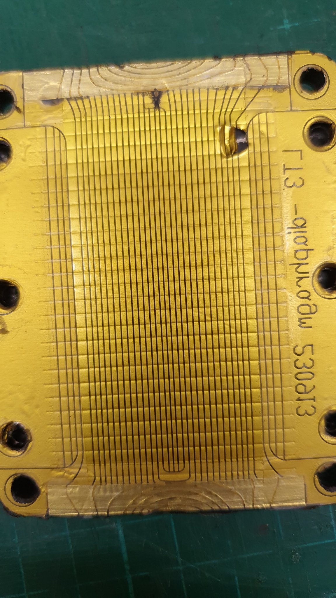

Weird pattern on the 'in-active' top and bottom of diaphragm - have they folded it over to reduce space used for the traces that link the 'active' traces on the diaphragm??
Like the LT2, pretty creases in the diaphragm and no etching away of unused metal.

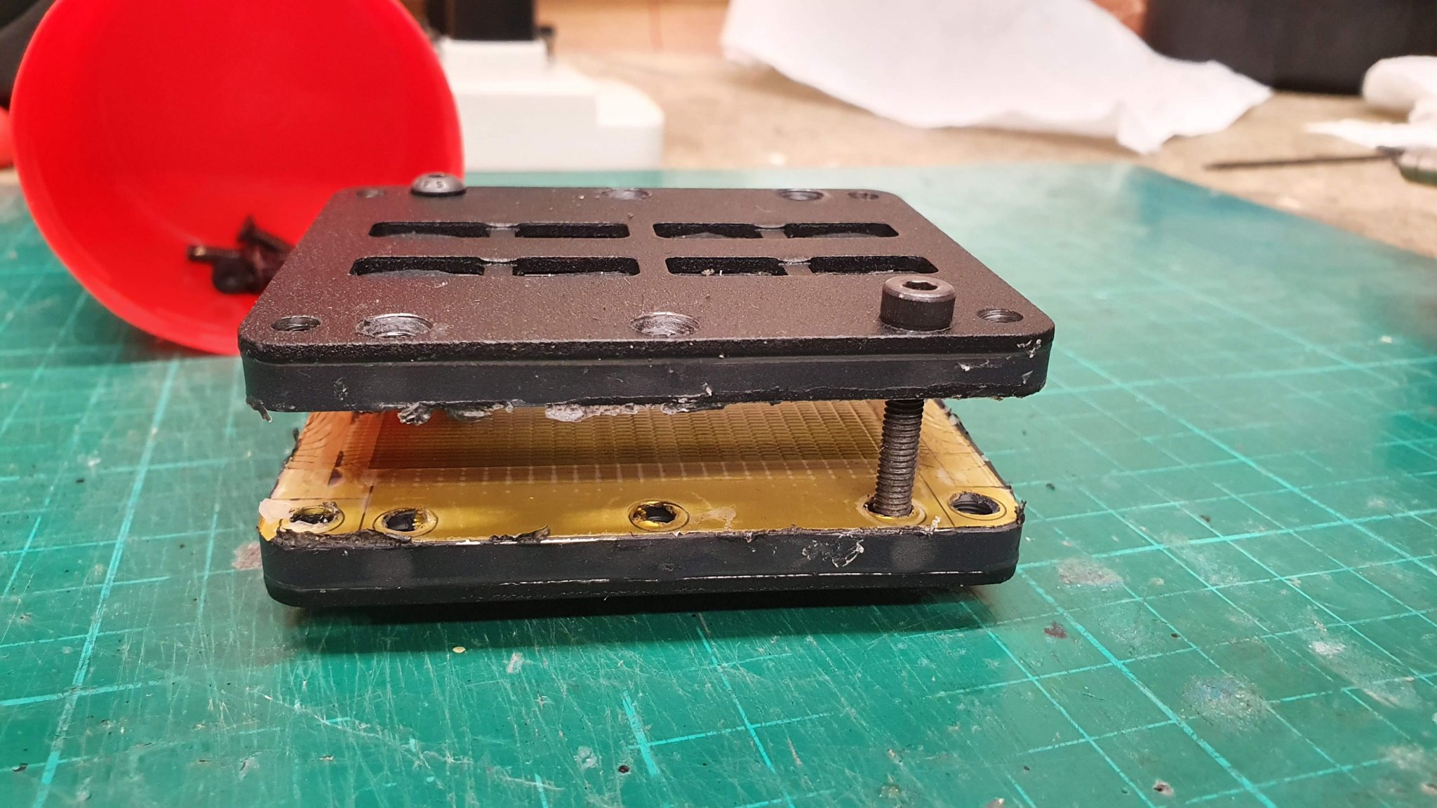

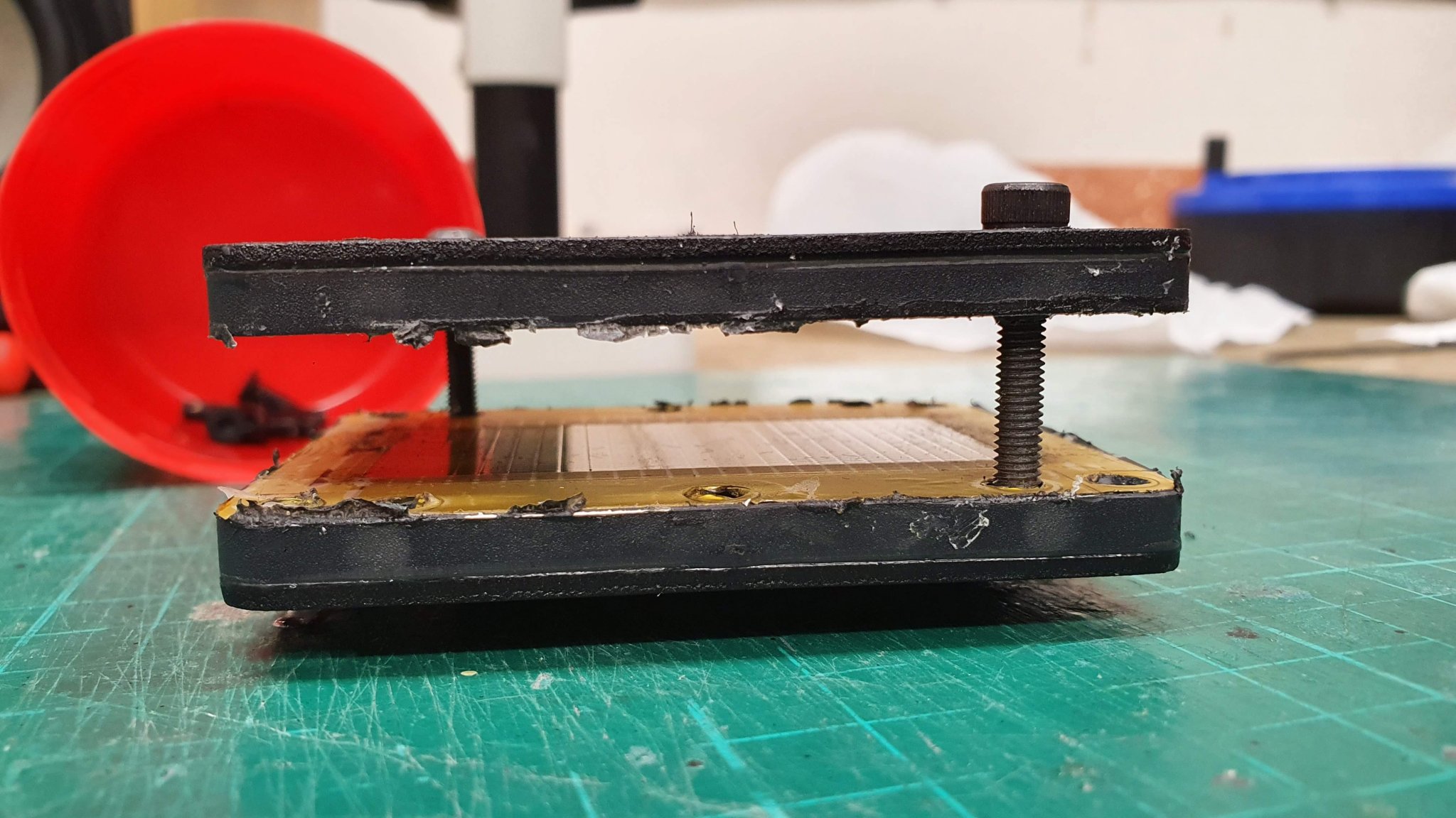

(0.75mm gap)
Whoops during re-assembly!

(0.75mm gap)

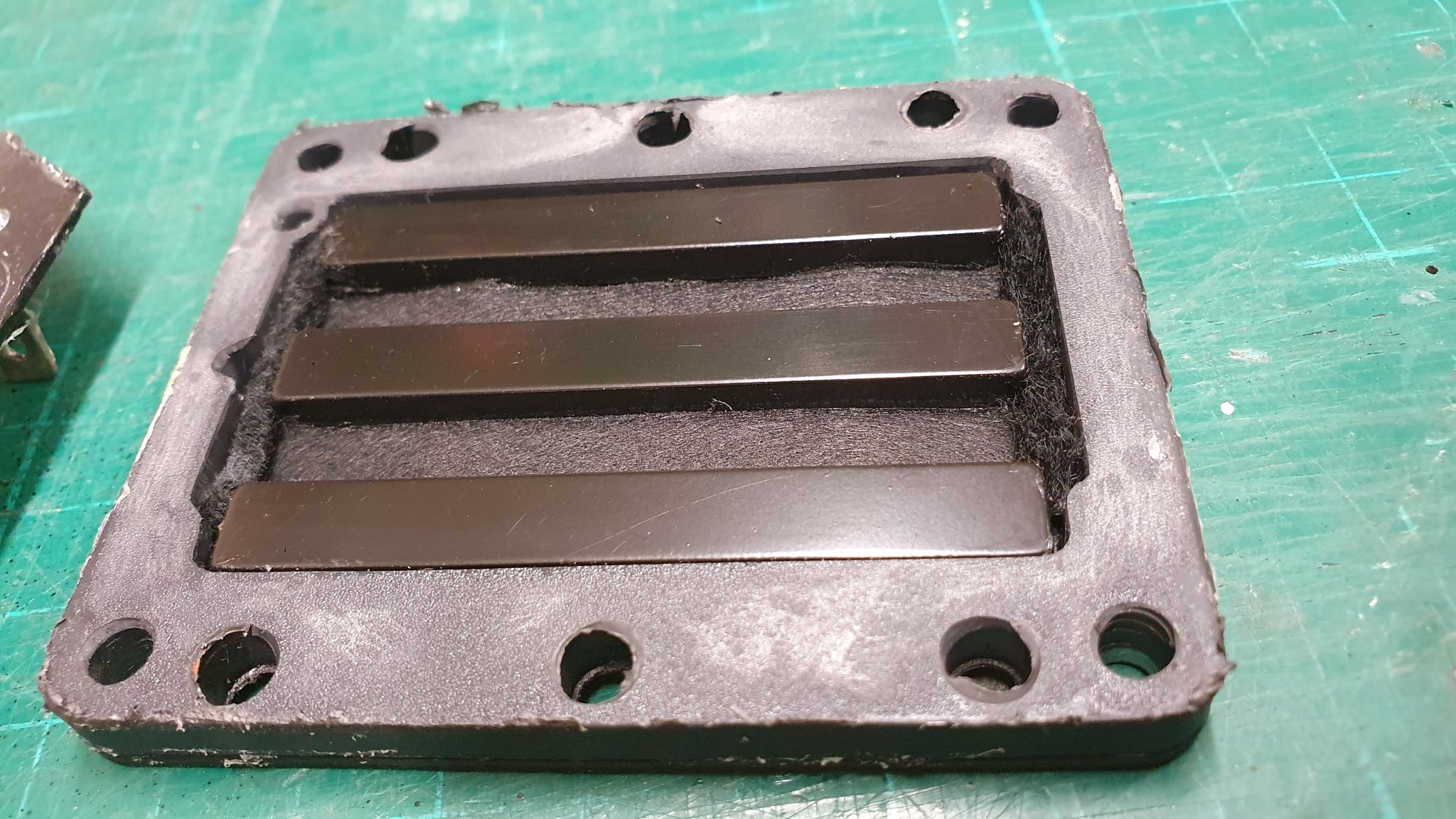

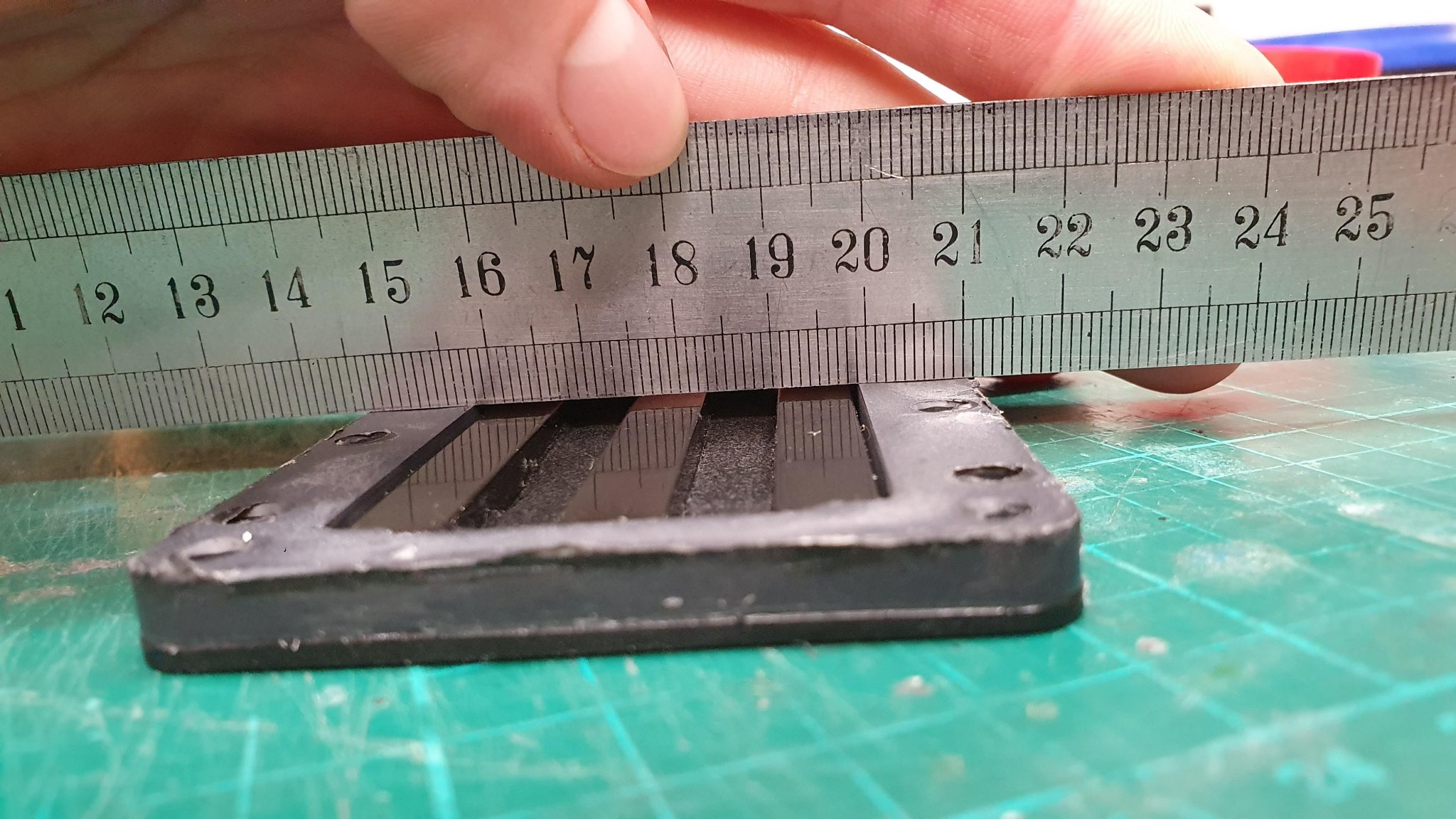

Could you measure the magnets ? i know you sort of did but it is really hard to make up what they actually are.to bad they put the felt in between or behind the magnets..its a missed change of having more damping with less felt, hence less losses in the top end.
Foil looks nice, not sure if the corugation does much, when they are crossed at 1.2khz... usually corugation is usefull to reach a lower resonance but im not sure where the resonance would be in this case. could you measure that ?

Magnets are 8mm x 60mm, 4mm thickness. 8mm spacing between them.
Difficult to say about resonance, I think what we see here is mainly cavity resonance due to the matching with those big dips in the response. Perhaps the very slight rise around 1KHz is the main tuning freq. of the diaphragm?
By my judgment I would say the narrower opening on this LT3 compared with BG Neo3 helps match the on and off axis response better. However it also makes those dips at 3KHz and 7KHz stronger. Probably a sensible compromise if you have a system with DSP, but not so great for passive.

Well.. on and off axis are more matched than neo3, so a benefit there. If you EQ the output flat it looks nicer than neo3 with lower distortion too. High frequency is more narrow though.

by the way thats some rather high impedance peaks for a planar in the middle of the working region. never seen that. i guess some resonances there?
The LT3 is really much thicker foil than the smaller LT2 (120micron). It doesn't say the thickness but it feels very strong.
The LT2 which says 120micron actually feels more delicate than the BG diaphragm. I guess the corrugation creases allows movement even though it is a thick material.
The impedance spike at ~3KHz matches with a big dip in frequency response - I think that is the cavity created by the front and back metal plates.
The impedance spike at ~1.5-2KHz I guess is due to the rear chamber which is quite small.

Just out of curiosity, how did you go about designing that waveguide? the increase in SPL that it gave is quite substantial. I've been thinking of building something like that for a GRS Neo 3 driver.
View attachment 1050379View attachment 1050381
I used a command line program called ATH (search it here there is a BIG thread) and imported the profile curve in to Fusion360 with the script they supply.Hi!,
once I had the profile curve I used a loft between the inside rectangle shape and the outside circle shape while using the ATH profile curve as 'rails' for the loft.
