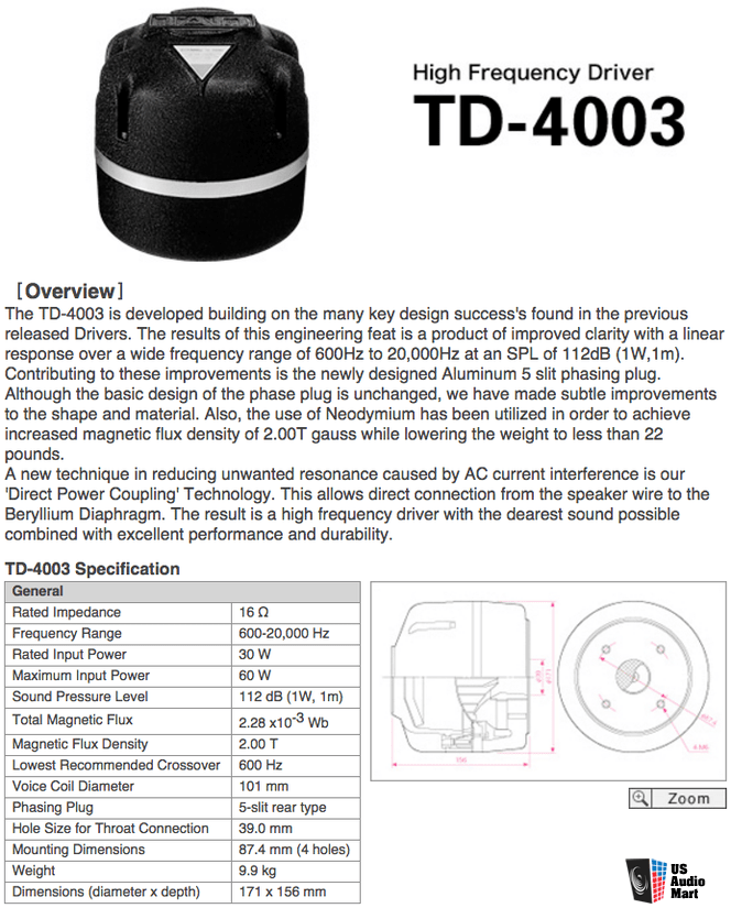

Yes, a completely different motor structure, with Neo magnets. You will see that the TD-4001, 2001, 2002 all have a more tradiitional Alnico magnet structure, like older JBL's. With the huge Alnico ring magnet, and all the structure infront of the diaphragm, necessitating the longer internal throats. Whereas the 4003, has a shorter throat, with a deeper back chamber, while the driver is about equal length.Both the TD-4001 &4003 spec sheets list the same magnetic flux density of 20,000G, yet the SPL of the TD-4003 is rated 2 dB higher at 112dB
The diaphragm was redesigned, the surround was changed, the DP-40003 has the "banana connectors" that plugs into the diaphragm assembly directly, just like the TD-2002 does. A lighter weight diaphragm helps raise efficiency. Never saw a number on the DP-4003.
The DP-4001 is just under 1 gram.

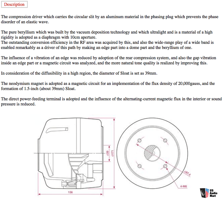

Not really i'd say. The TH-4003 is 39mm exit, finless, 70x30 Apaxial, and with a resonance absorber in the horn.Have you heard or seen comparisons of the newer 4003 design used on comparable horns to the older TAD designs?
The phase plug is different and so is the throat and exit angles as shown below. So even with the different exit diameters it would require a custom throat adapter to use a comparable horn, which would give a mismatch in the throat.
The diaphragm, phase plug, motor sturcture etc. are all improved in the 4003, along with the 39mm exit for better HF dispersion. It does not have the beryllium half surround resonance of the DP-4001 that keeps it 'flat to 18k. So the driver is better behaved in the top octave, with lower distortion. Although it is still a 4" diaphragm, but the nastyness in the top octave is fairly well damped.
It is a improvement in just about every area, provided you can live with the TH-40003 or get made custom horns/waveguides that fits the driver and it's throat.

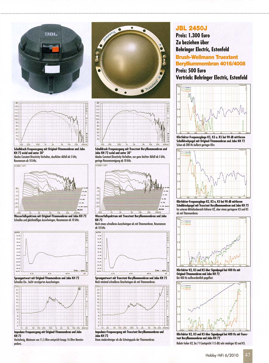

I think the TD-4001 is better compared with the 2" drivers like: JBL 2450H, 2440/41, Sony SUP, GT sound GSU, DAS ND/K8 etc.
The 2450H with a Truextent diaphragm performs decently as shown.
1084777-fc4cc9b4-pair-tad-td4003-td4003-drivers-for-exclusive-2404-speaker-like-new.png153 KB · Views: 78
1084778-9141a250-pair-tad-td4003-td4003-drivers-for-exclusive-2404-speaker-like-new.png164 KB · Views: 73

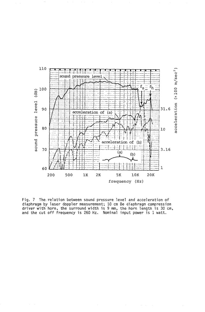

AES Kinoshita Lochanti The Influence of Parasitic Resonances on Compression Driver Loudspeaker...jpg89 KB · Views: 83

So yes they are more fragile, it has to do with the thickness and manufacturing process, heat treatment and how that affects the material etc. Tad uses a vapour deposition method, it is explained in the attached document in previous post, with pictures of different grain structures.
