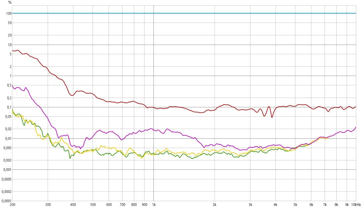

Only to show it qualitatively, the ND4015@TH4001 with custom adapter. You may see where it becomes worse towards LF:

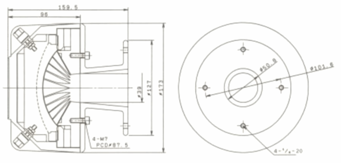

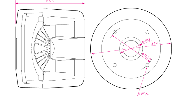

In regards to Tad drivers (ignoring the 4003 because it's impossible to find) whats better the td 4001 or 4003 from 800hz to 12khz?
Driver response should be the same, but the 4001 has a 49.4mm (~2") exit, the 4003 39mm (~1.5") exit.
2" throat horns generally require more sonic compromises to achieve uniform dispersion above ~10kHz than 1.5" throat horns.

Sorry I'm not versed in these graphs enough to recognise them without a key. Can you help, where do you feel distortion levels are unacceptable?
You may recognize the steep increase of distortions below 400Hz? imo the driver should be almost out of the game below this attached to TH4001 so your x-over design should account for this.

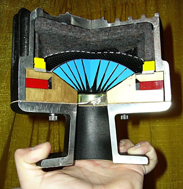

Where it is clearly described how the half roll surround resonance of the DP-4001 diaphragm (TD-4001/4002), is the reason for the TAD's extended flat top octave.

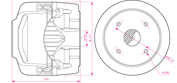

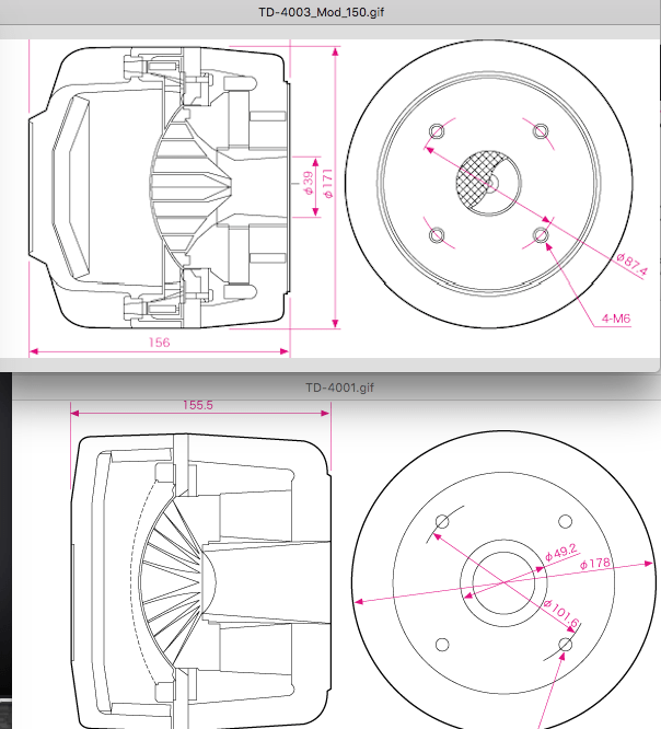

No they are not, the 4003 uses a different improved 4" diaphragm, a different phase plug and different motor structure using ND magnets. And the response is not the same.
The 4001 and 4002 are using the same diaphragm and phaseplug design.
But the 4002 has a 39mm exit and different throat, with a 2" adapter included unless the 4002z is ordered.
It also has a higher strength ND motor, and if you study the cutout you will see they reduced the size of the VC gap, according to they're own research, from post #16 etc.

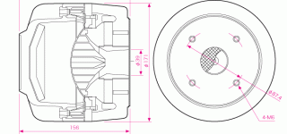

No they are not, the 4003 uses a different improved 4" diaphragm, a different phase plug and different motor structure using ND magnets. And the response is not the same. It also has a higher strength ND motor, and if you study the cutout you will see they reduced the size of the VC gap, according to they're own research, from post #16 etc.
The TD-4003 spec sheet says "Although the basic design of the phase plug is unchanged, we have made subtle improvements to the shape and material."
From the pictures and information you provided, appears to be more than a subtle change 😉
Both the TD-4001 &4003 spec sheets list the same magnetic flux density of 20,000G, yet the SPL of the TD-4003 is rated 2 dB higher at 112dB.
