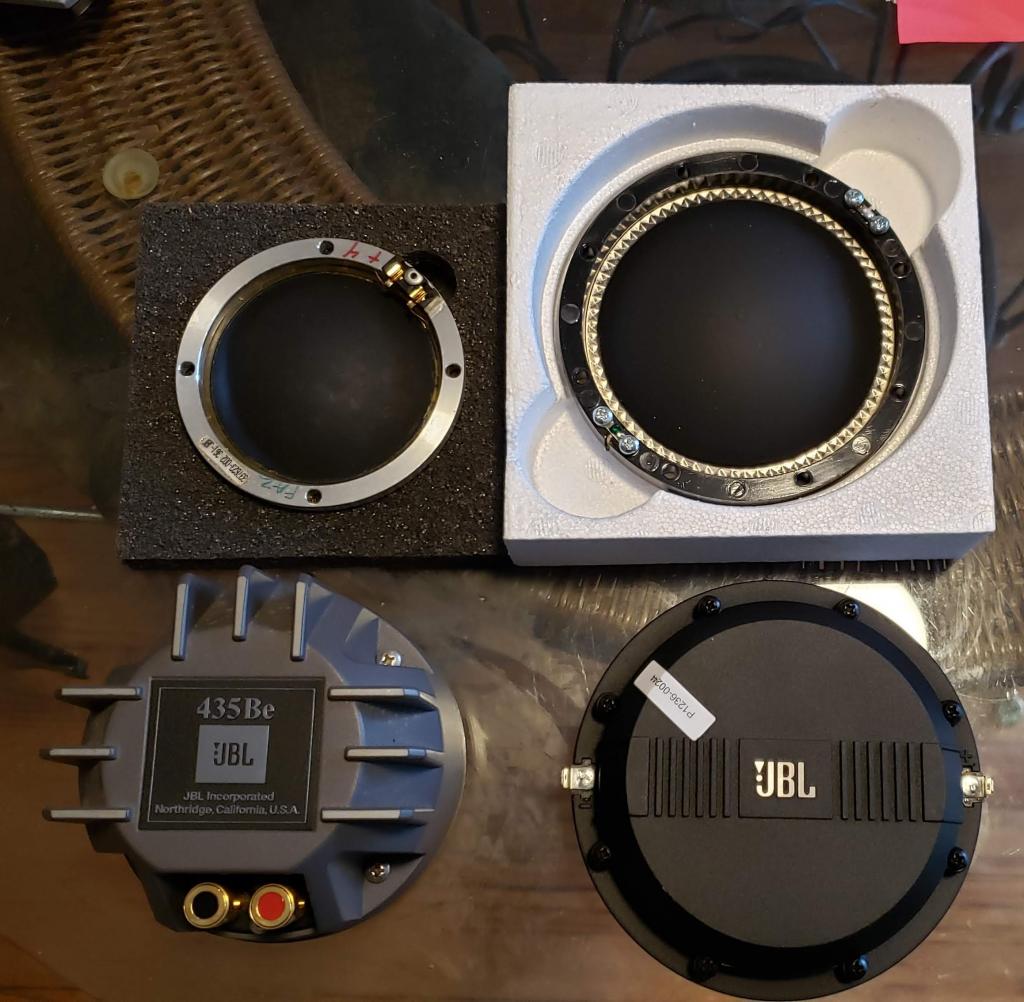

The JBL 2435's are 3" Be 1.5" throat. You can still purchase or get used and replace the ferro. I have used them for years and are good drivers. Very small and light weight.

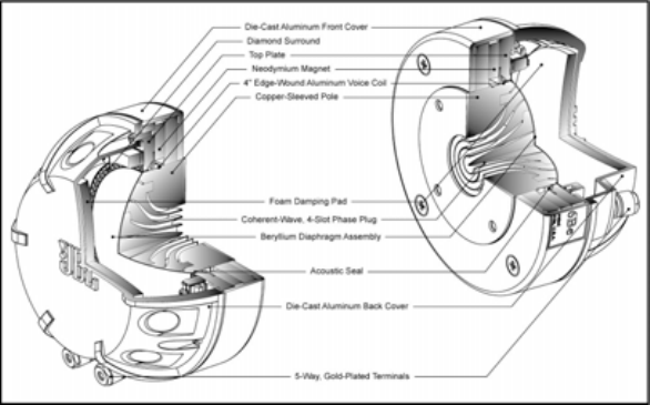

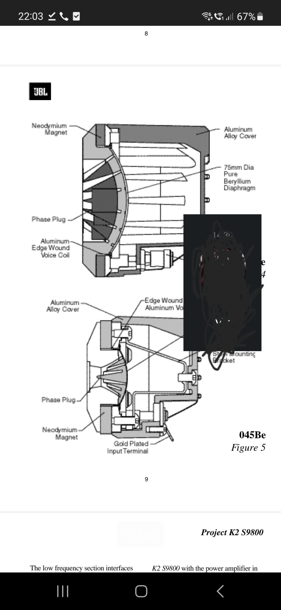

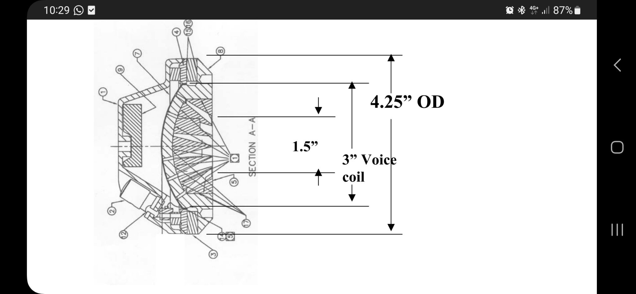

As for the 2435 it differs from the 245x line quite a lot. Added a pic of the cross section/phase plug (2435/435) compared to a 476 with the Coherent wave" phase plug.
And some info in it in the document.

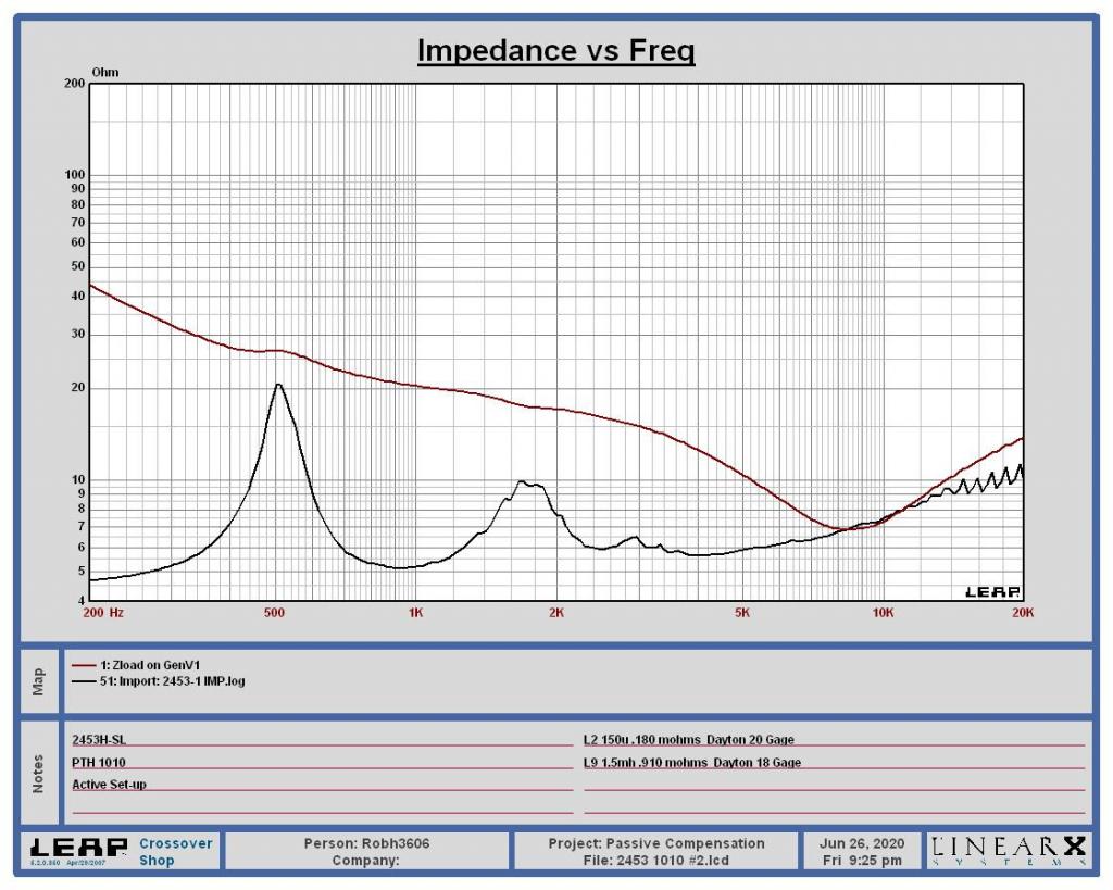

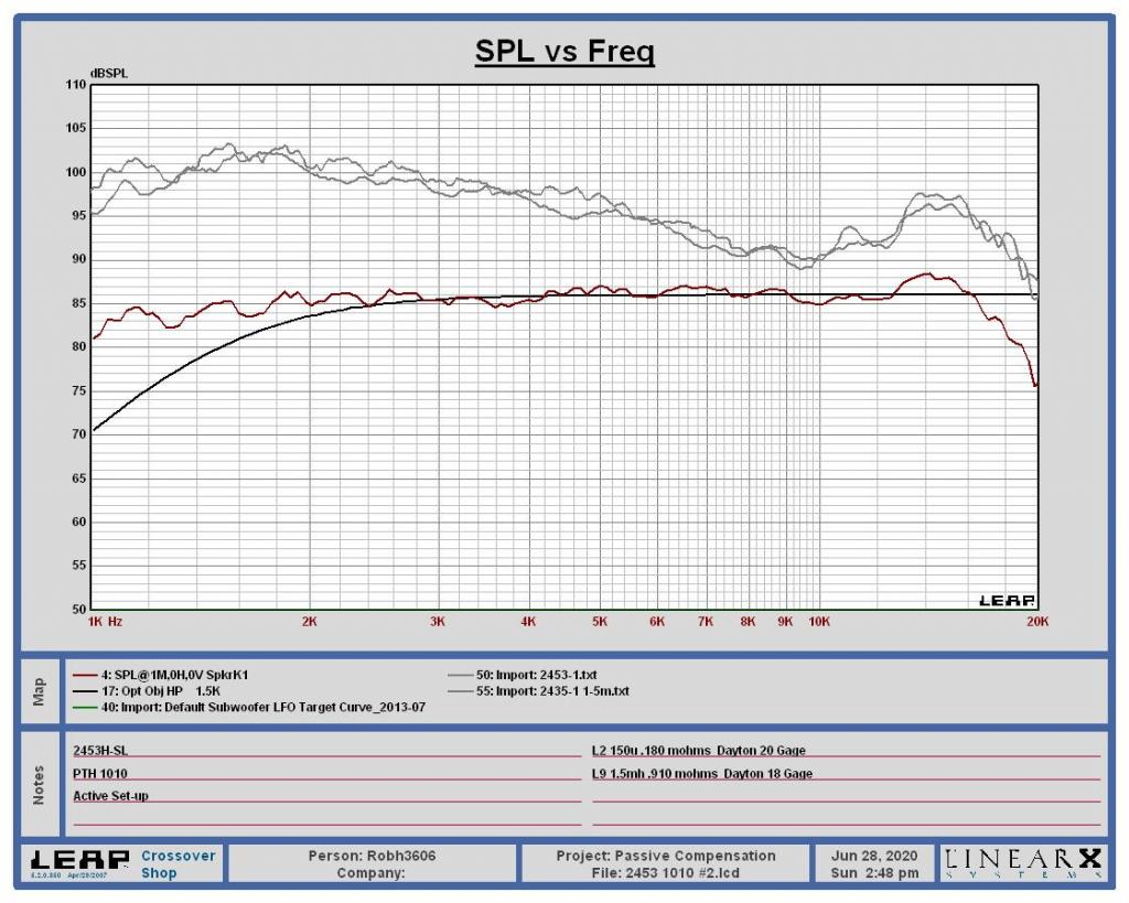

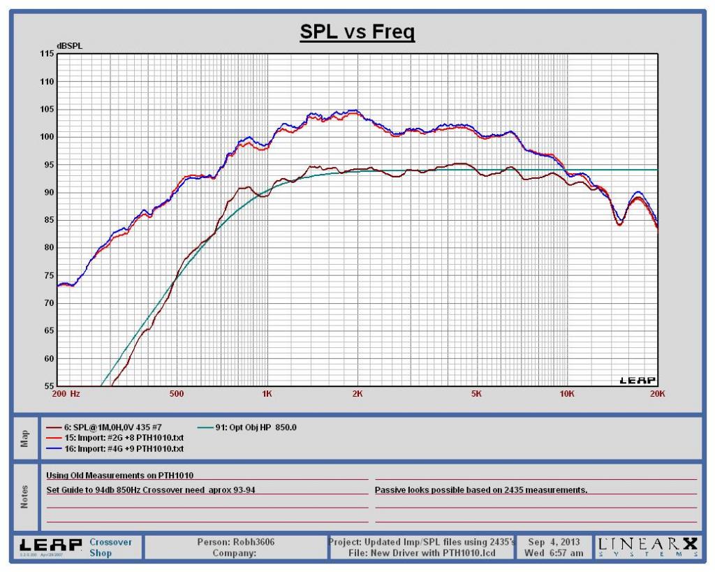

Great video but you really need to keep looking at individual drivers. Here is an example this is an aquaplas coated Be 435 and a coated Ti 2453 SL on the same waveguide. The coated Ti large format driver does well 10-20K compared to the roll off in the Be. They are both good sounding drivers but you have a bit more flexibility with the Ti with less roll off.
You could also just add a tweeter above at 8-10K if you want.

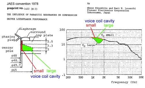

Don't take that to be granted. It is true in that specific comparsion sure. With drivers and diaphragms with similar construction.You can see the smaller 3" does better where it's first significant dip is around 14khz where the 4" has its first significant dip at 10.5khz.
There can also be other reasons for dips in a drivers response like whats shown below from the old TD-2001.
Same issue as is plaguing the HF10AK that alot of people compare with it.

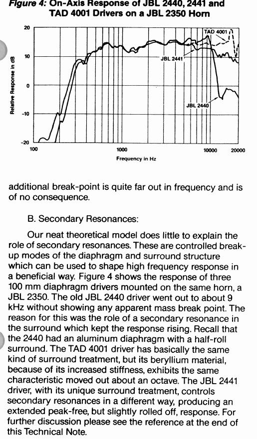

From what I have learnt recently the graphs aren't showing breakup.

Not sure I understand? The rise in level last octave 2453 SL is secondary resonance and actually is break-up just in a more controlled manner. Look at the saw tooth in the impedance curve.
