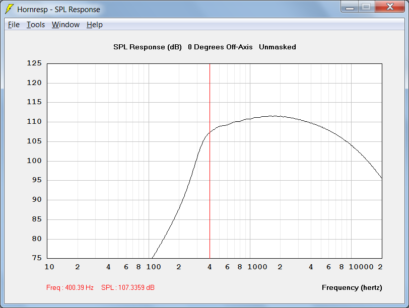

Hi JLH,
Jean-Michel Le Cléac'h used the following parameter values in Hornresp to specify a TAD TD2001 compression driver. I understand that his simulations compared quite favourably to measured results.

The attachment shows the on-axis far-field pressure response of a 320 Hz Le Cléac'h horn (T = 0.80) with TAD TD2001 driver, using data provided by Jean-Michel.

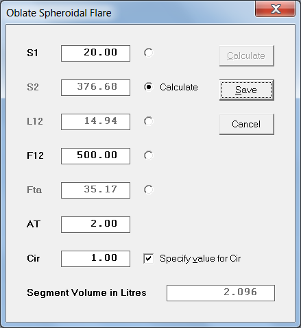

Right David, possible you can walk me through, creating a OSWG?
This is what I have worked out so far:
So set all S & L values to 0. Selecting L12 lets me choose OSWG
S1 is the mouth of the horn, 1" = 12.7mm radius....
If I want a 15" mouth, set S2 to 15" or 381mm.
What next?

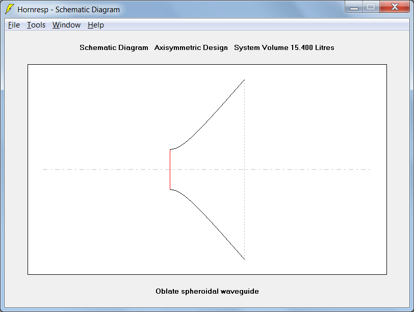

Hi Studio Au,
S1 is the horn throat area in sq cm, S2 is the horn mouth area in sq cm, and L12 is the horn axial length in cm.
The Horn Segment Wizard can be used to specify a design using different input parameters. The attached example shows a OSWG given a throat area S1 of 20 sq cm, a cutoff frequency F12 of 500 hertz, a throat entry half-angle AT of 2 degrees, and a mouth circumference Cir equal to one wavelength at the cutoff frequency.
