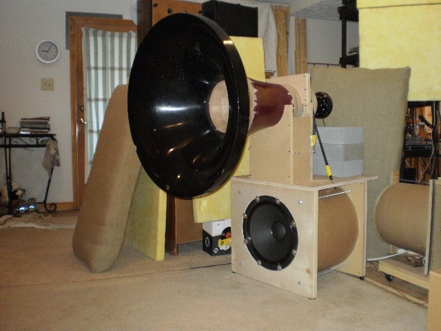

The Radian 850pb's are here, my they are big and so heavy. Will have to rethink my mounting ideas.
I think I will try conical first, as this can be produced pretty quickly and with not too much material. The JMLC 350Hz
Better get started on the big horns. Bass cabinets are made which should handle <800Hz. Pic below

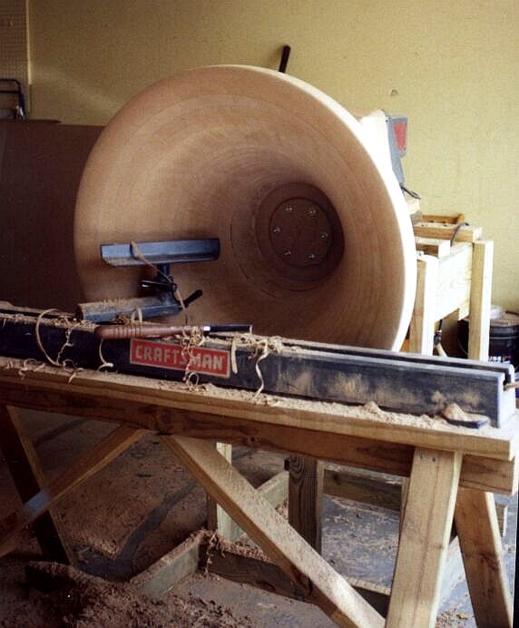

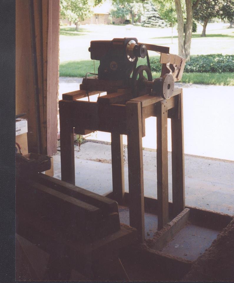

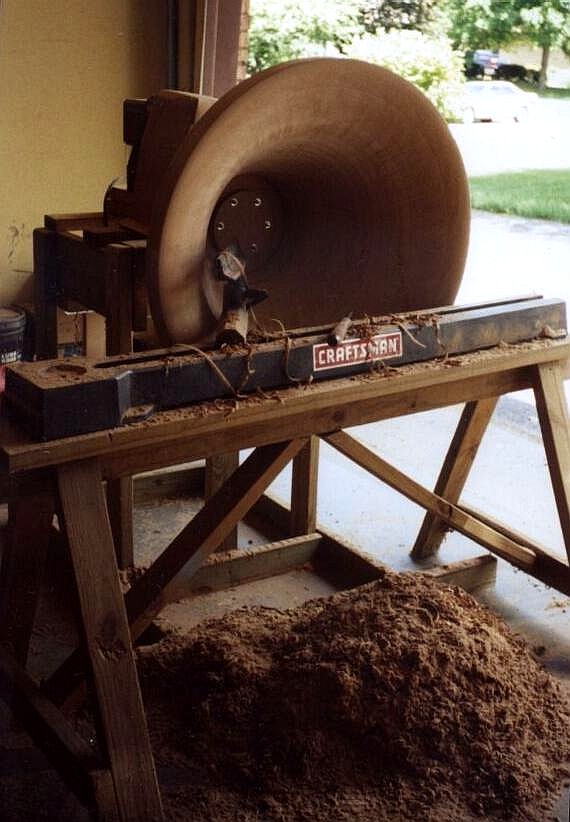

In addition to turning larger round horns I've also made a number of polygonal horns. There was no audible difference between the round horns and polygonal horns. ( 9 sided and 12 sided) I don't know if there would be a difference between even or odd number of sides, but if I was doing it I would go for odd to help avoid any possibility of reflections causing wavy upper frequency response.
- Radian 850pb & Wooden horns.
