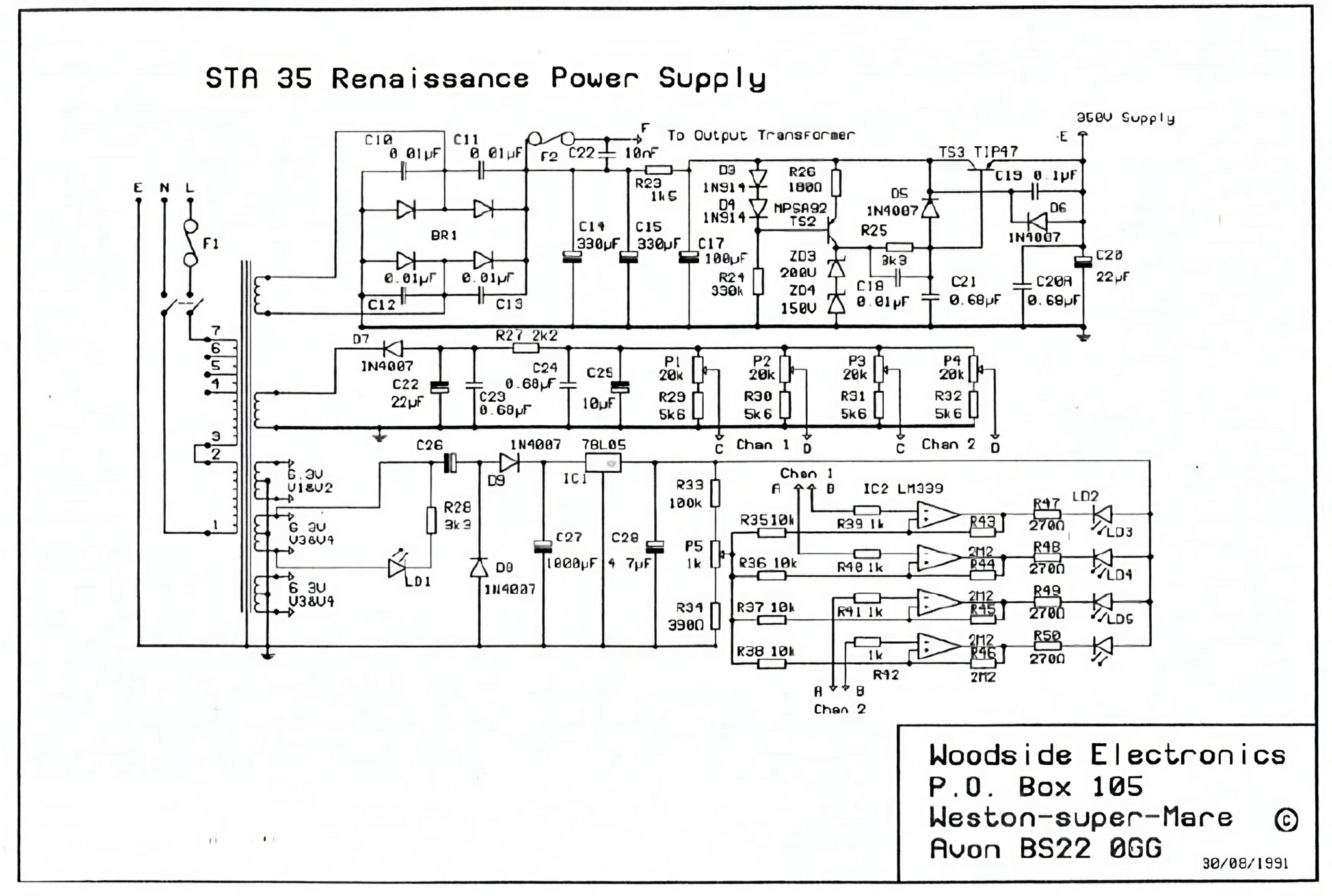

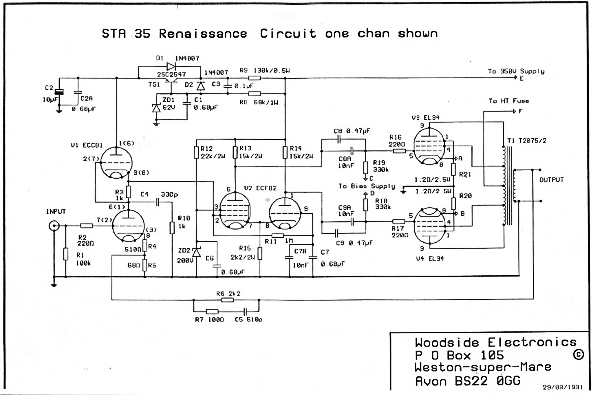

Radford STA-35 different versions
I've noticed there are at least 2 partially different amplifiers called the "STA-35 Renaissance", built by Woodside after Radford went bust (or sold the design?).
One model has ECC88 and the other has ECC81 and some other differences. I've also seen some having a toroidal power transormer.
The date on the bulletin of the ECC88 model seems to be '89 and the schematics of the ECC81 model are from '91.
Does anyone have any info on why the changes have been made?

I noticed that schematics of the phase inverter, V2 has un-balanced gain of the two phases.
The plate resistors are both equal at 15k, but the common cathode resistor is only 2.2k, that is Not a CCS. That stage has some 2nd harmonic distortion.
The un-balanced gain is inside of the global negative feedback loop, so it will reduce most of that 2nd harmonic, perhaps there is some residual 2nd harmonic distortion there, to give a warm sound to the amplifier.
Dopanatoru,
I doubt the phase splitter output voltages are matched.
Here is why:
The pentode grid g1 is driven. That changes its cathode current.
The pentode's change in cathode current is divided into two paths: the common cathode resistor R15 2.2k, and the triode's cathode.
The pentode's cathode current change and the pentode's plate current change are almost equal (the screen current changes too *).
* The pentode's screen is at a constant 200V, so as the pentodes grid g1 changes, the screen current changes too.
But now, there is less current change into the triode's cathode because the common cathode resistor sucks some of it up.
But the triode's cathode current change and triode's plate current change are equal, so the triode's change in plate current is less.
So, more current change into the pentode's 15k plate load; and less current change into the triode's 15k plate load.
More current change in 15k = more voltage change in 15k. Pentode
Less current change in 15k = less voltage change in 15k. Triode.
Un-balanced phase inverter outputs.
It is all about current steering to one 15k versus current steering to the other 15k resistor.
If it was me, I would not count on the pentode's change of screen current to make up for the difference of the pentode's plate signal voltage, and the triode's plate signal voltage.
Just my analysis of the circuit.

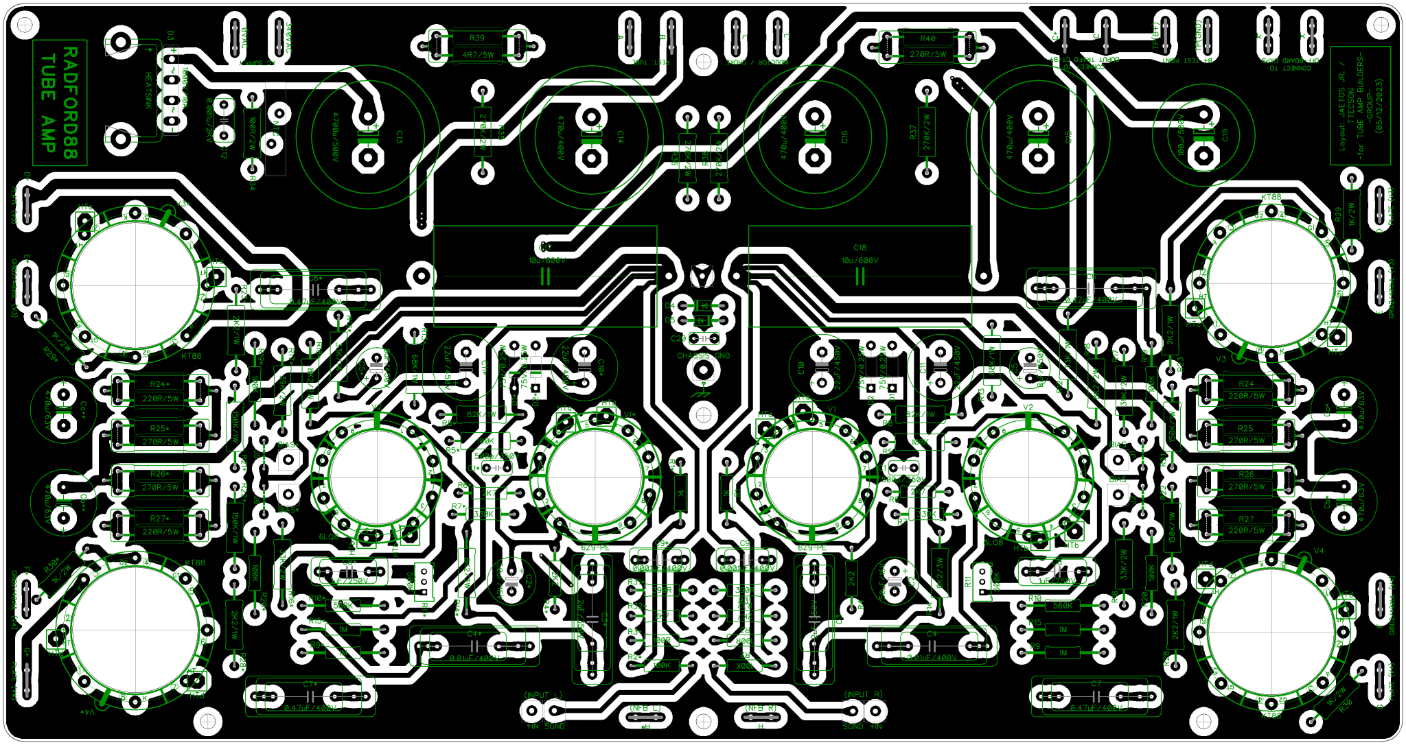

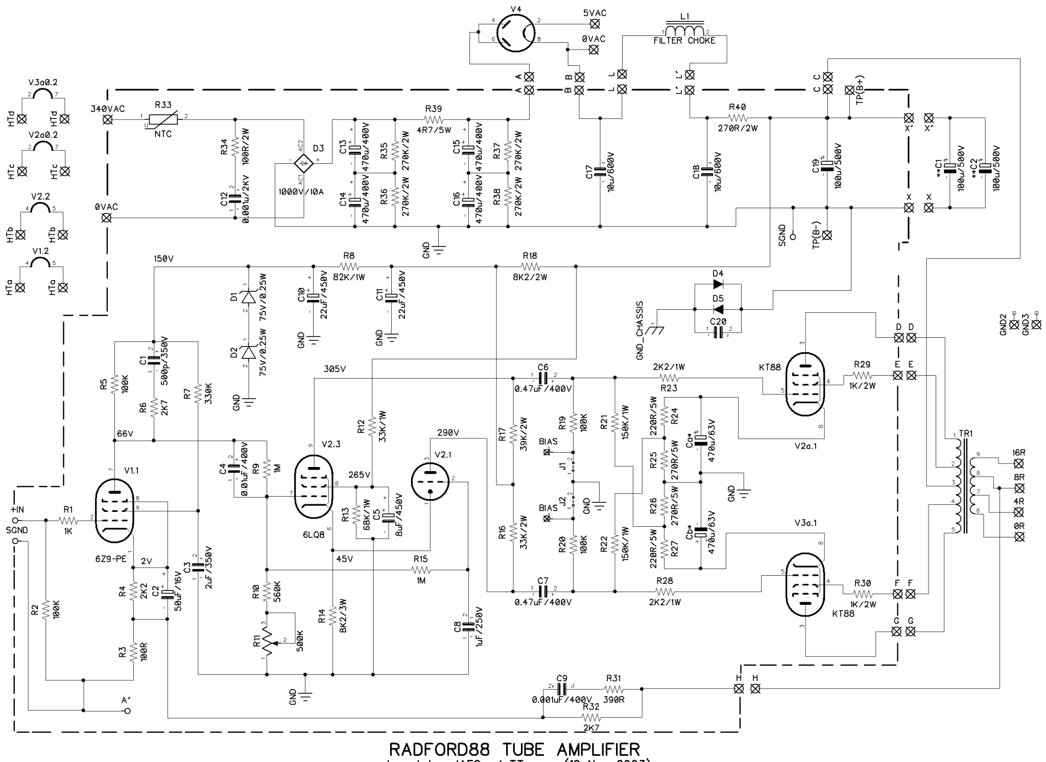

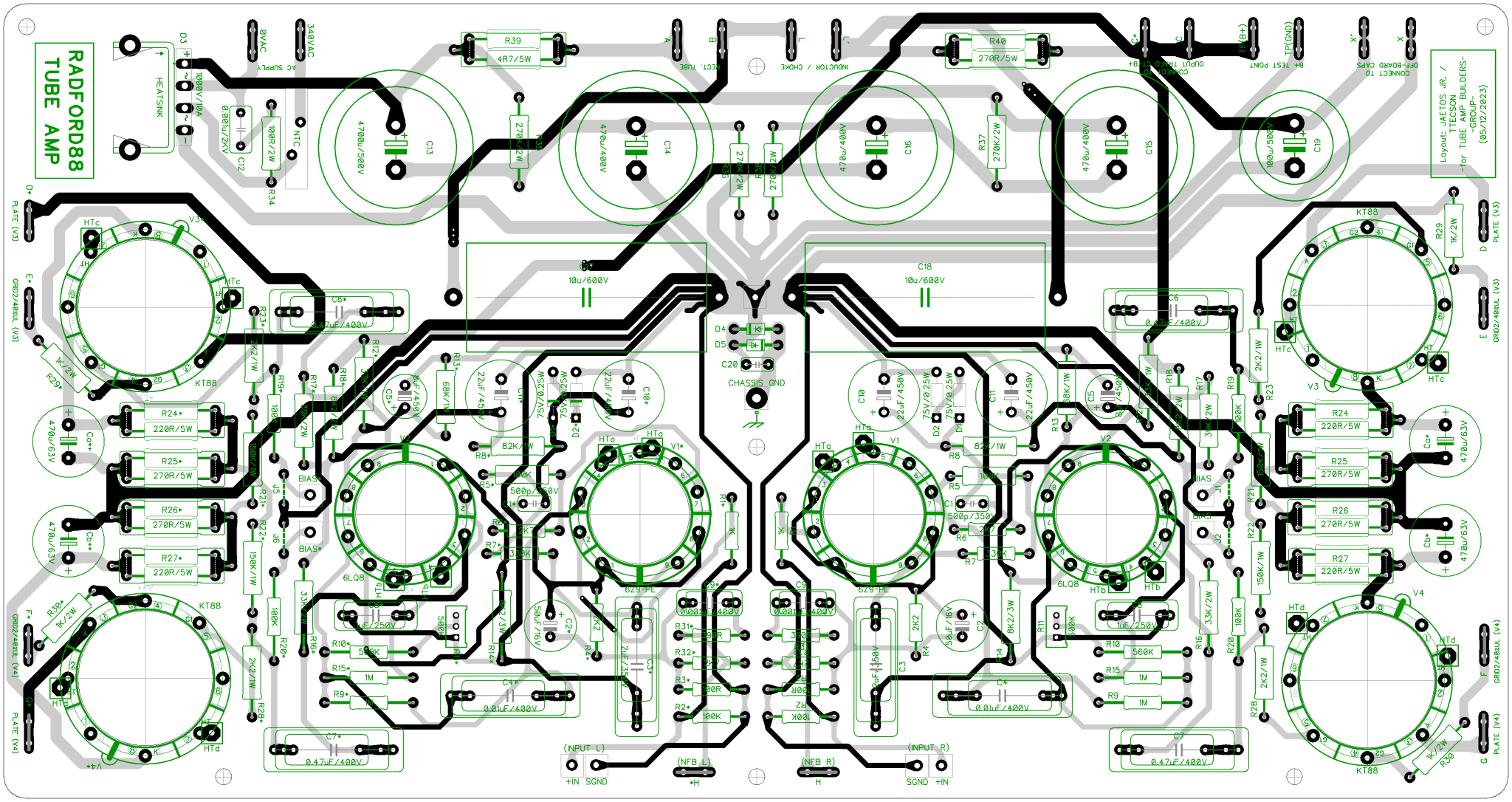

i would rather keep it simple, but this Radford is too elegant to simply ignore....
i would like to find out if it keeps its promises, of course the quality of the irons and the stiffness of the psu counts big too...
i am building it too. pentode provide a lot of gain since this pentode will cathode couple the signal to the cathode of the triode section, it makes sense that this pentode have lots of gains and low cathode output impedance too...
plate load resistors and cathode currents determine gains, but the plate voltages determine output swings...
i think the beauty of this is the non use of sand in the implementations...
my limited experience with sand is that reliability is not that high, for the measly gains achieved, i would rather go all out tubes in the amplification department..
