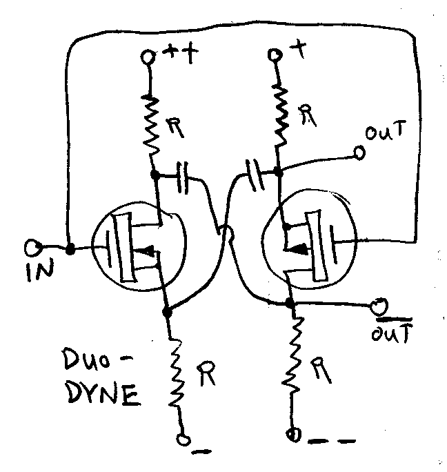

"wouldn't this hobby be dull if only two types of phase splitter were allowed?"
I think I saw something like this posted before on a screen drive thread, maybe with some zeners in the sources to equalize the power supplies. Maybe was Ken? Could call it the Duodyne or Compledyne, or depending on ones mood, the Azodyne splitter. :D
Nicely symmetrical. Could use matched Beta NPN and PNP too, I suppose.
Don

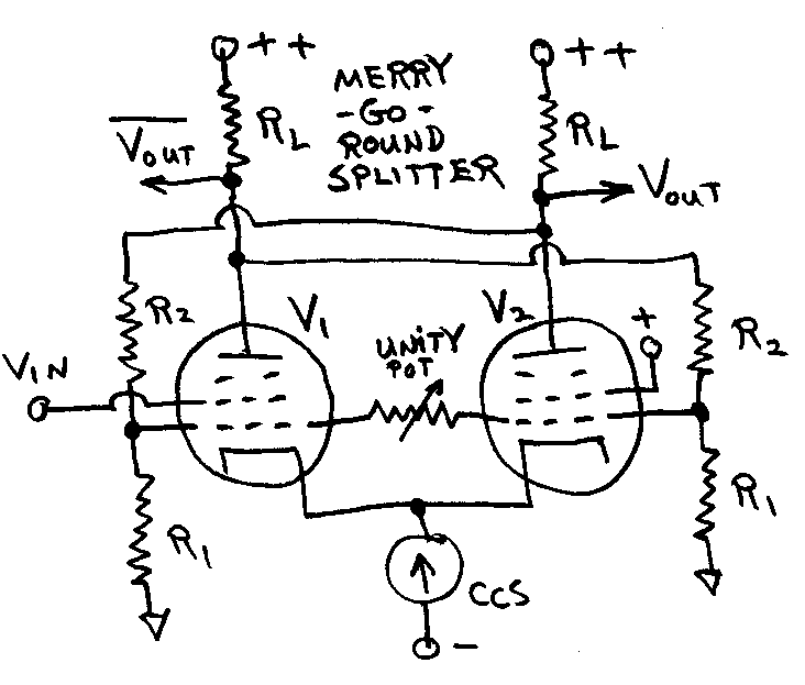

Merry -Go- Round Splitter
This one's got me excited. Looks like the "Old Guys" missed a big one.
This takes it's inspiration from the See-Saw splitter, but goes the whole 9 yards (instead of half way). Two unity-gain inverters are connected in a 360 degree loop, like an oscillator. Then the gain is adjusted to just below unity by a pot. (Unity gain pot.) The closer the loop gain is to unity, the higher the sensitivity (or gain) to tilting the loop, with the signal input put in on one screen grid.
So stage gain (input to output) can be adjusted arbitrarily high, but gets risky up there (oscillates). The input on a screen grid is quite convenient for direct coupling from a previous gain stage.
Don
edit:
May be able to improve the linearity further by connecting the unused screen grid (V2 side) to a resistive divider between V1 plate and a +Vscrn reference voltage. Adjust the divide ratio so the screen signal matches (inverted) the input on the other screen.
Maybe have to put a Mosfet follower off the V1 plate to avoid any current drawn by the divider. Or, just tweek the value of Rl up a little (for V1) to compensate for the divider resistance in parallel with it.

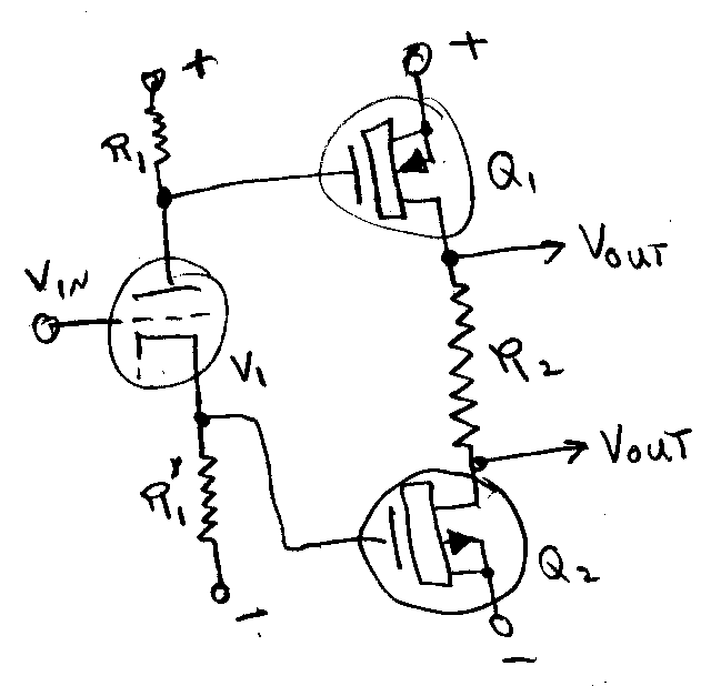

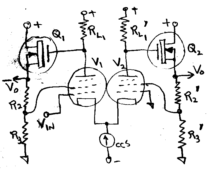

This Merry-Go-Round scheme (dual sub unity gain inverters in a loop) can make a nice center tapped inductor, plate load equivalent, if its implemented with P-chan Mosfets up top. (Drain to gate resistive divider feedbacks, or feedarounds) The P drains just become the loads for the diffl. tubes below (no load resistors). There's no inherent Mu factor with the Mosfets, so they will need source resistors to linearize them, but that just helps reduce the gain down to unity anyway.
And it could even be used as a stand alone splitter up there too, for that matter. A very useful circuit.
