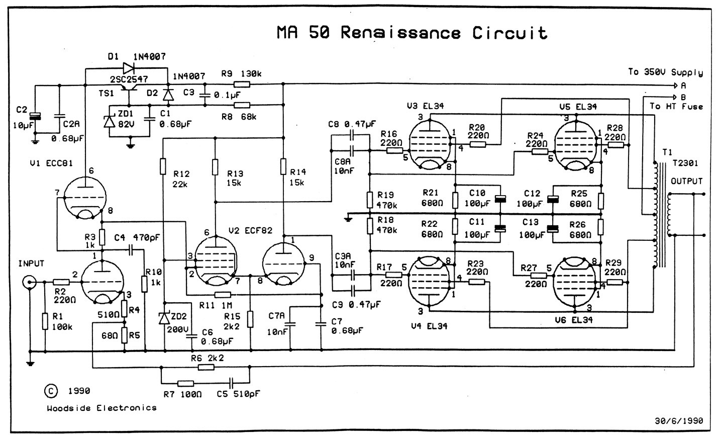

I suggest to disconnect the feedback loop just for the notes of Kay.
If without FB it stay quite, is it possible to check the voltages on some point of the circuit and, in case, take some lab mesaurement

What was the load to the amp when this happened? Did you leave the speaker terminals open? Note that almost any tube amp needs to be loaded when powered up.
I'd also replace the grid stoppers by resistors of at least ten times the value.
In fact there are ratings for the maximum grid to cathode resistance for the EL 34. Philips datsheets say 700 kOhms for autobias and 500 kOhms for fixed bias. So, these 220 kOhms are well in the ballpark.

Did you mean change the Grid Resistors from 470k to 220k?
If you do that, you should change the coupling caps at the following ratio:
470/220 = ~ 2 times the capacitance. That will make the low frequency pole the same as the original when you use negative feedback.

Second on reducing R18 and R19. There are two EL34 per grid leak R so the value should be half. As is, it is like 1M on one EL34 (out of spec)

Yes sorry, I meant the Grid to ground resistors (R18/R19) have been changed to 220K, while the Grid stoppers are left at 220R.

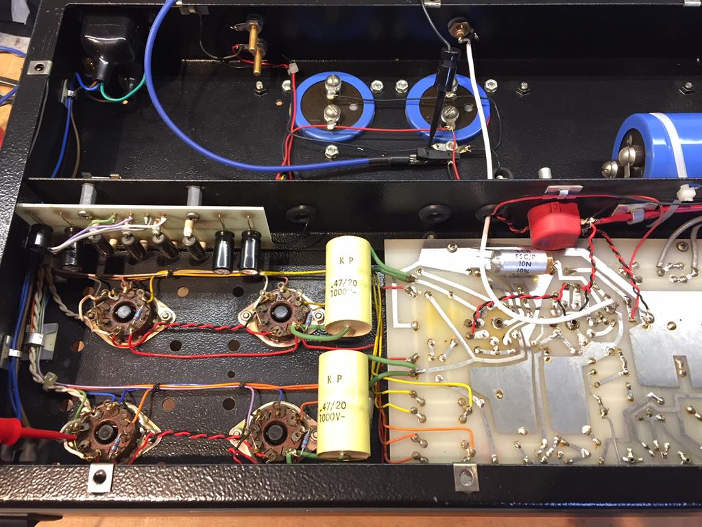

Hi, I am now done with both amps, and they are working perfectly.
I have attached some pictures.

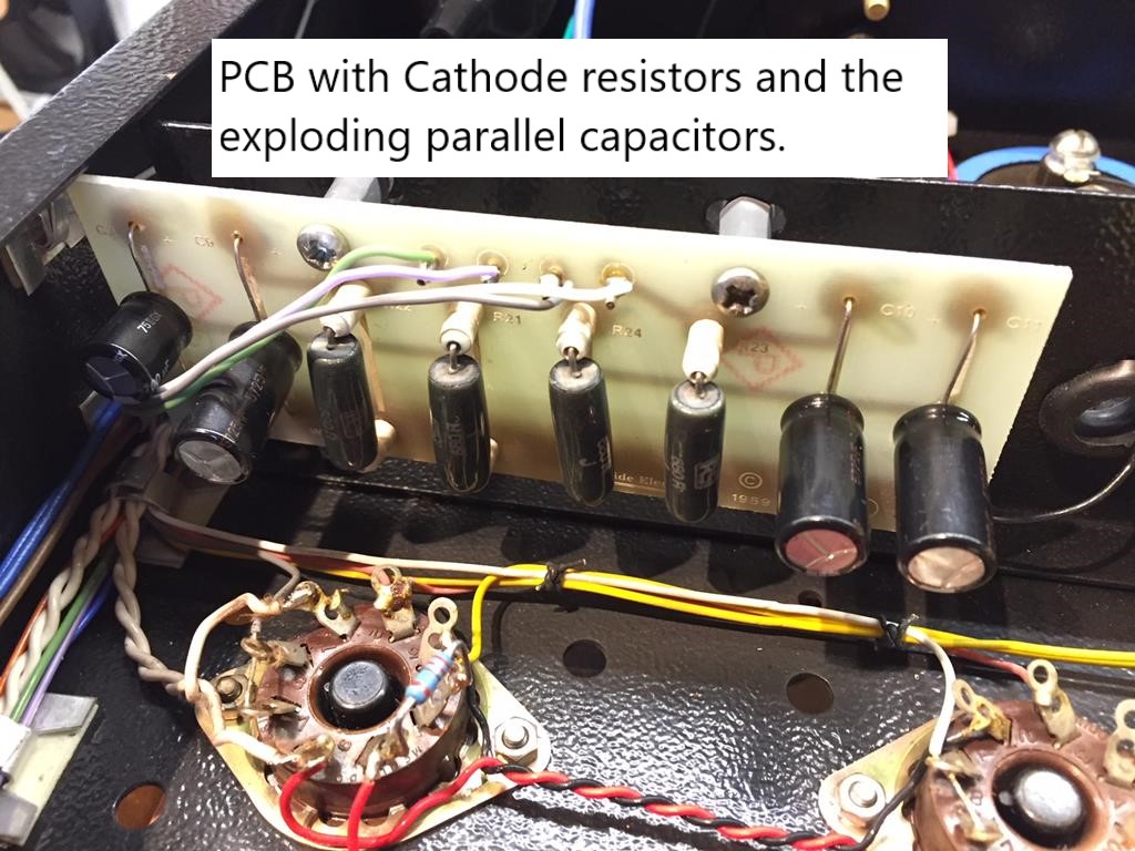

All the critical caps and resistors have been replaced, as well as all the EL34 tube sockets for good measure.
Both measure very close, with Bias of 44-46mA per tube (about 18w each).
Max output is 50W@0,3% THD into 8 ohm load. Distortion residual looks quite nice, a bit of H2/H3 mix.
Frequency response is 0dB from 20hz to 10Khz. -1db at about 50Khz.

gain 450 / gain 31 = 14.5:1
14.5:1 = 23dB negative feedback, within range of quite typical feedback for that era.
You are still wondering what made the circuit blow up, how about the fact that each pair of 2 EL34 tubes in parallel had a grid leak resistor of 470k Ohms (equivalent to 940k Ohms per tube).
What if the tubes started running the grid voltage slightly positive?
Then more current and hotter, more grid voltage, more current and hotter, more grid voltage, Bang!
Perhaps there was more current than you thought in one or more of the cathodes, if one of the electrolytics was leaky.
The voltage could still be 33V, but at more current. The tube gets hotter, draws more current, gets hotter, draws more current, . . .
And how about the possibility that one of the coupling caps went leaky, but only under rising ambient heat and driver plate voltage (not able to be seen under ohmmeter voltage, and normal room temperature).
