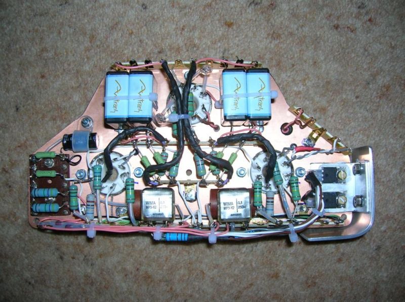

If I was going to rebuild a project,
I would probably do something like this..(thinking of the shape)
https://www.google.co.uk/search?q=radford+tube+amp+modern+build&biw=1280&bih=585&source=lnms&tbm=isch&sa=X&ved=0CAYQ_AUoAWoVChMIw-6E4sLsxgIVSuwUCh1KvAAe#tbm=isch&q=papworth+valve+amps&imgrc=Uf-DNcKUs-CivM%3A
Probably with mixed case Oak and brass..but each to his own..

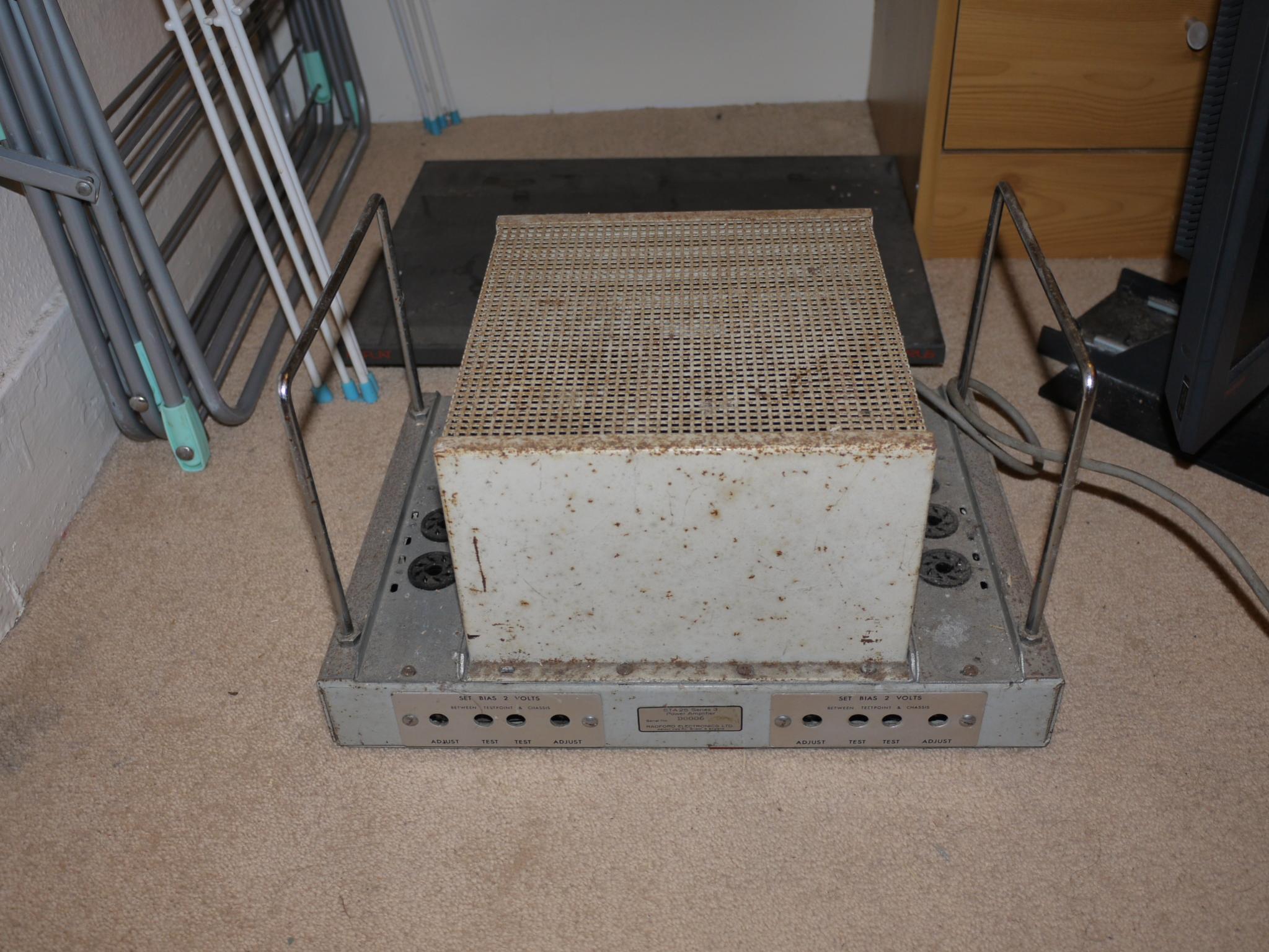

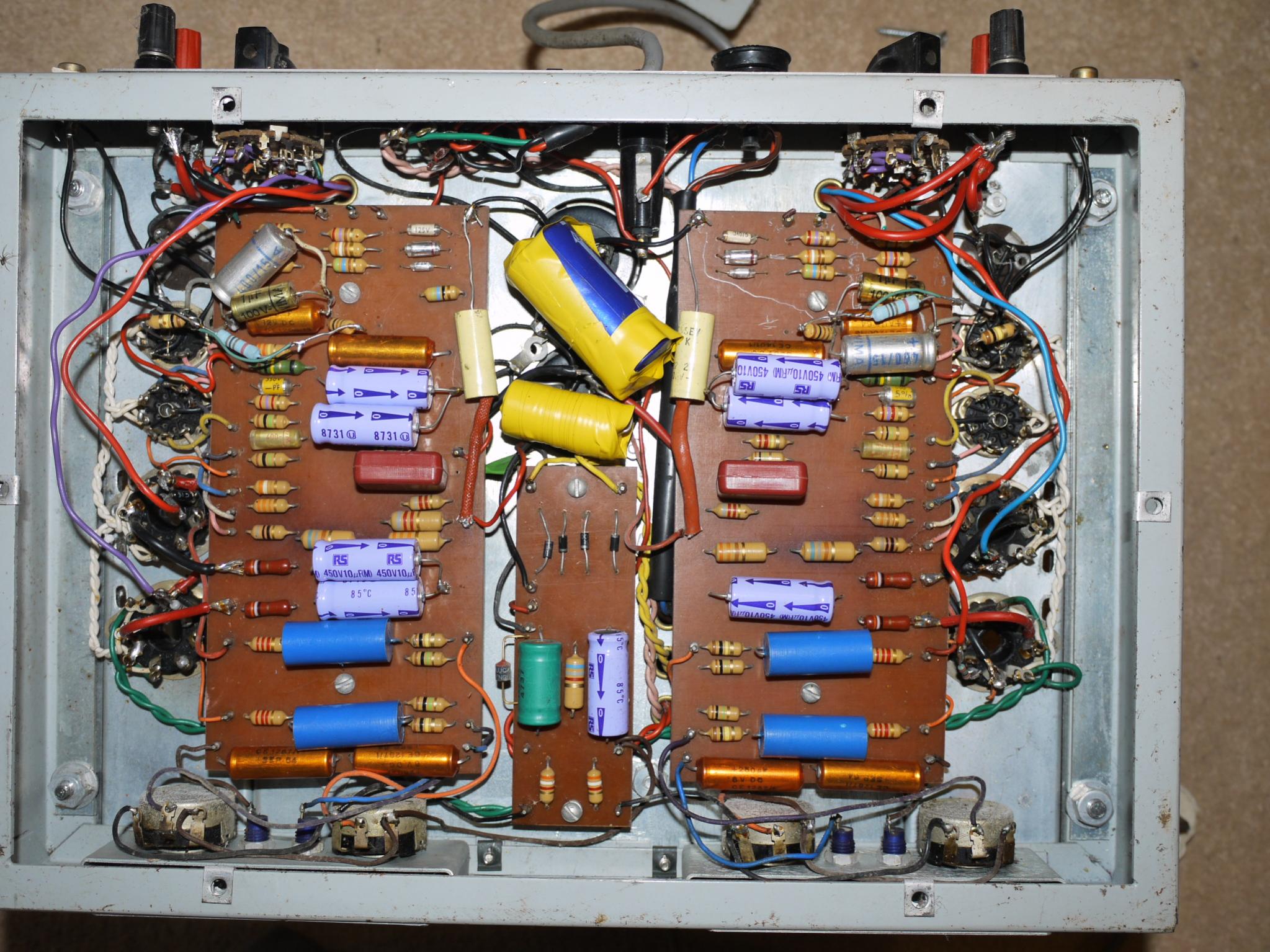

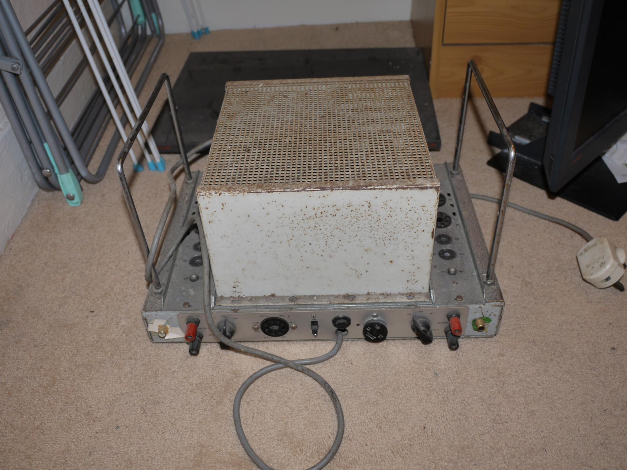

Couple of pics.
And a smoking gun. One of the ground studs came loose on the HT supply. Certainly consistent with the charred EL34s I ended up with. I guess a cack handed conversion to triode operation followed by shipping to USA and it dropped off.
Ah the joys of youth. To think the person who butchered that in 1988 is now an IEEE fellow 🙂.
There is actually more real estate there than i remembered.

Well the IEEE fellow would have to unbolt as much as possible so the chassis comes away leaving a pile of bits and top plates complete with circuit boards. Taking the pots out without disconnection.
Then a new powder coat and take it from there. 😀
No institute of electrical engineers would be able to just look at it.
OK here is your task for today strip this thing and get the chassis reconditioned.
Next while its away check everything on the circuit boards.
Clean the pots with servisol and replace all the caps. LMAO
Are you sure the output Tx's are any good?
Put it all back standard change the caps and get it working even use the old valves and see if you can get anything out of it.
Remove the mods..get a known situation ie all the transformers are working by putting all the circuit boards into normal standard situation.
Once its working you can choose to sell it or do it up.
The two PCB's look the same strip one out and replace the caps and put back standard. Then do the other side..
When it stopped working did both sides fail? or just one side.
You could make a really good job of the boards with a view of using them in the final build. Then if it turns out the transformers are shot at least it hasn't cost very much just time.

Use a couple of cheap speakers to test it..think of it as an old machine it either works or it doesn't..
Its not to bad inside I have seen much worse..recon chassis and rebuilt boards new power leads and earthing should be good to go!
Assuming the initial test is OK. If the PVC has gone hard then you could rewire but I wouldn't entertain anything until its been running.
