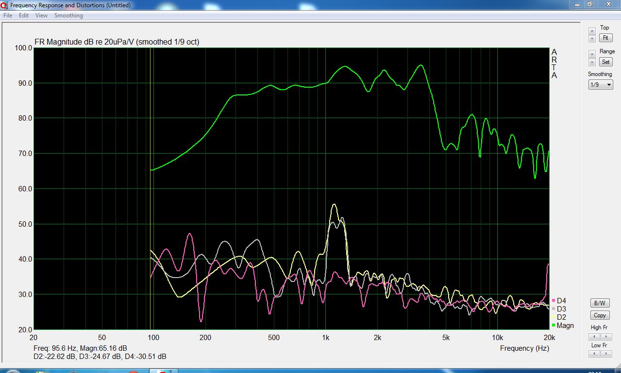

I found this measure, it's not me (driver alone, mike about 10 cm from the exit).
I will take the internal measurements and angles of the 60x40 horn, I will put them here, in case you would like to do it in wood.

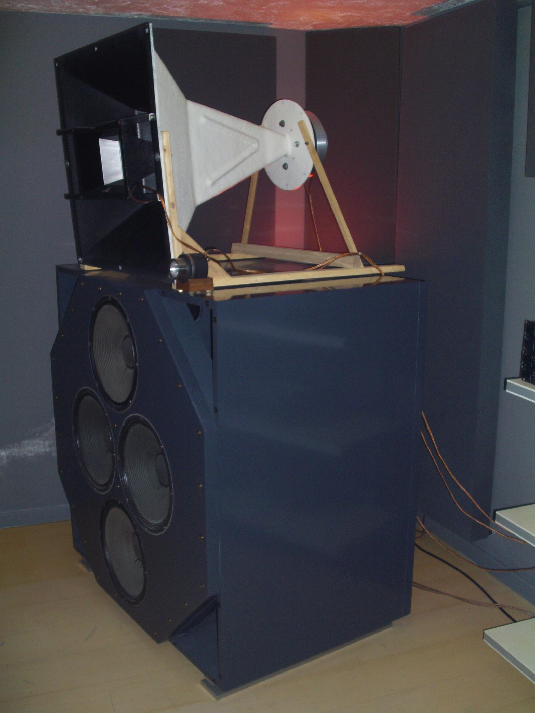

My woofers are fostex L475 (8), with a box similar to a jbl 5674 , but with 4 triangular vents in the corners for an area greater than 2 woofer, the volume of the box is also higher because of the low qts.
I have a lot of material fostex because I started with this brand, I deviated for the driver with R-H, I do not regret it, but in general I keep all my equipment.
On the CBH horn, I installed my fostex driver modified with a radian membrane, I simply wanted compared with the ssd, the result is obvious, this driver 2 inches, could be called x, y, z, that would not make any difference, I only remember one thing, the unmatched presence of ssd.
It is for this reason that I was dubitative to make the horn that I put in pdf.
For horn, with hornresp, I added extensions to the mouth of the CBH, it extends and it raises a little low frequency cut, but it remains a hole of about 2 db, making rounded edges, he should improve, but I have not managed to do it, I do not know if it is possible, I should ask the question.

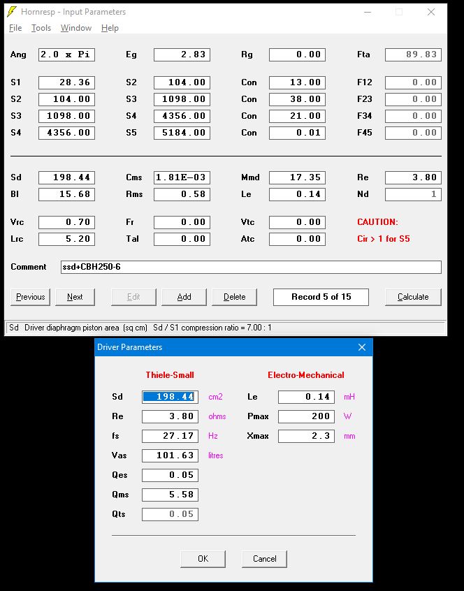

I made a drawing with the angles of the horn, if you want to make it, so it takes 10 pieces of wood + 4 flat edges for the mouth and not 8, because there is an angle on the verticals walls near the hole (see the pictures), on the other hand the top and the bottom "S2-S3 in hornresp" it is a single piece.
For rounded edges, I think you have to extract the txt file from hornresp, then, empirically, either with a drawing software or even by hand, draw the edge, take the measurements, manually add the lines to the file , reimport it to see if it brings anything.
I put a file with calculated values of the driver, they should be fair, even if the parameters seems bizzare.
