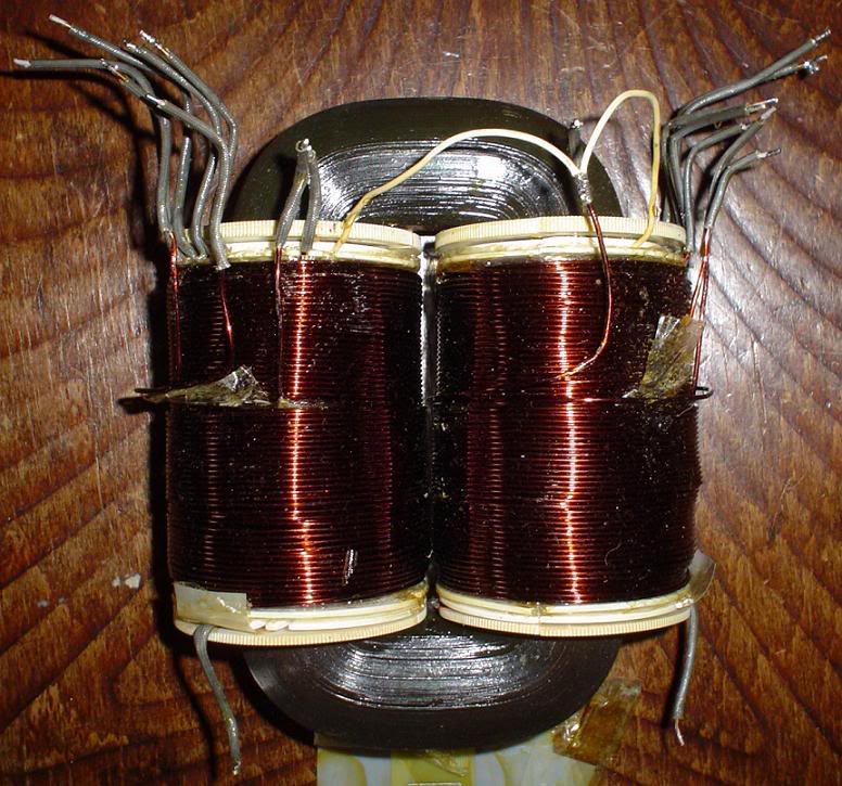

This manufacturer of Rcore transformers also appears to say that there are two bobbins (not four), one bobbin placed on each long leg of the Racetrack, with the primary windings on one bobbin/leg and the secondary windings placed on the other bobbin/leg:

The other unique feature of R-cores is the use of Bobbins in two parts. The winding is done on special round bobbins on two parallel legs of the core. This ensures complete isolation between the two windings and satisfies safety standards. In comparison with EI Transformers of same capacity, the R-core transformer is compact (nearly 40% smaller) and has a low temperature elevation. Leakage flux of the R-core transformer is about 1/10th of conventional transformers which permits the equipment manufacturer to place the transformer close to critical electronic components. The balanced winding & low leakage flux ensures low noise of the transformers. This makes R-Core transformers suitable for use in noise sensitive equipment.

Rcores should have half the primary and half the secondary on each limb.
Some to save money may put the whole primary on one limb and put the whole secondary on the other limb. That is NOT the way an Rcore should be manufactured. Doing this would make the construction "unbalanced". Yet one claim for the superiority of an Rcore over other types is that they are "balanced". This "balanced" requires that the primaries and the secondaries are split between the two limbs/bobbins.
Shilchar place half the primary and half the secondary on one bobbin on one limb and place the other half primary and the other half secondary on the other bobbin on the other limb.
I have three of their transformers and as mentioned in my previous post I have reported on the stupid phasing of their "colour codes" where they have mixed up the half winding colours and given no instructions on how to wire them correctly !!!!!!!!
one bobbin placed on each long leg of the Racetrack, with the primary windings on one bobbin/leg and the secondary windings placed on the other bobbin/leg:...................
No. Each limb/bobbin has both a primary winding and a secondary winding.

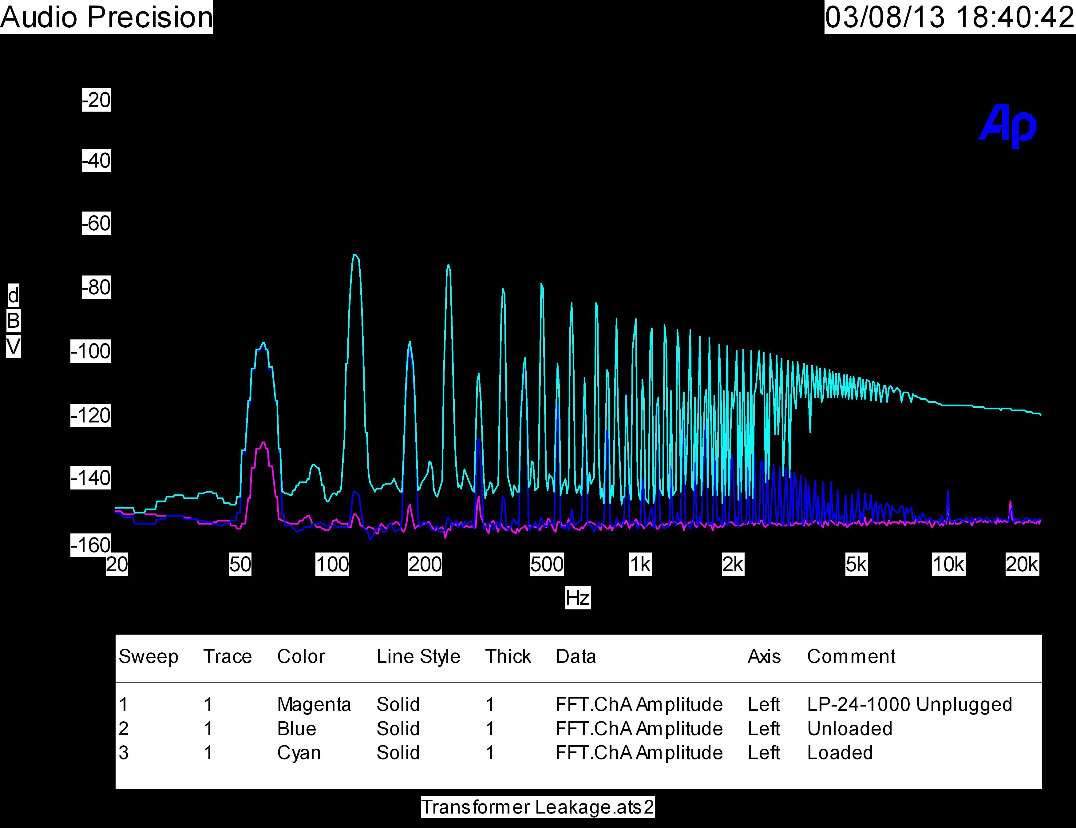

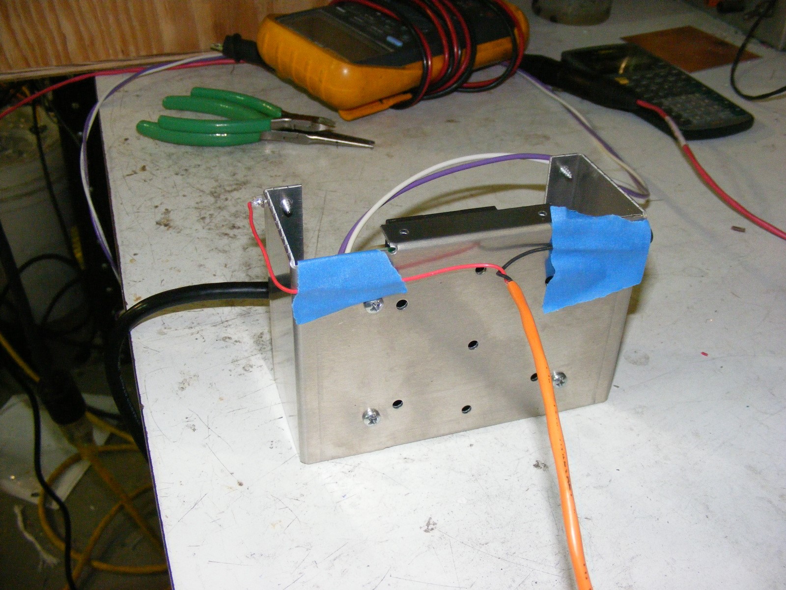

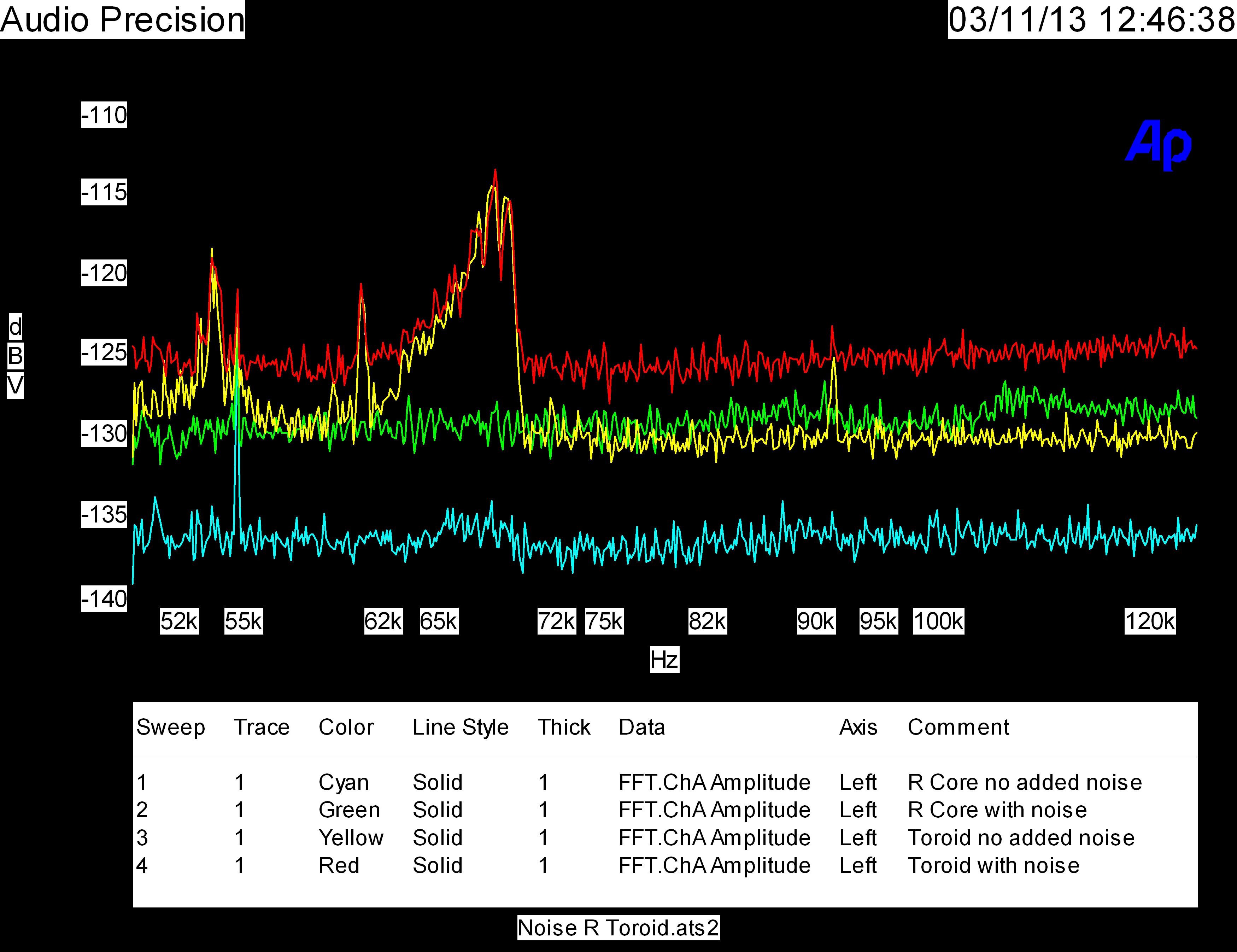

We are talking about flux leakage. That induces voltage into nearby components and the chassis.

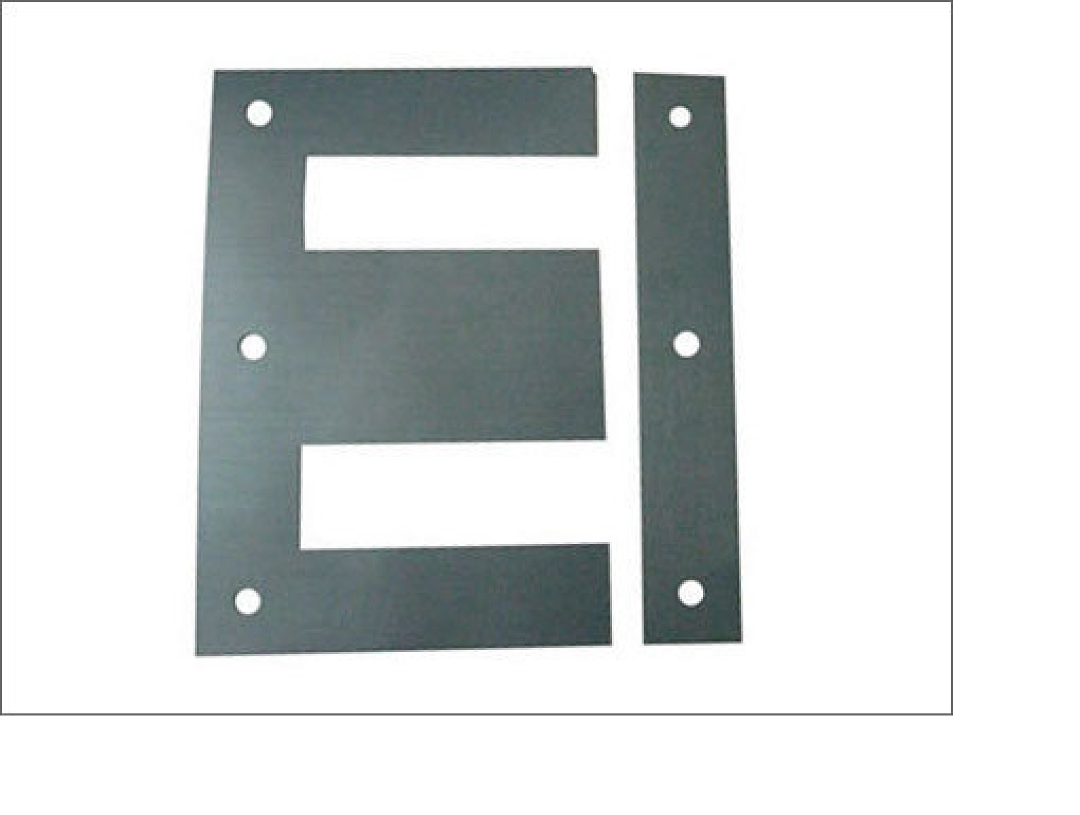

Attached are four pictures.
The first shows classic E-I core pieces. Note the holes. They are used for mounting but the size and location is to make sure the flux distribution is uniform.
The second shows a small transformer mounted to a chassis with leads connected to measure the voltage induced into chassis from the transformers flux leakage. Many transformers were measured this way.
The third shows the actual FFT of the flux leakage measurements.
The final one shows the output noise from various types of transformers with fed from the AC mains with noise added.
