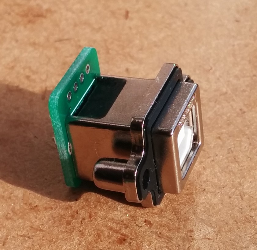

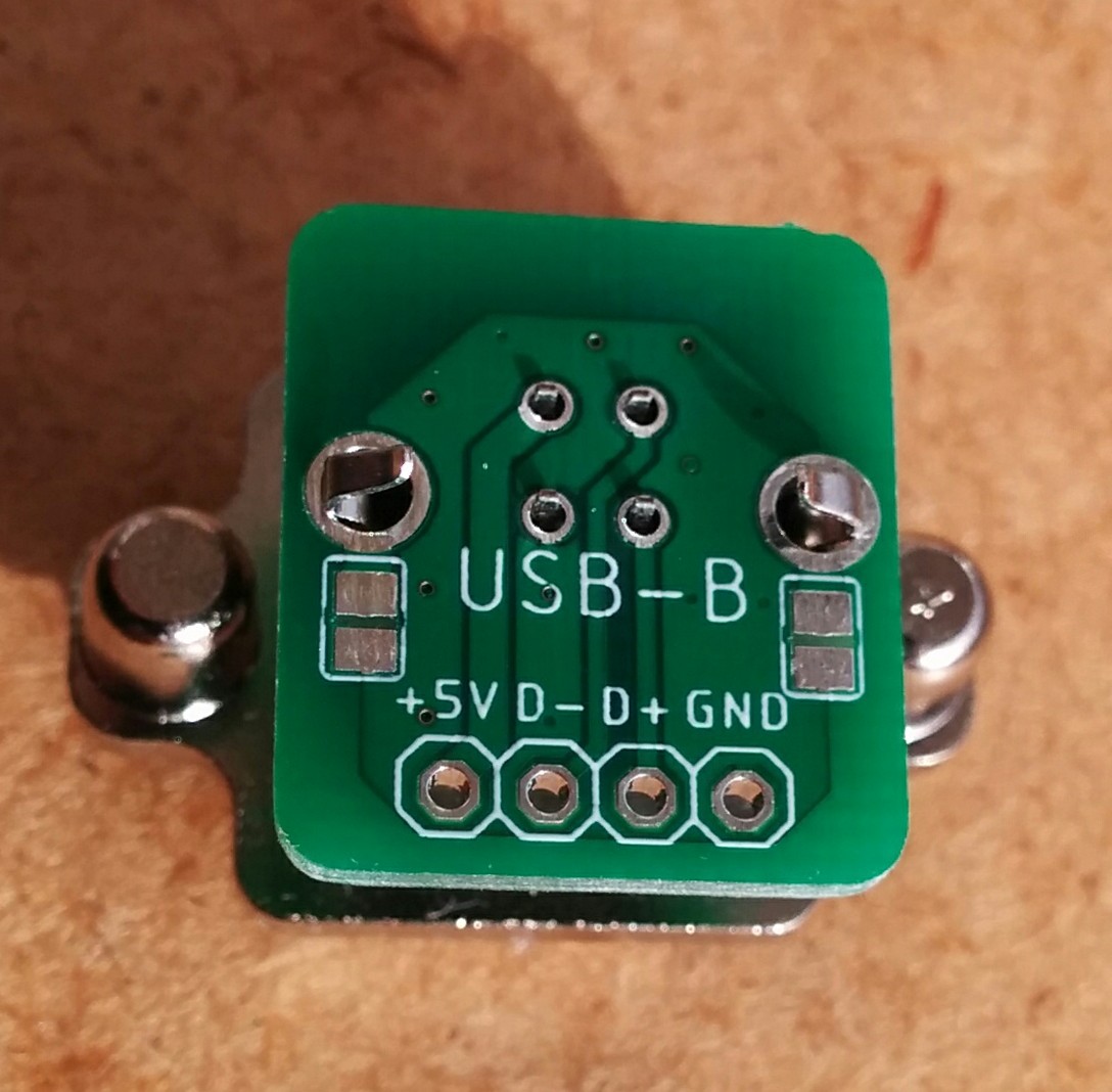

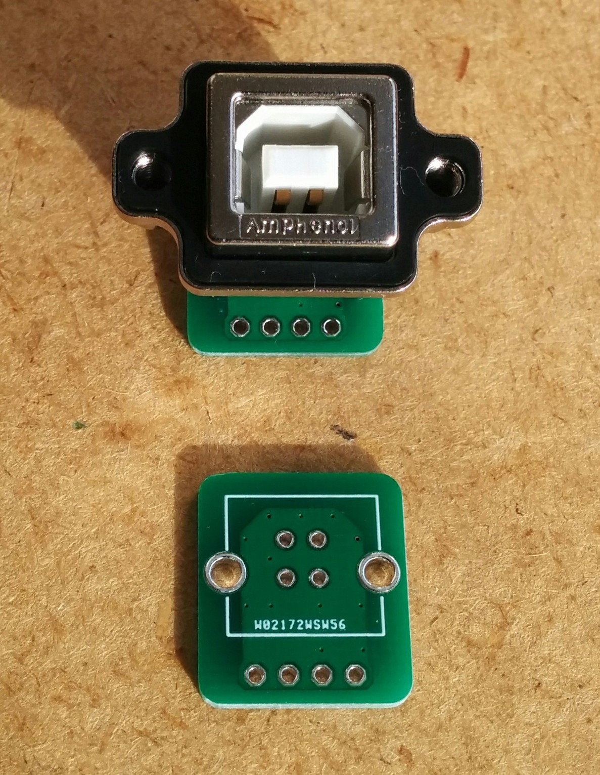

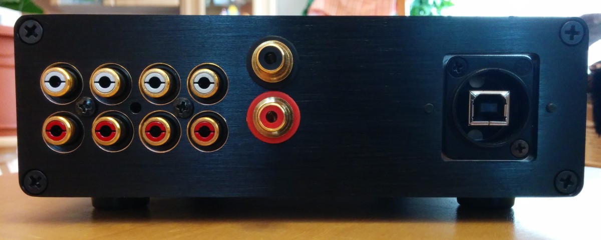

To minimize the space the USB input takes inside the chassis I found a nice rugged USB-B socket from Amphenol (mouser part number: 523-MUSB-D511-N0). To make connection convenient I also designed a small adapter PCB for it (see attached).
