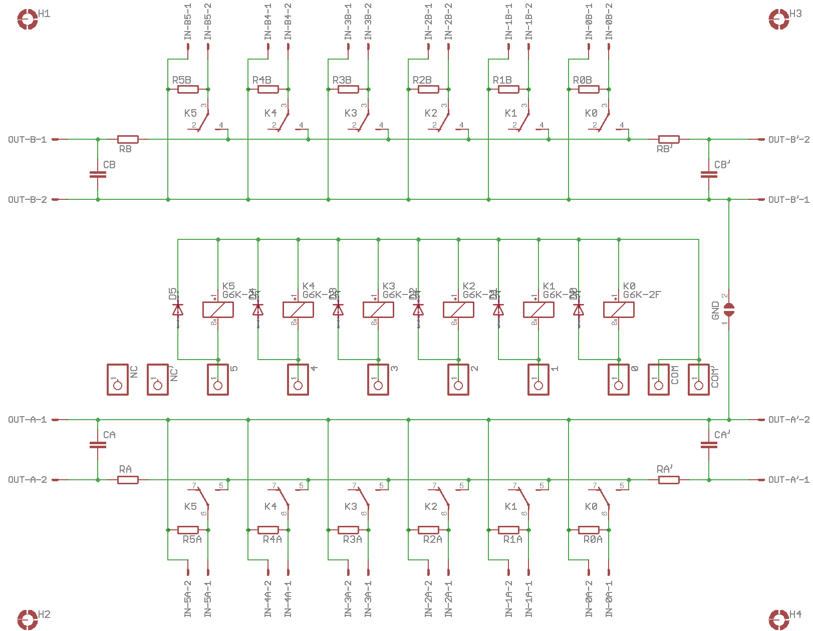

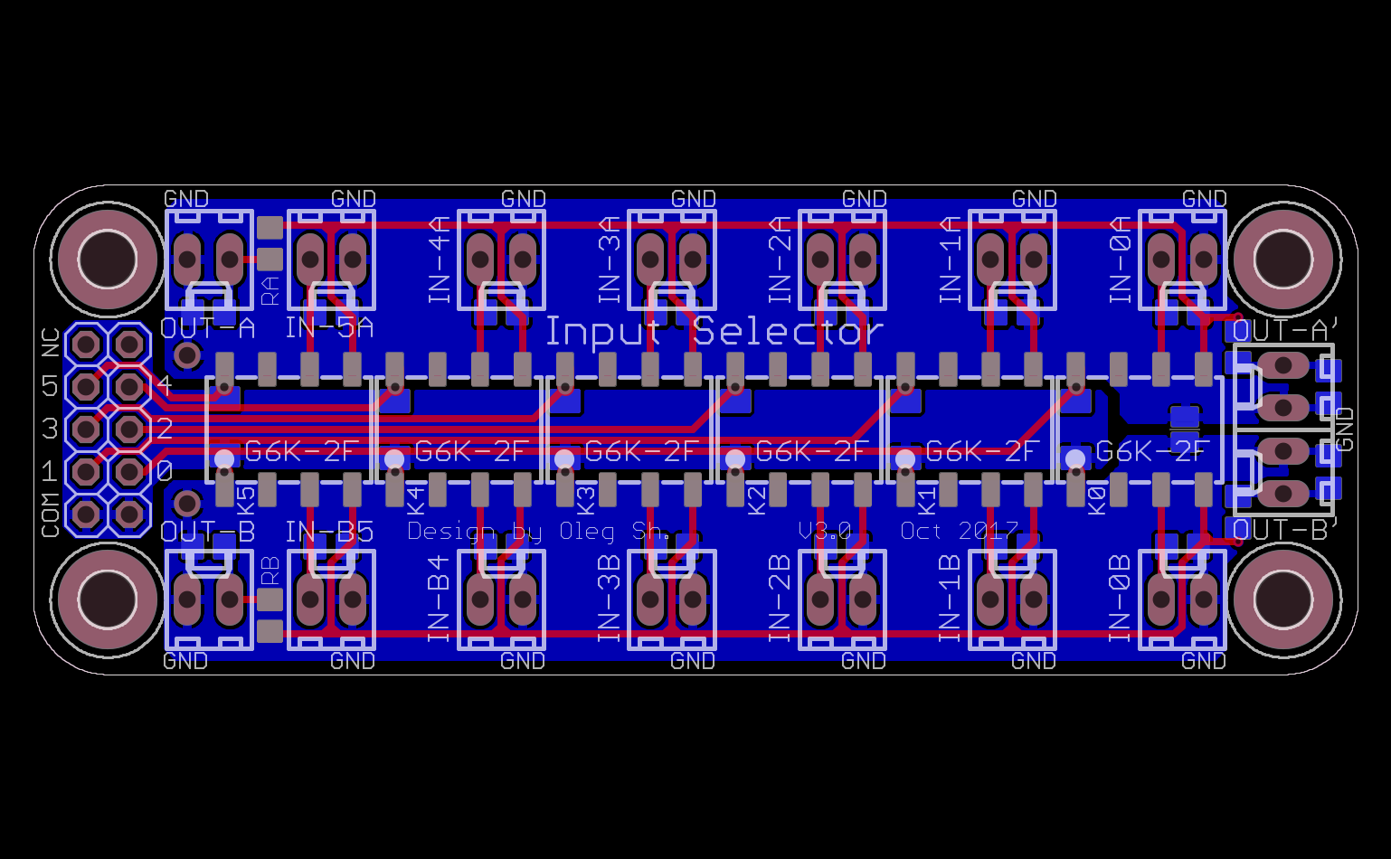

I decided to better "align" input selector with the attenuator PCB. This resulted in a 6-way input selector with the same footprint as the attenuator. I've added one extra pair of outputs to the input selector PCB which are in registry with the attenuator inputs. Depending on the actual chassis layout one or the other output pair of the input selector can be used.
Oleg
