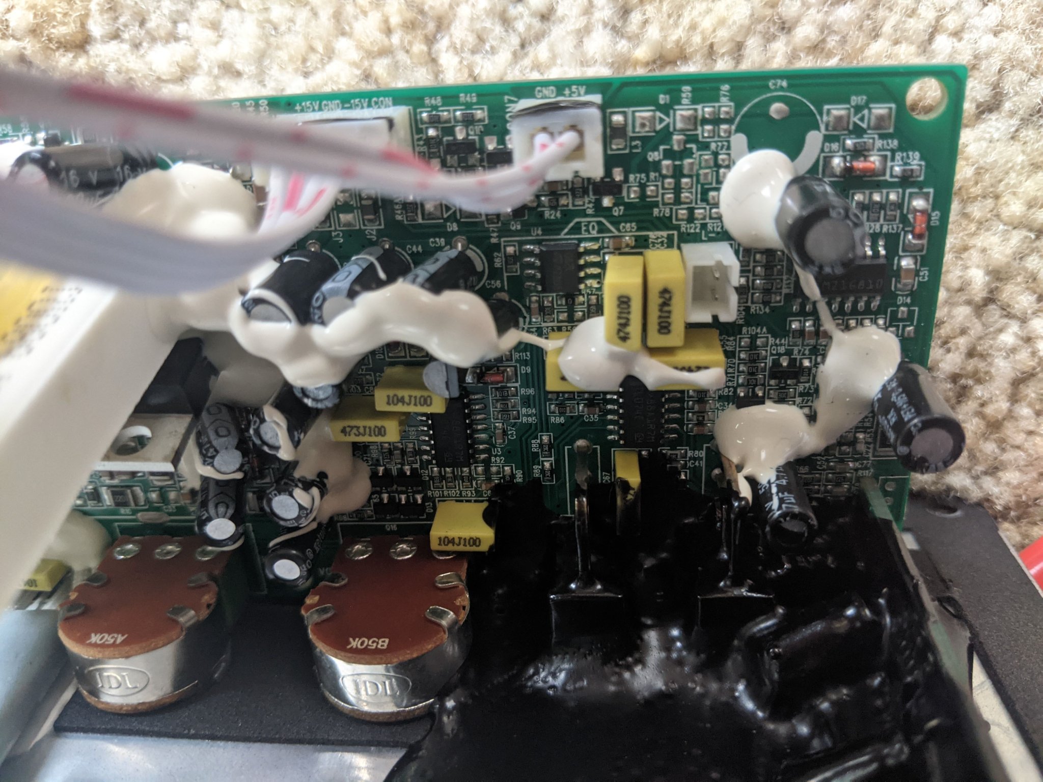

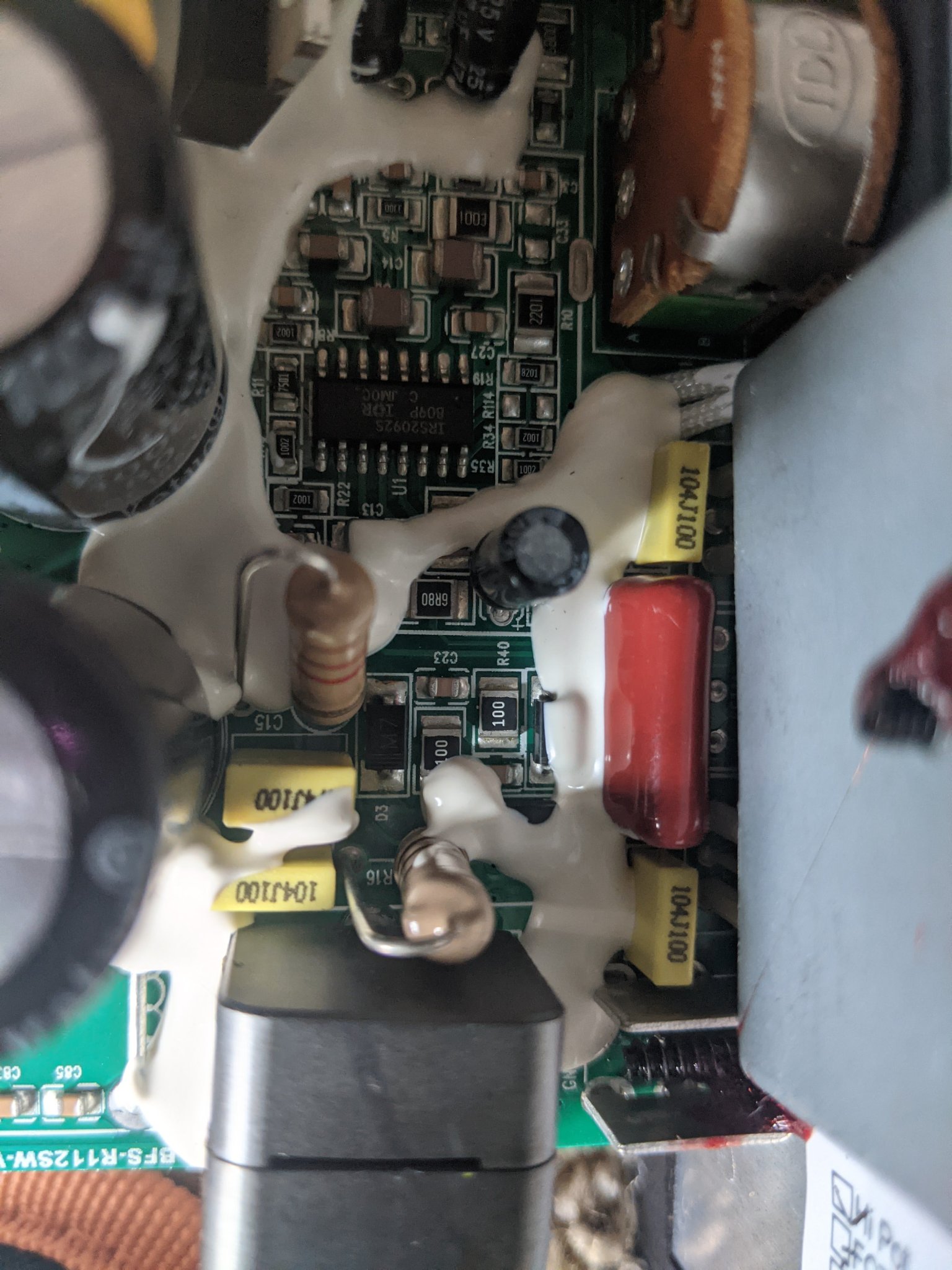

came home to my R-112SW not functioning. was very upset, i love my subwoofer. discovered it was left in the 'on' position when i usually leave it on 'auto' 24/7, definitely going to heed more caution and try to turn it off every night from now on. unplugging it brought it back to life for the night, until i get up the next morning, LED is off and it was not functioning again. i opened it up and everything looks good? caps testing good? even the usual suspect resistors look good? i put it back together after brushing the dust off the board and doing those tests and it's working again. i'm left wondering what exactly is going on here?

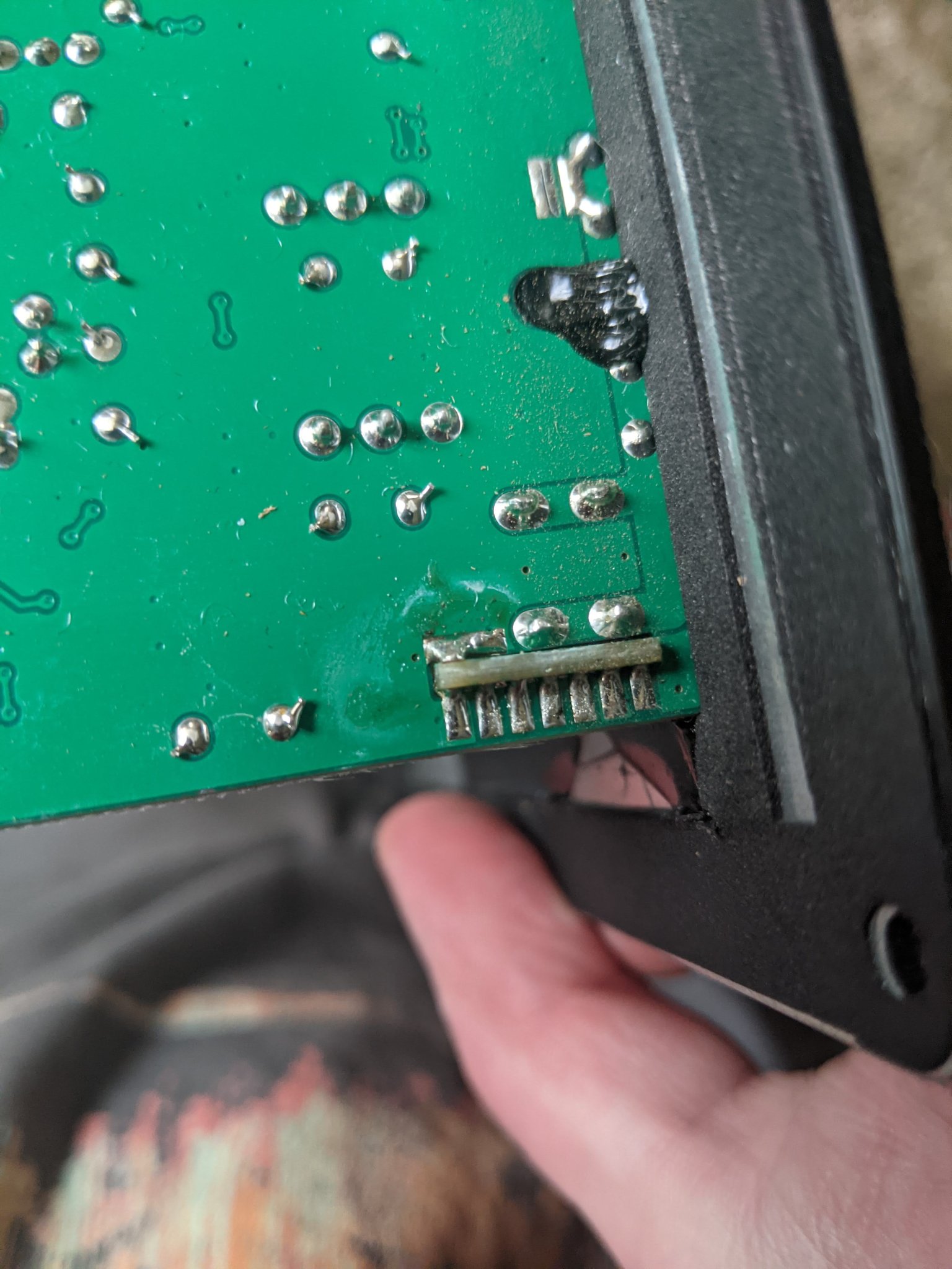

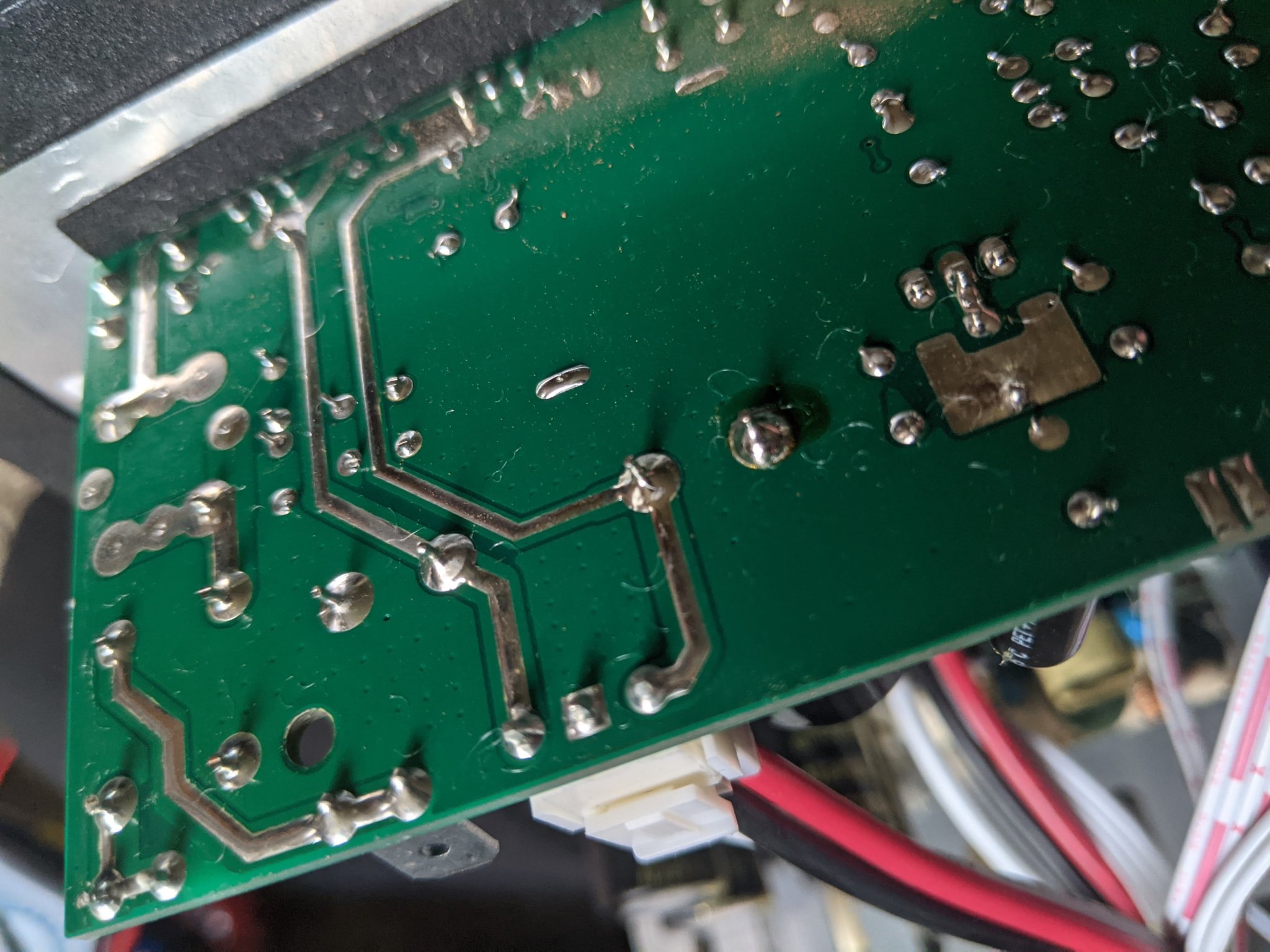

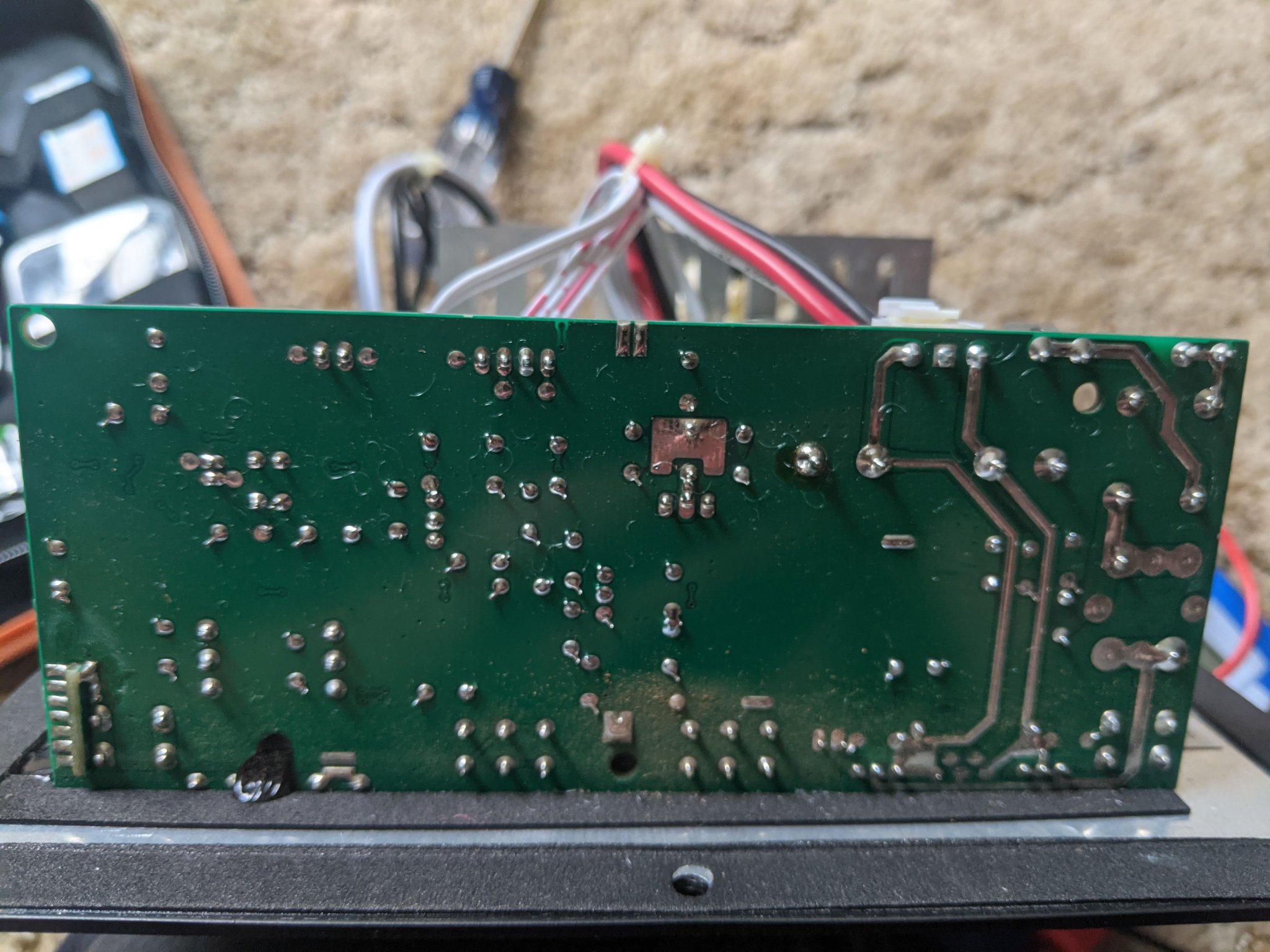

going to leave all these photos here, maybe they will help someone else. good luck everyone.

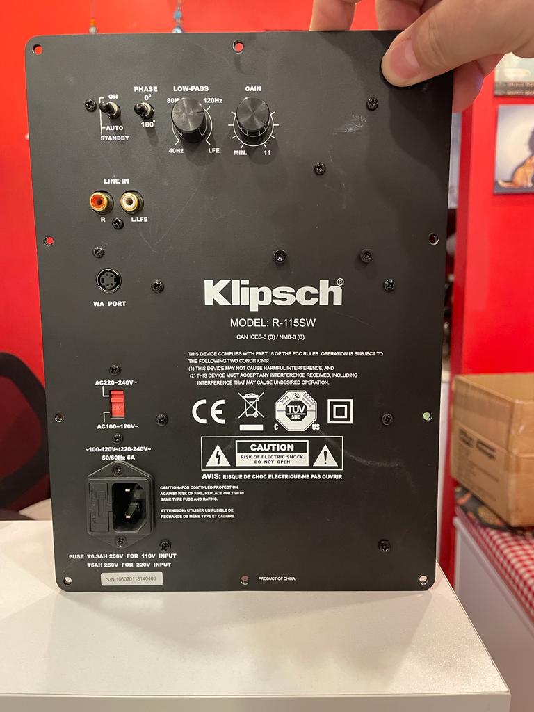

My subwoofer power cuts off at average gain. Please help.
