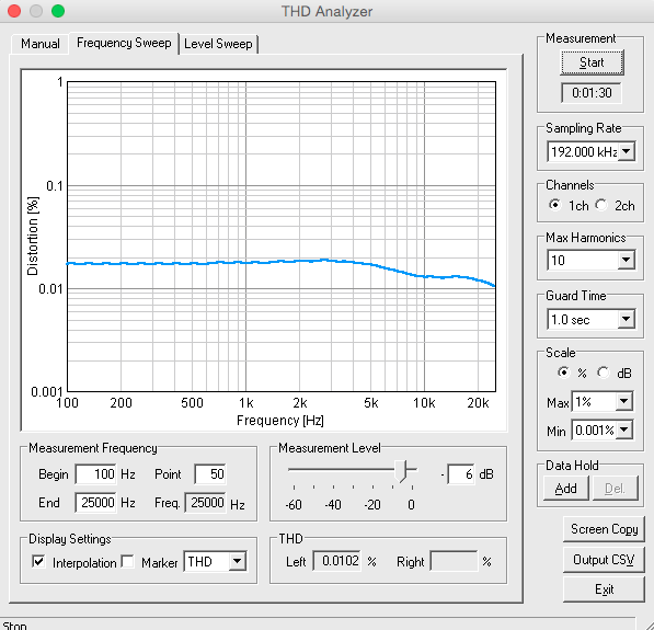

Any sound examples? Looks interesting.
dont think it would get through as set up.
i have a song listen to frequent, mp3 320k tested using same speakers KEF UniQ Q10 but two in parallel for 3 ohm load.
i can now hear a cymbals track had never noticed before.
Also no 'fatique' after many hours listening.
The tilt stack is super. Everyone finds a sweet spot.
