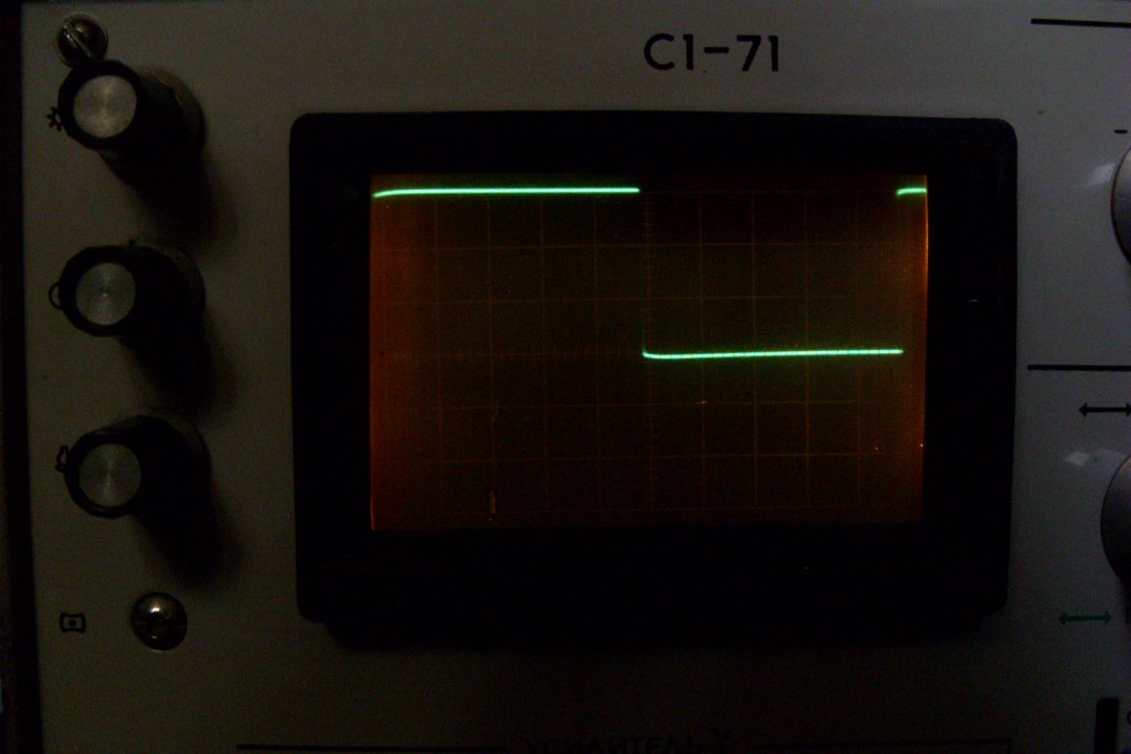

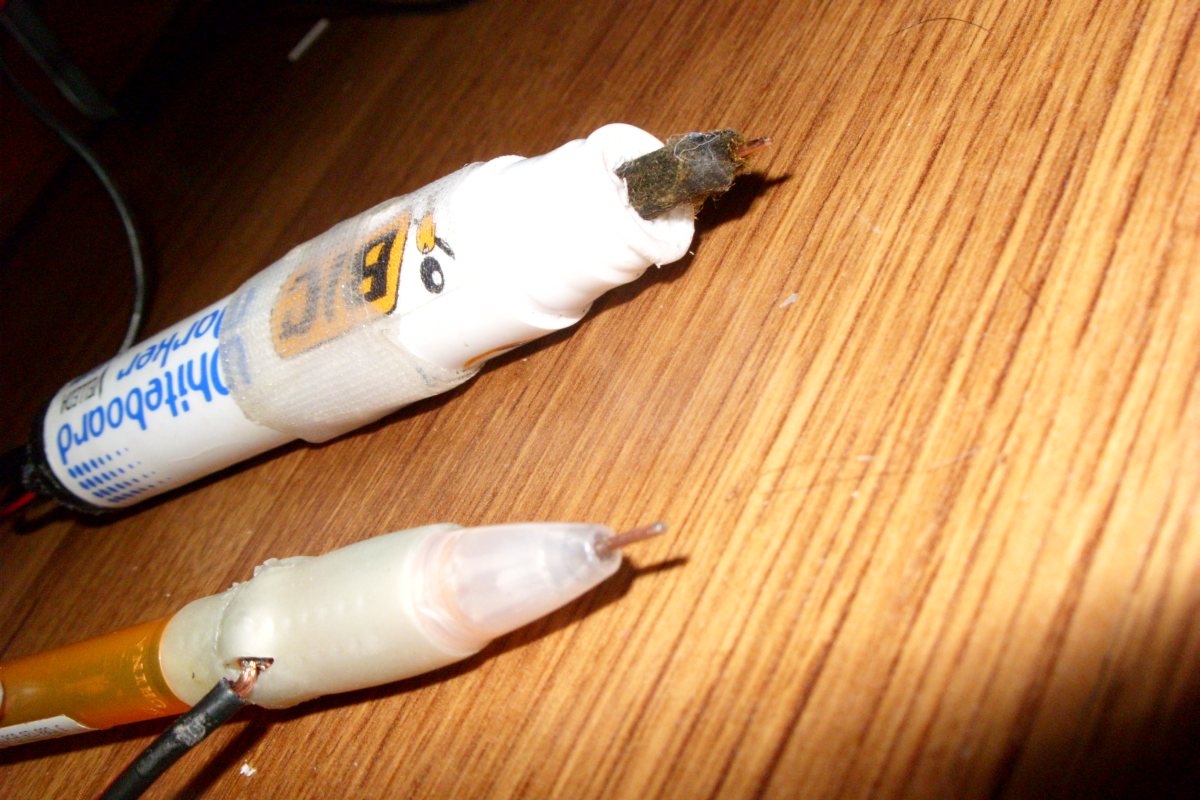

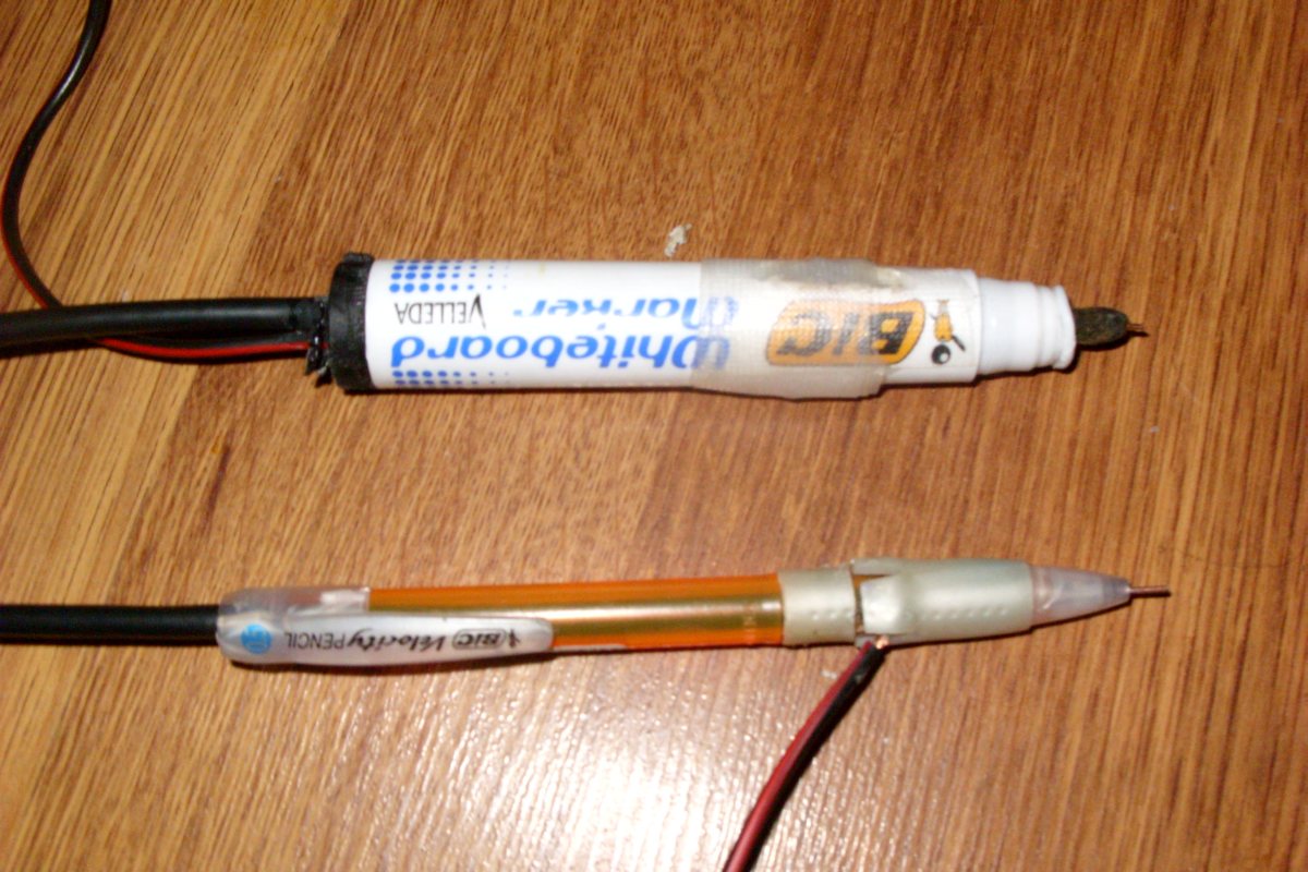

I've been trying to get the 10x probe done and i must say - compensating a probe is pretty darn difficult. Especially since i forgot to buy trimmers... All the fixed value caps i have around are either too small or too large for the job. I'll have to rummage in my parts drawer, there has to be a trimmer there somewhere. 😛
I finally found some suitable caps (3pf + 5pf in parallel left the square wave with just slightly rounded edges), and the rest was taken care of by using two lengths of about 5cm of wrapping wire from each lead of the caps to the cable, and twisting it together. Oh and here's a little tip for anyone that wants to DIY probes - superglue has quite a bit of capacitance so use heatshrink or hot glue for securing things into place.
Then it hit me - won't the 100s of volts that i'll use the probe for flash right thru the flimsy ceramic caps and damage my scope? So it was time for hipot testing. I pulled out a mains voltage doubler i had in my junk box, plugged it in and wired the probe to it (of course, at this point the probe was not attached to the scope). The doubler output some 600 volts, and i waited for 5 minutes convinced i would see a flashover. But nothing happened, the little caps happily took all the voltage. 🙂
Now all it needs is a suitable body as this one doesn't fit in a standard pen. 😛

Did anyone say pix? Here you go. The former mechanical pencil now houses the 1x probe while the marker is the 10x. As you can see there is some slight overshoot on the 10x probe but it disappears when i touch it so i'll leave it like that. And the voltage divider is damn near perfect - the last pic is with DC coupling, 2kHz signal set to 6 volts, vertical scale 0.2v/div. The waveform goes over the last division by just a little bit. Given that ripple isn't that steady anyway, this isn't likely to cause any significant errors in my measurements.
Oh yeah and you might ask about the ground clips. The clips i had were too cumbersome to use so i removed them, i'll go buy some proper alligator clips.
