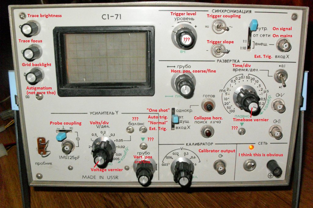

Look for an "hf reject" in the triggering options. Post a picture of the front panel 🙂

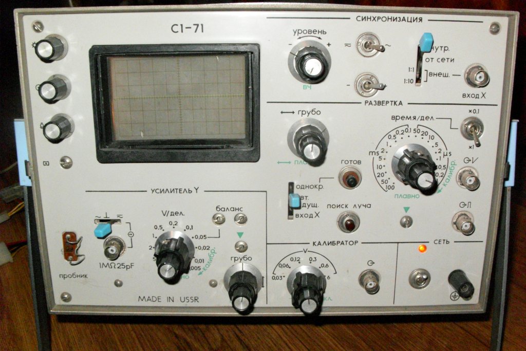

Here's the pic... And here's for hoping that you can read Russian. 😀 I can only read like half the stuff myself. The very bright camera flash drowned out both that and the trace, but the screen is actually backlit by two glorious yellow bulbs. And it's adjustable too, from "nothing" to "barely enough" 🙂
The little knob on top of the volts/div selector (they do like dual pots don't they), has a rather major effect on sync stability. Turning it to the left = better sync and much clearer trace, but nothing comes for free and it happens to also attenuate the signal, thus the volts/div ratio changes and it's not possible to estimate the signal voltage anymore. I have no idea what that knob is actually for, but when turned fully to the right it also clicks, it seems to have a switch built-in.
Edit: There's a similar one on the time section and i just noticed they both read "Calib." which is definitely short for calibration, and their behavior confirms that they are fine tuning for the main switch. I still don't understand why the one on the volts/div switch makes the trace more stable.
Sounds like that knob with the detent is the timebase veriner, to measure frequency this needs to be in the "clicked" position, otherwise adjust to best result.

At a guess,
Top right controls look like trigger level (the knob with -/+). That control should adjust the point on the waveform it triggers.
Is that a dual pot ? if so might have a "trigger delay" action too.
The top switch is AC or DC coupling for the trigger signal... maybe 😉
The one below is pos or neg trigger.
The four position switch... might be something like "normal", "HF reject", then external trigger with a 1 or 10 divider for use with the socket at the right.
Yes it is a dual pot. I don't really know what the knob at the top does though, but if i were to judge by the others it would be a fine trigger level control. I use it when the waveform doesn't sync no matter where i turn the main trigger knob and it stabilizes the trace. I don't actually know what a trigger delay is supposed to do so please explain. 🙂
Yeah i think i figured those out... Positive trigger = trigger on rising edge, and negative = trigger on falling edge, right?
The first position i am quite sure is "normal" mode and the last two are for the external trigger. The second position reads "on mains" so i'm quite sure it will cause the scope to trigger on the 50Hz mains waveform. I'll try the external trigger option and trigger from the PWM controller of the power supply under test, this should give a more steady display.

I think i have figured out pretty much all the controls. There are a few trimmers that i have NO IDEA as to what they do, but i think it's a good idea not to touch them.
The scope can be triggered in "one shot" mode too by pressing that button pointed to by the mode switch, and it goes kinda like this: Crank the brightness up, hit the button, and hope that you figure out the wave before it disappears. 😛 Not particularly useful.
It's got horizontal hold collapse too, that works very well for finding out peak voltage.
The knob on top of the trigger level one, i still think it's a fine control. Though i found nothing conclusive by using it on the internal calibration signal, it did well at stabilizing the trace when i was measuring ripple of that switching PSU.
The calibrator seems to be able to also output DC voltages besides that 2kHz signal, but that doesn't work too well. However there's no reason why an external source and a DMM can't be used instead, just like Mooly said.
Maybe any russian speaking people are able to decypher the text on the trimmers, as i can't figure out myself and i don't feel like turning them to see what they do.

Delayed trigger... probably not using the correct term here (just to confuse you), is it trigger holdoff ? simply delays the "pulse" that the trigger circuit generates that is used to start the sweep. It's useful for getting stable triggering on unstable input signals that are perhaps not periodic such as sine/square etc.
Don't confuse it with delayed sweep on dual timebase 'scopes which is totally different.
