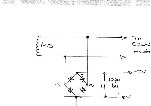

I bring earth into amp through iec socket and go straight to chassis with it for ground...
My HT secondary winding has center tap and this goes to chassis through 500mA fuse
the heater windings have no CT.
One of the 6.3Vac heaters supplies goes to heaters but I am also placing a bridge rectifier in the circuit and referencing the positive of this to Ground and therefore getting -7V for a ccs that i need.
The OV for the B+ is referenced from ground....
Does this sound correct?
Thanks in advance - Stuart

Heater/filament windings are often grounded on one end or through the center tap if available. Referencing the heater to ground is done to reduce hum problems were they to exist. You can do what you propose as long as the heater wiring is not grounded at any other point you are not aware of. Of course you will need some filtering for this negative voltage source.

@hollowstate ... thankyou, I figured I could do this - the heaters are not connected to ground anywhere else as this is a build from scratch. I think I am clear now - My 0V is always connected to the chassis for ground although I've heard it is wise to still run the 0V through the amp on its own wire and drop to ground after each section?
The transformer has 2 6.3Vac supplies and a 5Vac for the gz34
I have used one 6.3Vac for vu meters and the rermaining 6.3Vac will supply 4 ecl86 heaters in parallel but before it reaches them there will be a bridge across it with the positive connected to 0V bus and negative to supply my -7V ccs (3mA)

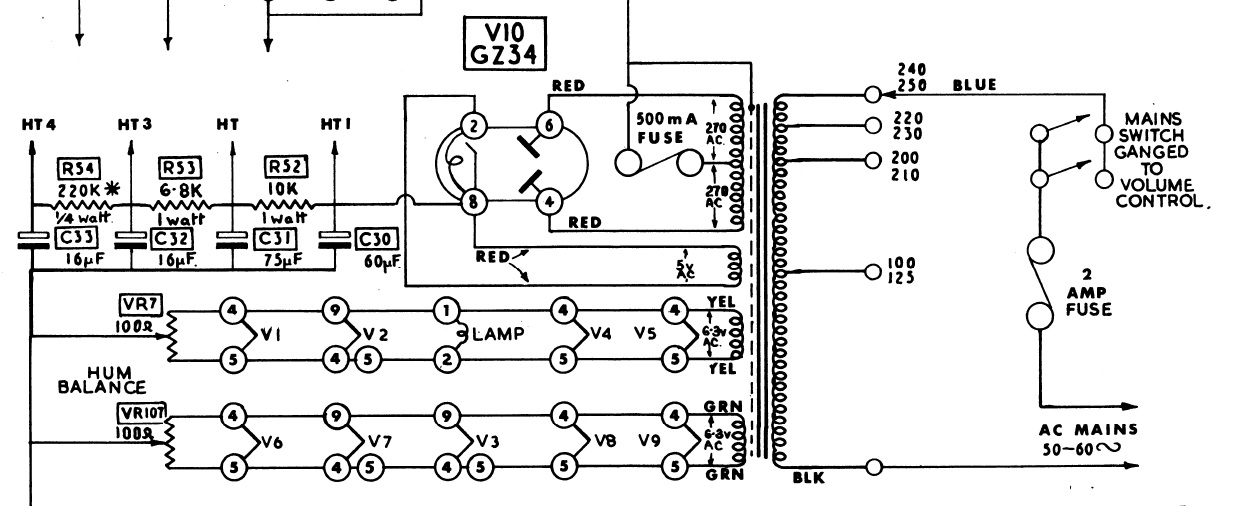

N4BBQ - have attached original circuit where the transformer was taken from... maybe I do not need the 500mA fuse?
Just a fuse on the AC inlet?
stuart

Stuart,
Assuming that one 6 volt winding is for the VU meter (lamps only?), why not use that 6 volts for the rectified negative source. The circuit would probably perform better hum wise with the heaters referenced directly to ground. The bridge gives you only ½ cycle to ground.

well, I'm just working from a suggestion from the guy who drew the schematic for the ecl86 huey I'm building so I thought I would go with his option, I just wasn't sure about putting it on the same 0V bus as the rectified B+

Fusing the secondary is a good thing. However, a fuse in the centre tap only protects against some types of fault such as excessive DC current taken from the rectifier. It would not protect the transformer if the rectifier valve or wiring developed a short between the two anode voltages. I would put a fuse in each AC line to the rectifier, and no fuse in the centre tap connection to ground. That way you are providing greater protection for the transformer.

I see that. Well that will definitely turn everything off in case of a failure that exceeds 500mA in the CT, but it leaves a lot of dangerous voltages present.
I'd not fuse the CT; I'd just fuse the AC line coming in and leave it at that.
The high voltage secondary CT should go to the first (reservoir) capacitor negative terminal, not ground. Unless you like some buzz wih your music!
Simply grounding the CT may have been the practice in the 1950s, when people expected a little buzz with music. Now we know that we don't have to put up with this, with correct grounding.
