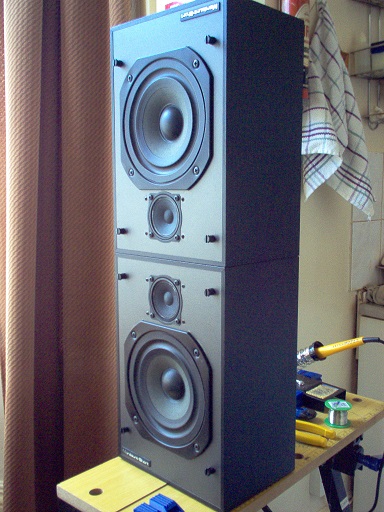

You pretty much double everything with two drivers.
Two boxes, two ports, two crossovers.
Here's the thought experiment.
Ok that's easy enough, so in that case you'd keep Vas the same and just double the enclosure volume as well as number of ports?
Exactly. The crossover, however, depends on series or parallel wiring because of the relative loudness involved. There's also a slight complexity with a single tweeter.
But essentially, if you've got a good design for a single woofer and tweeter, you can easily convert it to an MTM or MTTM.
You then gain that PA type sound which projects well to the back of the room.
