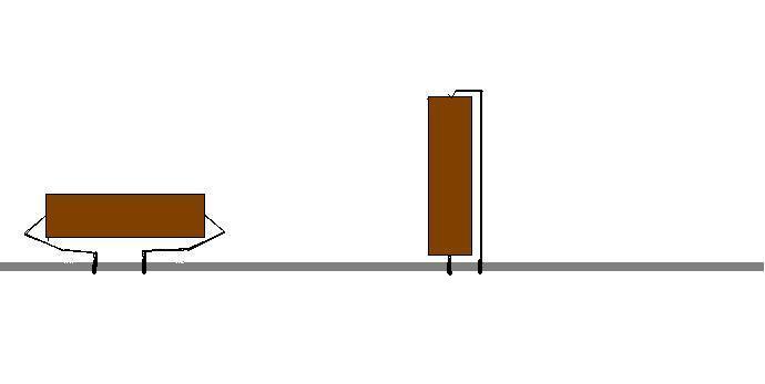

Sometimes when substituting a larger, higher-quality component, (such as a resistor or capacitor) there isn't room to lay the component against the board (example: when the pcb holes are close together), making it necessary to bend the leads under a cap, or stand a resistor up on end...
For lowest noise pickup , is it better to to wrap both leads around/under to fit, or to stand a component on end?
Also, when standing components (e.g. resistors) on end, which lead should be shortest (soldered closest to the board)- the the input (or "hot") end, or the output (or GND) end(again, for lowest noise pickup)??

I don't know what you mean with noise pickup? I assume you use anyway a metallic case, so interference should not be a problem.
Overal noise in an amp is not affected by your suggestions, other sources like transistors or megaohm resistors, also bad wiring (e.g. too close to transformer) dominate the sources you mention easily by a huge factor - not to mention bad pcb-layout. No way you can affect total noise with your measures.
Maybe you want to read a bit about thermal noise (resistors) and its magnitude compared to active parts?
Have fun, Hannes

The exposed lead that sticks up, I've always tried to use on a connection that isn't as dangerous to short.
Any resistor to ground, I have the ground longest, and the short end in the PCB.
Any high impedance connections if possible go on the PCB side of resistor.

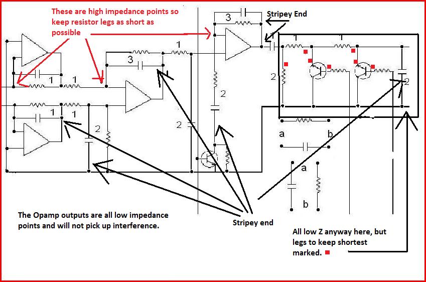

If using tubular polystyrene caps the coloured or "stripy" end is the outer of the foil. Connect this to the lowest impedance part of the circuit and get benefit of shielding, even more important if using on high gain stages. Rotating toroidal transformers worthwhile to find the lowest radiated magnetic field that interacts with phsical layout of P.C.B.

I think I've got it!
"Any resistor to ground, I have the ground longest and the short end in the PCB. Any high impedance connections if possible go on the PCB side of resistor."
So I'm understanding that when standing our resistors we should ideally keep the "input" or "hot" lead (a) down toward the PCB and the "out/gnd" lead ( b) up? Would this be the case for resistors when used in positions 1, 2 & 3 in the attached diagram?
"...the coloured or "stripy" end is the outer of the foil-Connect this to the lowest impedance part of the circuit
and get benefit of shielding."
And when standing (tubular) caps, the striped end should ideally be the "input/hot" lead (a) oriented downward, and the other, "output or Gnd" end ( b), should go upward? Would this be the case for capacitors when used in positions 1, 2 & 3 in the attached diagram?
Attached diagram is an example of a circuit application .
Again, any input is appreciated, as I'm trying to understand this more fully.
-Joe
