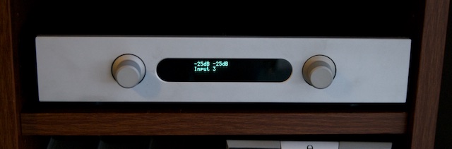

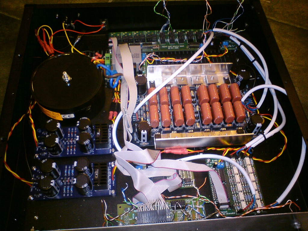

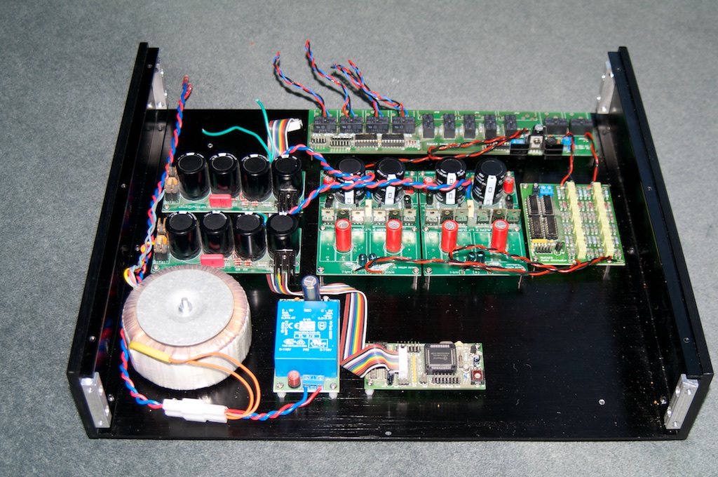

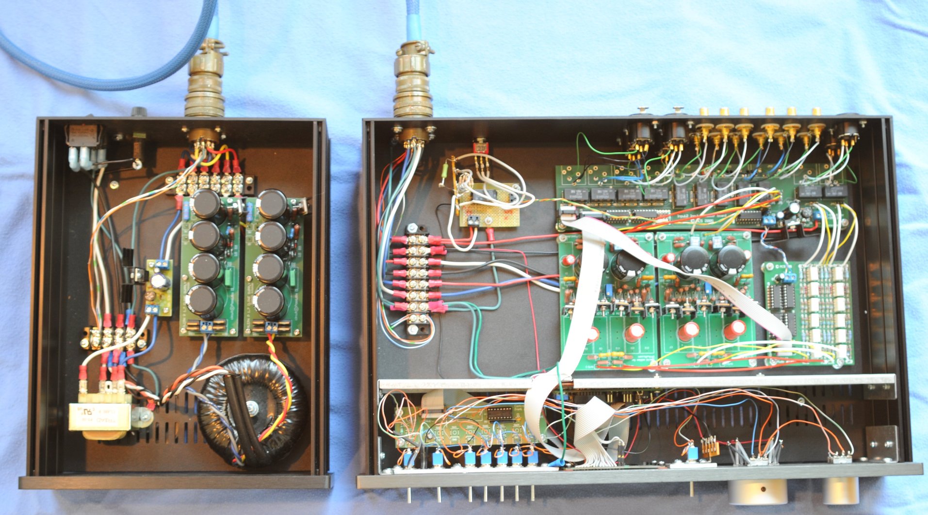

I used Dantimax gear for my P1.7 build, and there is really no issue with getting it working. It's well sorted kit and does what it says on the pack. The difficulty is working out what you want to achieve.
I ended up using:
Control1
RelVol3
78xxPSU1
Input2
and a Samsung VFD from eBay.
I'd also recommend picking up one of his universal remotes that covers all the features you need to control, even if you only use it to program a learning remote. Things like volume offsets can only be programmed with the remote for example.
The only issue I've had with Dantimax is that response from Mikkel can be slow - and I mean weeks waiting for response at times. That said I've ordered things from him on 4-5 occasions and he has delivered without fail. Last order was September 2014 when I finally got around to putting the P1.7 in a proper case.
