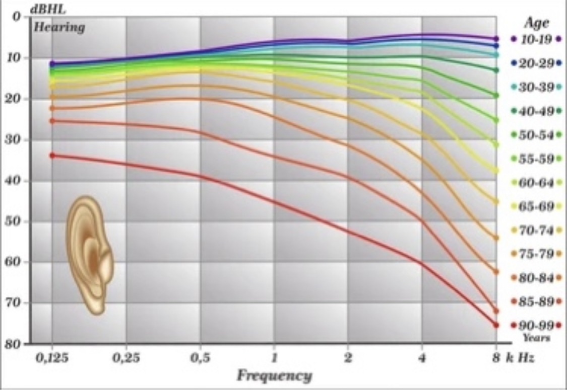

A person who can only perceive 500 Hz to 2 kHz will still hear. And music and a music system will also be part of his everyday perception. And he will also hear differences between different parts. And if I play a complex signal, like music, and take out the high frequencies from 16 kHz, it will recognize it. This graphic does not correspond to the highly complex process of hearing. The ear is first and foremost a difference perceiver (example: reproduce psu experiment, above).
In addition, we hear with the entire organism. We are not even aware of this: not only is the entire organism mechanically set into vibration, these vibrations also modulate the currents of the "nervous system". Example dentist - not only the electromagnetic differences caused by friction, for example, but also the mechanical vibrations modulate your power grid: pain;-). And also ear as membrane or skin as membrane or hair as transducer and so on. And perhaps we can go even further.
By the way: a 10 Hertz oscillation from the WLAN router can also be detected in the organism after 24 hours. Attention with the EMF: Humans are also antennas for every imaginable EMF garbage and noise, which can lead to collapse and death.
This idea of hearing and frequencies, see picture, is a highly simple and undeveloped one. It should not be taken as a basis in audio.

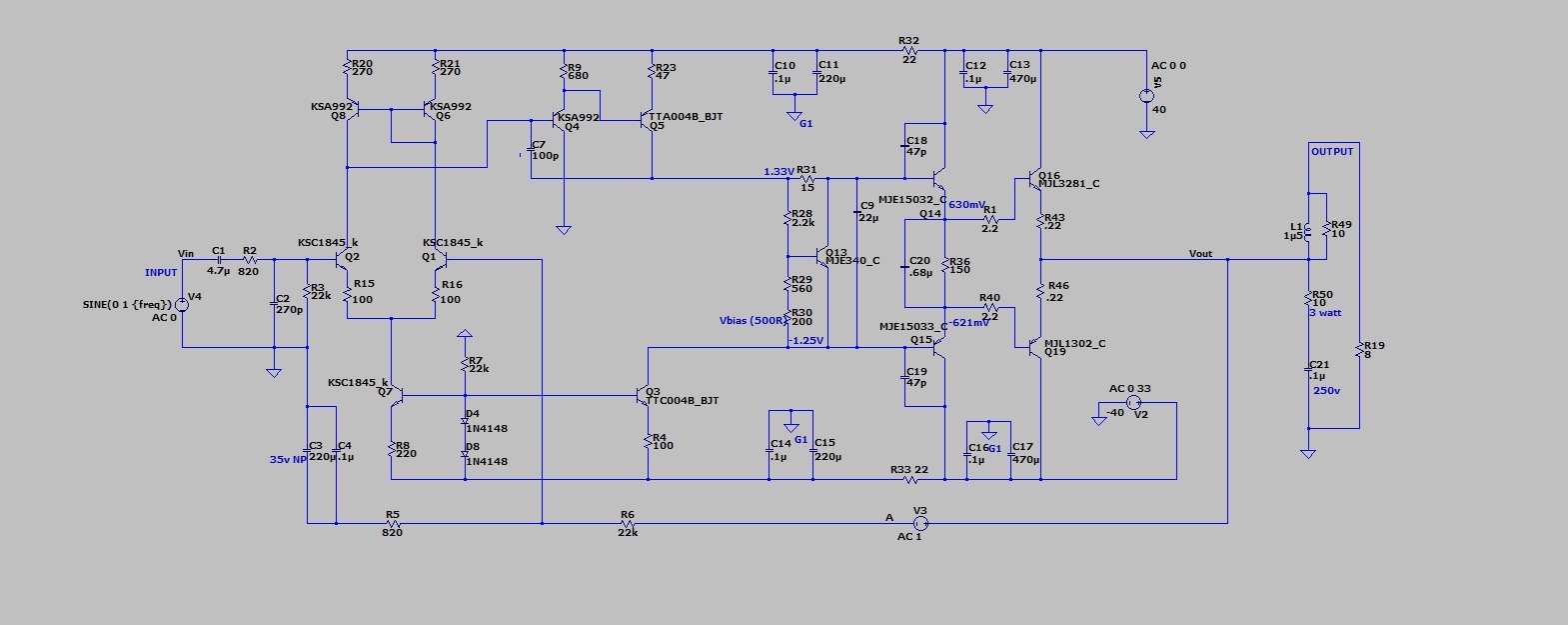

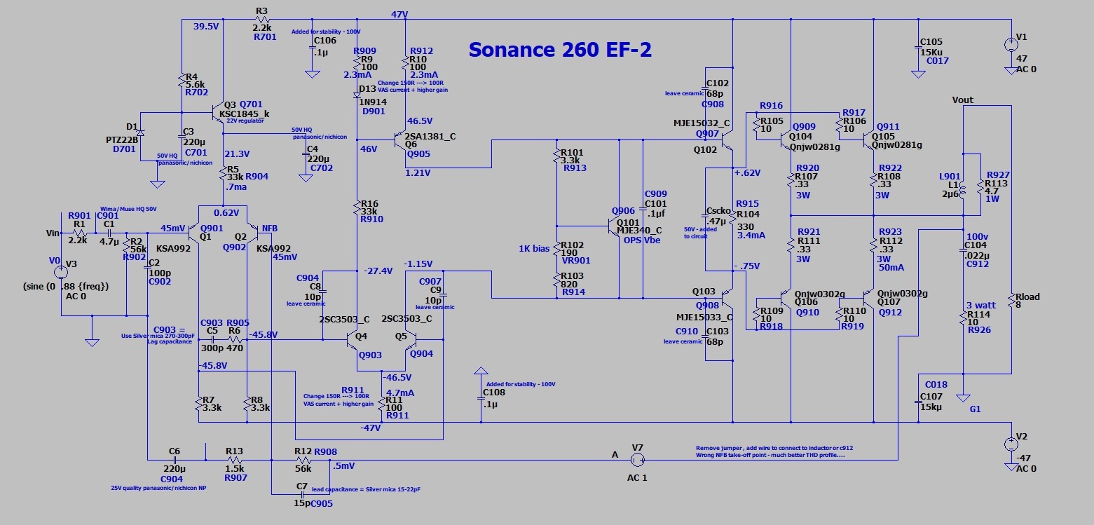

Acceptable is subjective. 5-6 would be good for a pair of high SPL 3" (bluetooth speakers) drivers.
The smallest pair of 40-80W 87dB bookshelf speakers would need maybe to have a 5-6 device IPS/VAS plus 4 more for a decent EF2 OS.
Amp 1 - (below) @ 30 years of use , a few mV offset and would sound MORE than acceptable (with good speakers).
Amp 2 - below is 34 years old , new silver micas for compensation / "MUSE" audio caps - HQ PS. Way more than "acceptable".
Running some bigger speakers , very "acceptable" , except for full volume (not enough headroom - 80W peaks).
Just 6 devices exempting the EF2 output !
Some super efficient loudspeakers I've seen @ 95dB+ , a 4-6 device class A (Pass SIT type) circuit is actually preferred.
You have to listen to the particular speaker/amp combo to determine a good match .... many different music types.
"Acceptable" would be any modern IC chipamp running cap- coupled with a single supply. Just 1 part.
OS

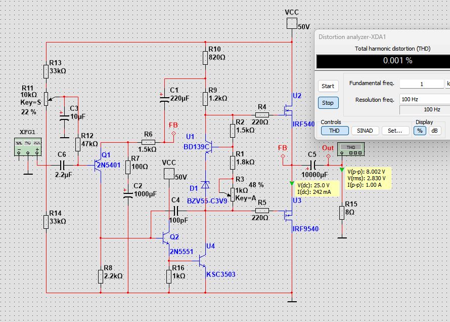

Here is a 6 transistors amplifier.
It has 0.001% THD and max power is 25 Watt into 8 Ohm.
