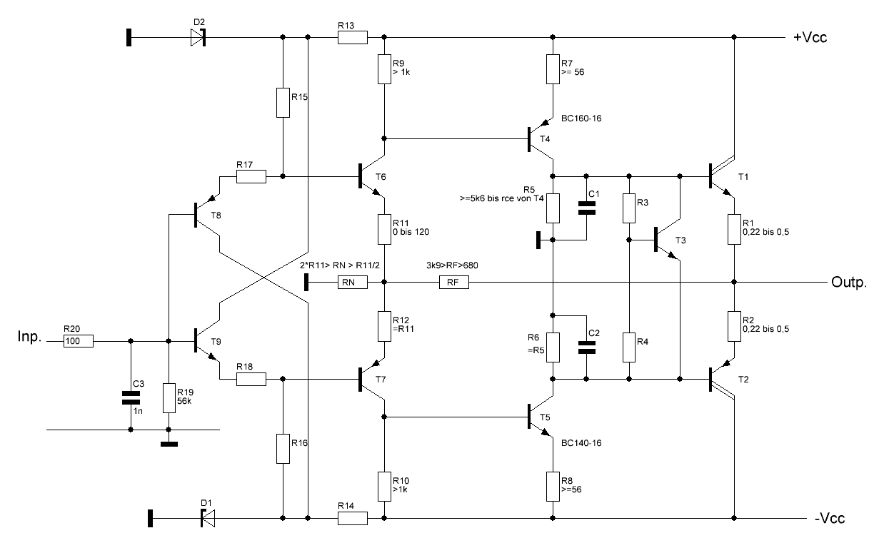

As a basis for discussion or as a gift for @cumbb, the Symm power amplifier by Helge Peters (published in Klang und Ton magazine 5/1991).
The lack of dimensioning is intentional, as the degrees of freedom can be very wide.
HBt.
I would like to remind you of this circuit, and also recommend it to all those who believe that their Krell or Accuphase or ML or Cello... even as a clone, have dragged a good story into their cabin and connected it to their loudspeakers;-)
This little box has the higher sonic potential, and can also be built without a circuit board - like a Hiraga Classe A or Le Monstre or other simple complementary transistor push-pulls - which also has advantages: fewer transitions, for example, shorter paths, lower circuit deviations and so on;-)
Some original component values:
D1, D2: ZD16V, bridge with 220 µF
R17, R18: 68 Ohm (or replace one of these with a trimmer to set the offset)
R13, R14: 3.9 kOhm
R15, R16: 36.5 kOhm
R9, R10: 5.6 kOhm
R11, R12: 300 Ohm
Set up T3, R3, R4 as the usual bias setting, i.e. use something with a trimmer - as can be seen thousands of times in this forum on some circuit diagrams.
psu approx. 2 x 30 VDC
Depending on the power supply and cooling, the quiescent current can also be turned up considerably - the difference should be audible and give a first impression of A/B or A;-)
