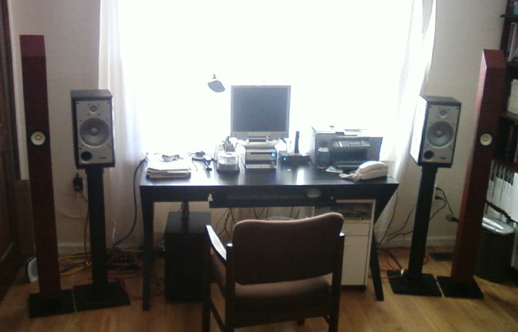

As promised, here's a picture of the finished ziggies. They are hooked up to the tiny Nuforce Icon, fed from my desktop PC running Foobar2000/asio4all. There's also an Infinity PS8 sub under the desk.
Here's a summary of how I put them together:
I had the lumbaryard where I bought the 5'x5' Baltic birch ply cut the eight strips, four of them at 4-3/4" wide (for front and back) and the others at just a bit shy of 3" (for the sides). I then cut a pair of the 4-3/4" wide strips to the length of the front baffle, the top edge at 22.5 degree angle. That leaves just enough to make the slanting top pieces, and basically at the correct 22.5 degree angle as well, on one edge. The top pieces will have the 22.5 degree joint with the front, and butt joint with the back (with sides of the top exposed on the back). I then cut the sides and backs to sizes.
I first glue the sides to the back. While the glue was drying, I use the foam gaskets that came with the fostex drivers to mark the driver openings on the front baffles and cut them out with a jigsaw. I also cut and glue the two small pieces of wood (on each speaker) for the "mouth" at the bottom.
Next I stapled the damping felt to the sides and back right behind where the drivers would be (about 12" wide and nearly 1/2" thick). I then drilled the holes for the speaker terminals, just below the felt material. Next, the terminals had the wires soldered on and installed.
Next I glued on the front baffles, then the top. Then the cabinets are sanded, patched with wood filler and sanded again. Three coats of cherry stain and two coats of satin polyurethane were then put on. Finally I soldered the wires to the drivers and installed the drivers (pre-drilling pilot holes for the screws). The bases are 10"x10" and painted satin black. They are attached last.
I've been burning them in 24/7 for about 2 weeks now. They really sound quite good to me. They certainly exceeded my expectation by far, given my very limited woodworking skill.
