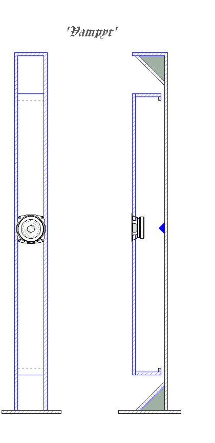

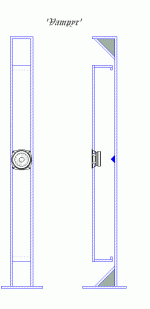

Dave is working on the CAD plans as we speak... er, type... well, you know what I mean, so ignore any previous rough drawings.
The fact that the Ziggies are more of a "one size fits all" kind of design, the Vampyr on the other hand is specifically designed just for the FE103E to get the most out of this tiny, wonderful driver.
The "Ziggies" are a tried and proven design from close to a decade ago. The Vampyr is an as yet unproven computer simulation. Charles, here is an excuse to build two pairs of speakers and compare them and see which ones you prefer.

fishline said:What's the Vampyr? Would appreciate links to description/drawing.
As noted 4 posts up, Dave is currently working up the CAD plans. Meantime, this should give you an idea about what to expect:

Scottmoose said:As noted 4 posts up, Dave is currently working up the CAD plans. Meantime, this should give you an idea about what to expect:
Just passed the 3rd revision on to Scott for QC...
dave
