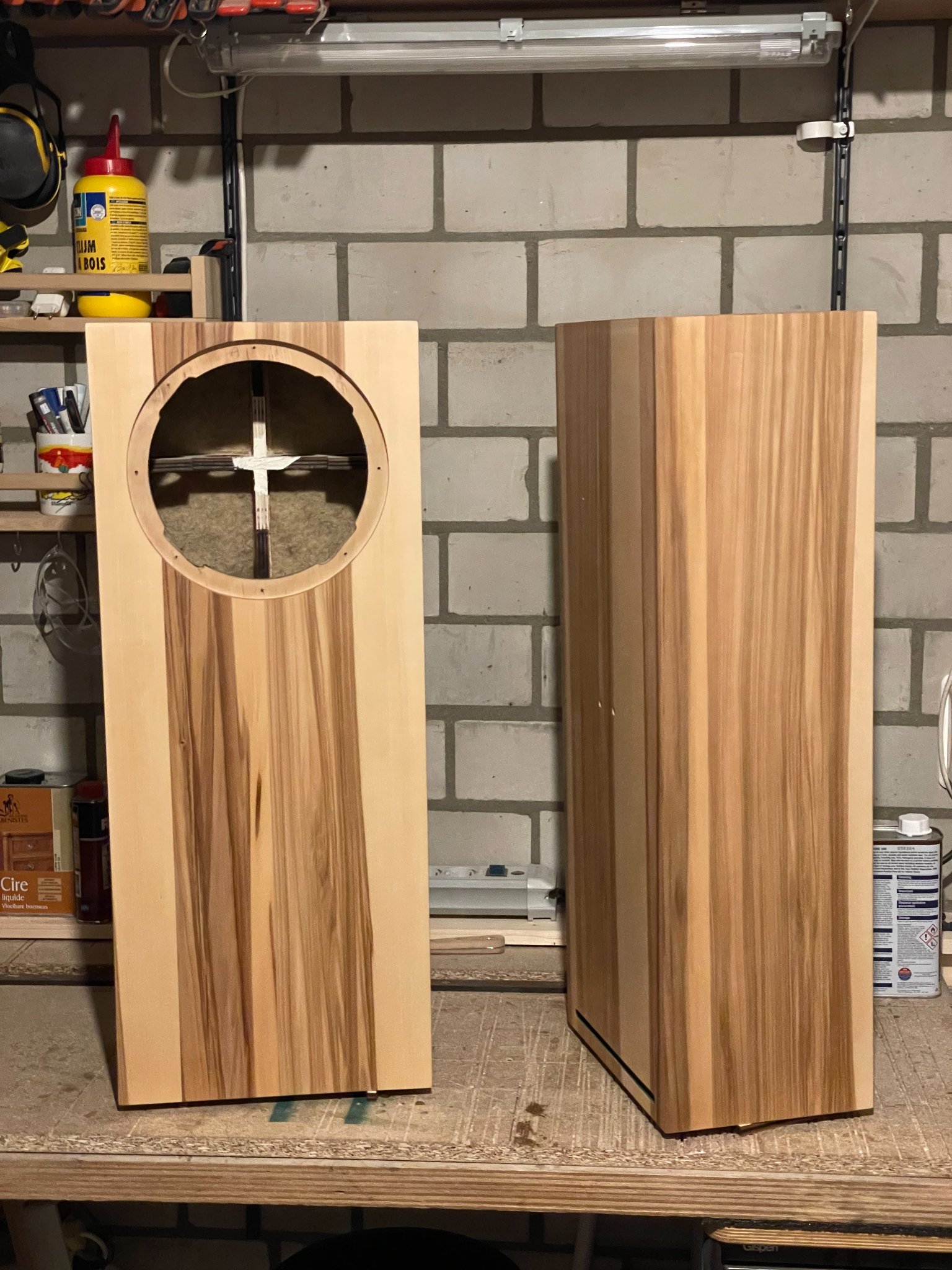

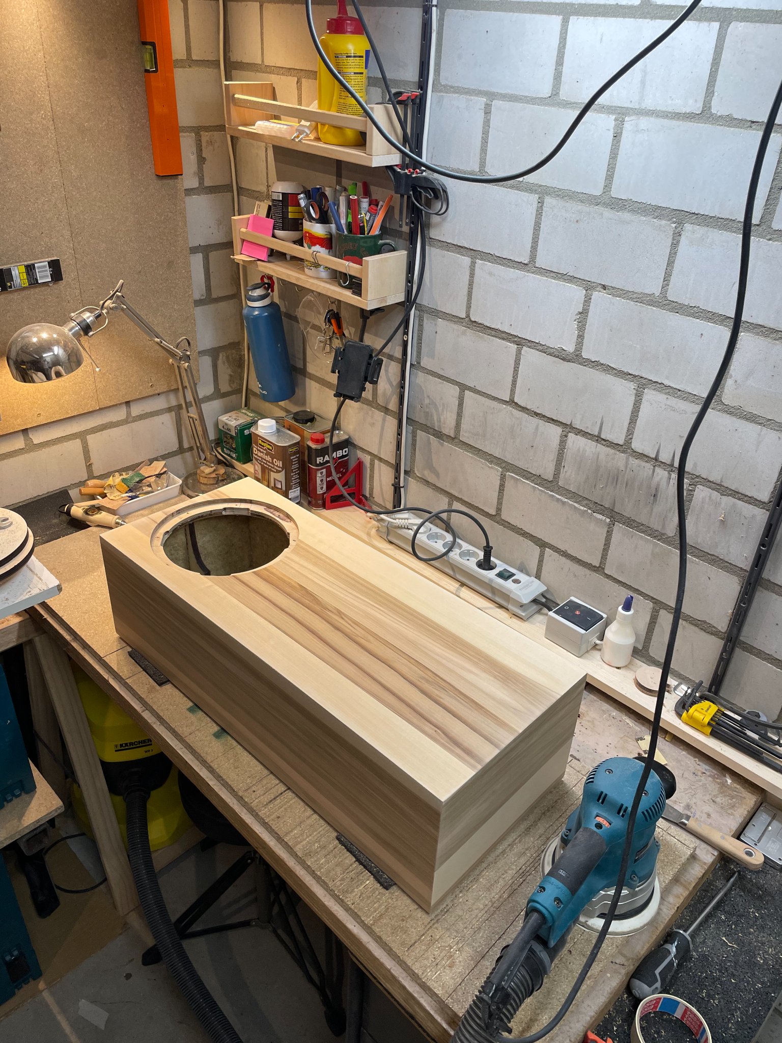

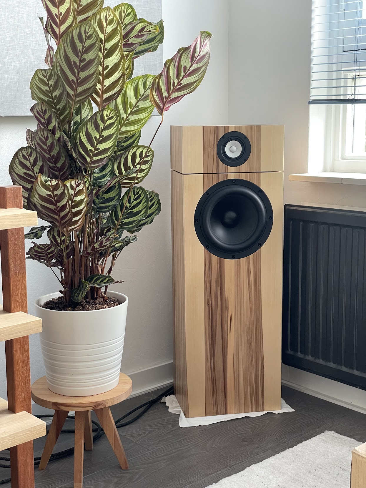

In the end I just decided on a slotted port and started building! Here are a few snapshots from the build, currently in the process of oiling the cabinets. I still need to decide on legs / a small stand, but already super excited to experiment with this new setup.
Very pretty. I expect M5 is one of the stellar midTweeters, Are you bi-ampinmg?

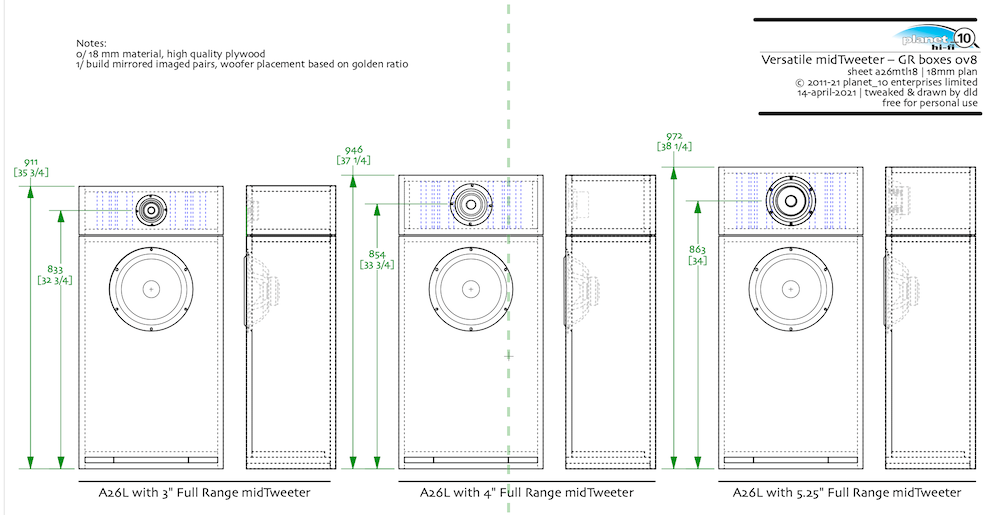

When i first saw the pic in Post 1 i thot A26 sealed WAW. But you did very well on your own. How big is your box?
I am partial to modTLs, your sealed approach is fine and much like @waxx A10.3 WAW.

Wow, those A26s look very pretty. I really love wide baffles like this. Are they deliberately trapezium shaped for them to go into a corner space efficiently?When i first saw the pic in Post 1 i thot A26 sealed WAW. But you did very well on your own. How big is your box?

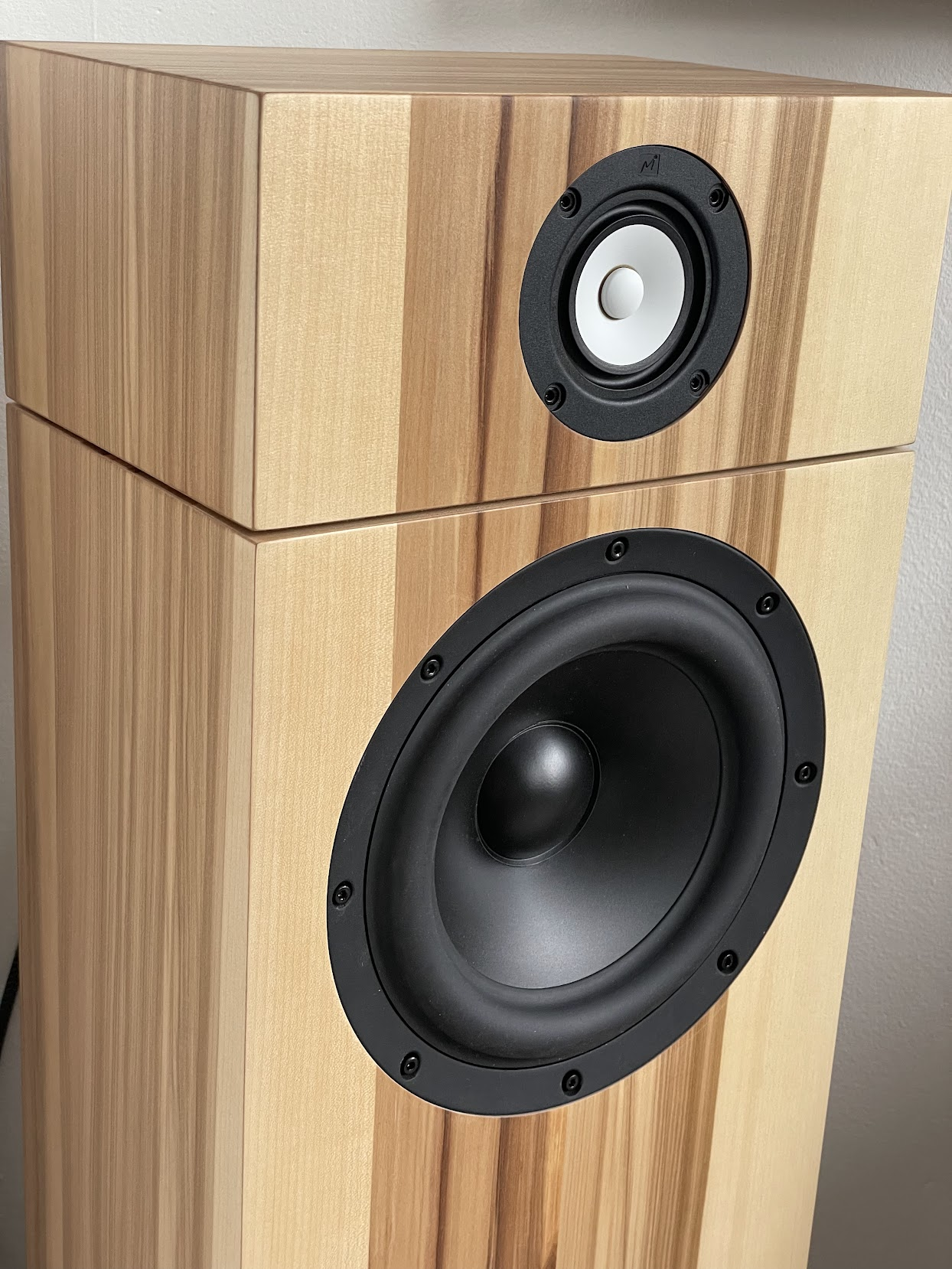

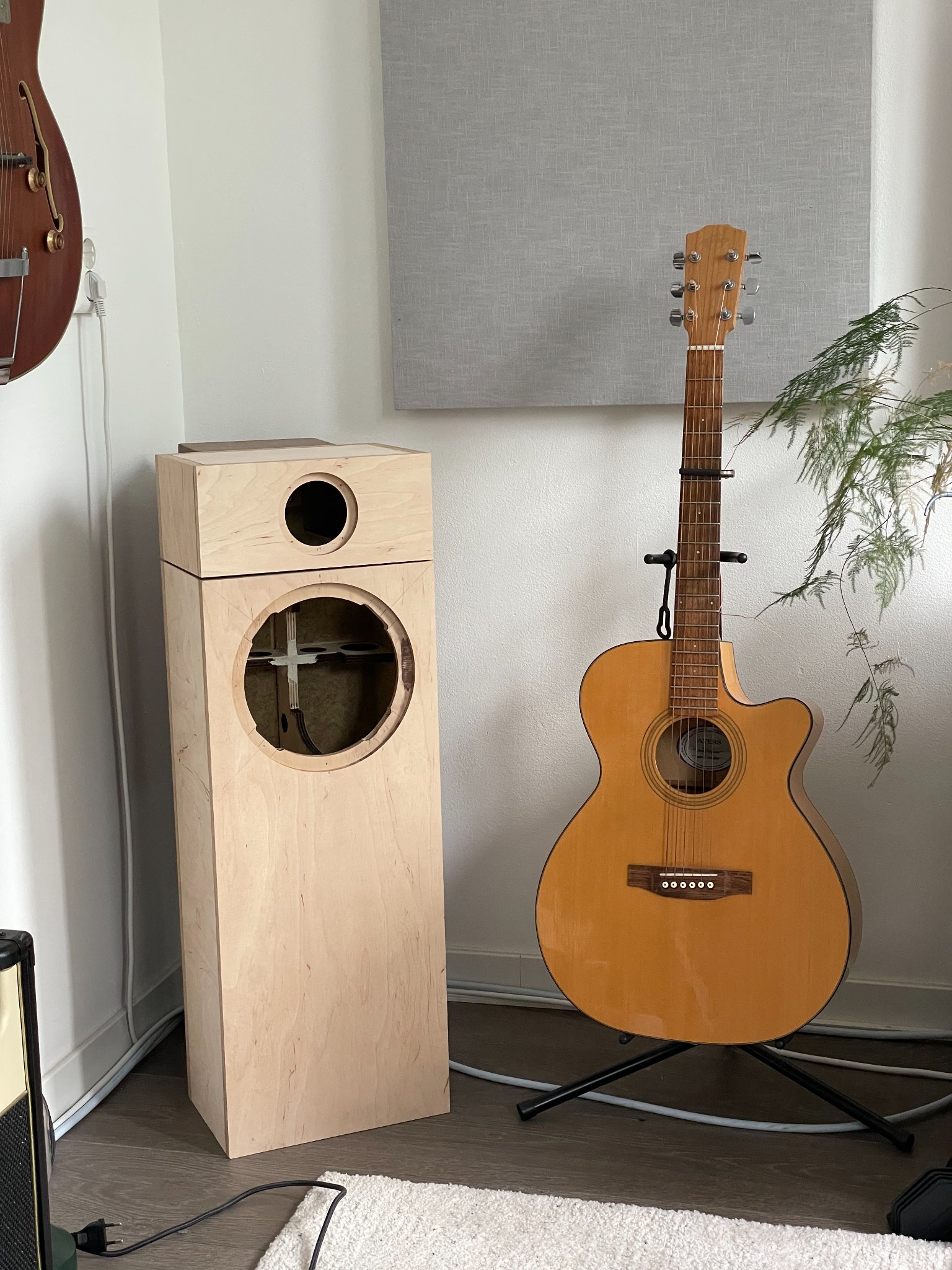

In the end, I settled on a relatively compact, shallow design:
FR Enclosure (inner)
Width 264mm
Height 101mm
Depth 170mm
~ 4.5 L
Sub Enclosure (inner)
Width 264mm
Height 691mm
Depth 170mm
~ 28.8 L (system volume without bracing)

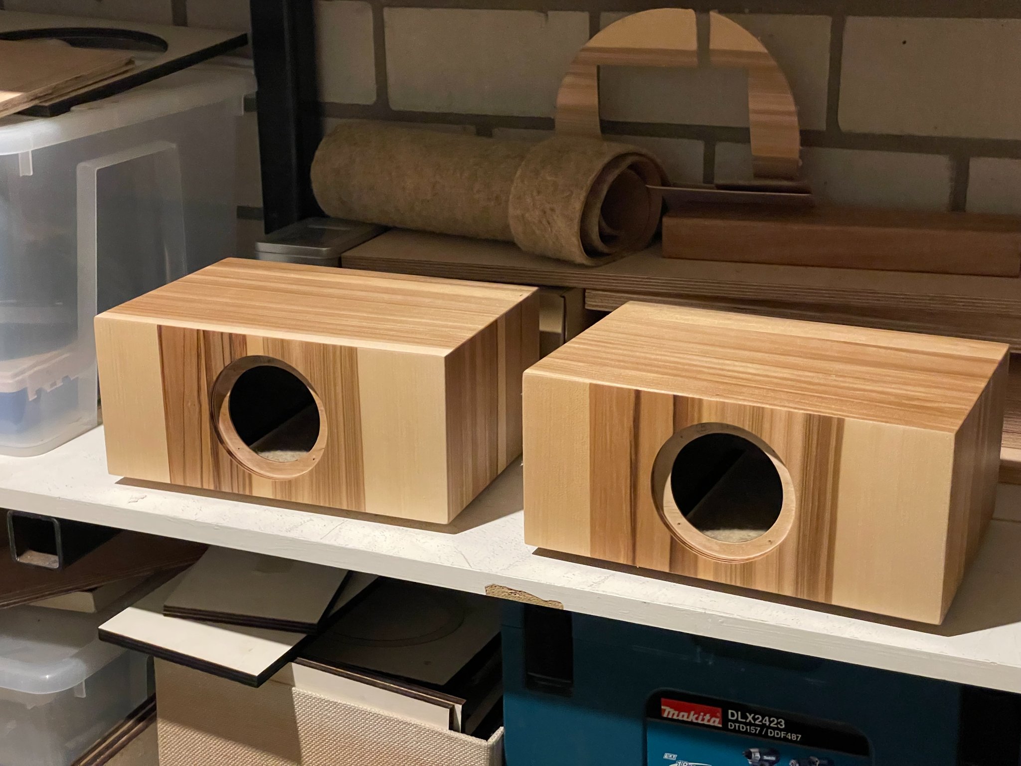

Things that I am reflecting on and likely have to do diifferent next time:
- Thicker walls for the box, currently 15mm. The subs baffle is double that, but only on the top half of it around the woofer to keep some extra space.
- The slotted port on the back is very thin, almost impossible to route accurately.
- I am a bit anxious about port velocity at higher level listening, we'll see how that goes.
- Probably lots more, if anyone sees/thinks something please call it out (eager to learn!)

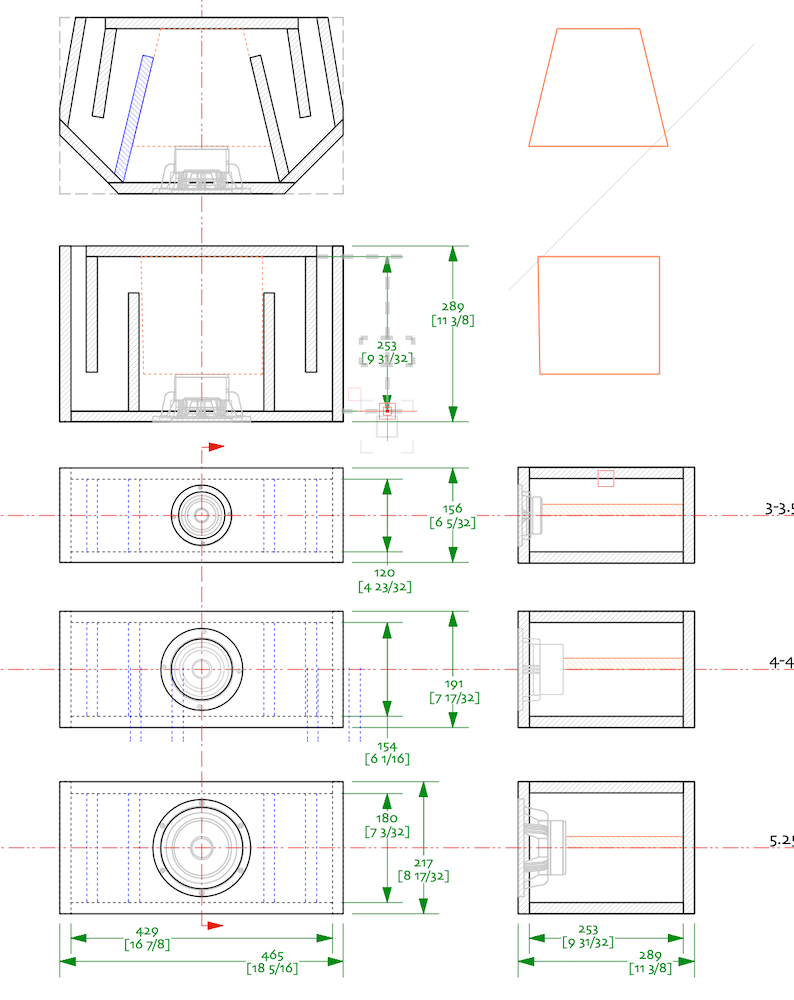

They have a very low diffraction signature. Concepot orrowed from my trapezoidal miniOnkens:
This set of pictures of various µFonkenSet trapezoidal miniOnkens.
These are 2.5 litre. I have done them up to 135 litre. Trapezoidal midTLs were inspired bythe ones done for the 35 litre one.
Depends on the material and the bracing. We (mostly — Bernie’s builds are all solid wood) used quality plywood. the little boxes can be 12mm but it is easier to work with 15mm. For a 30 litre box we would use 18mm. The exception being push-push subs where 15mm is suffieicnet (at least to 2 x 12”), for practical purpose at least thicker baffles. Push-push takes advantage of the active reaction force cancelation to largely remove any direct energy into the box thru the baffles and one really has to worry about ballooning.
Very high aspect ratio vents add R to the vents and pushes the box closer to aperiodic. If you are adding subs stuffing the vents pushes them even further.
Our thin vents were just part if the construction. I bborrowed the concept of vents down the sides from the Onken, then took advantage of pushingn them enuff towards aperidoic and came up with my own alignment. If you add a sub really easier to add open cel foam to push them way further aperiodic to make the transition at the bototm easier.

any techniques you'd recommend for determining retrospectively whether a wall thickness is adequate?
Spend ≈ €20 and get a mechanics stehescope and start listenng to the speaker panels (of any looudspeaker you can), Quite revealing. You bracing looks very good. Is the woofer braced against the back?

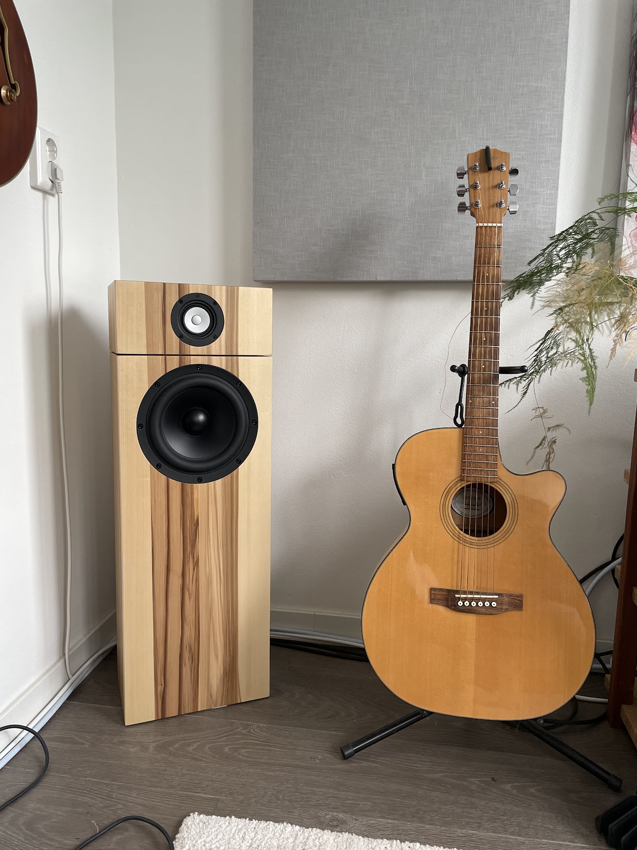

So the drivers have been put into cabinets now, I just need to find some rubber feet to separate the top and bottom unit and then think of a small stand to put them on. I am very happy how they turned out, especially since it was my first time using veneer (excluding 2 small tryouts before the real deal).
The only thing I didn't quiet get right is the corners on this left unit as can be seen from the darker edge on the next picture, but nothing too dramatic in my opinion. Still very happy overall!

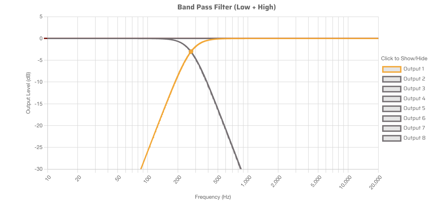

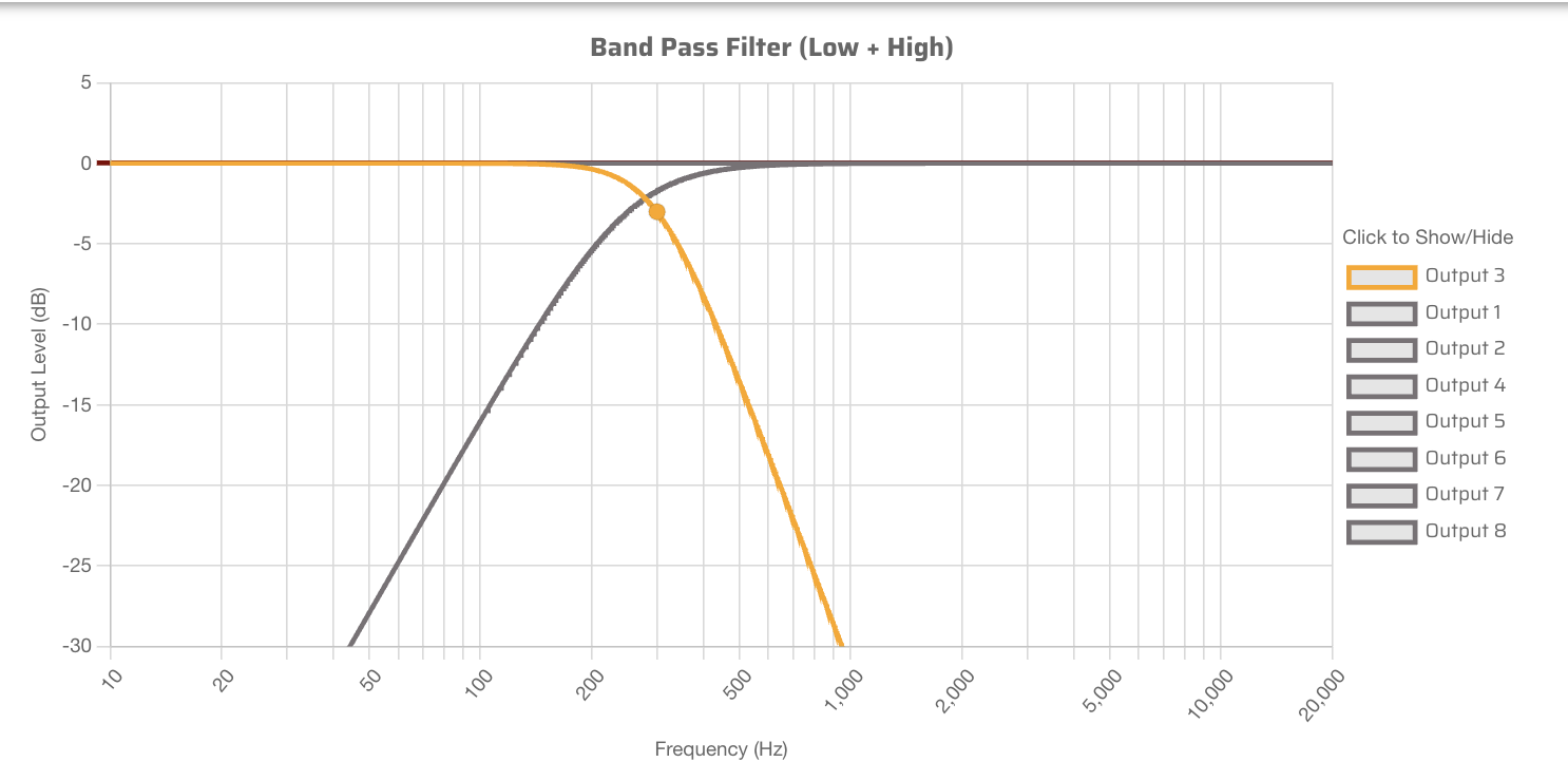

So far I seem to have a preference for cutting of the MAOP-5 at around 250hz, while doing the woofer at 300hz with different filters even:
While for example this sounds slightly more dull to me:
I am not really someone for a 'flat frequency response' so likely my prefs because of some added warmth, not sure yet...
