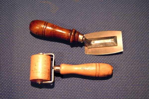

Most problems seem to occur from the application of too much glue to the veneer. I recommend a foam roller because it's actually tough to put on too much, or if the glue's too thick, it won't roll on at all.
Most likely, the veneer expanded after soaking in the glue, or it was never acclimated to begin with. Indoor humidity in winter can be extremely dry w/o humidification.
You must let the glue dry completely before ironing on.
I also didn't understand why you felt the need to clamp with anther board. Once the ironing is done, the glue is re-activated and is set. The only thing I do is a scrape with a veneer block immediately after ironing while it's still warm.

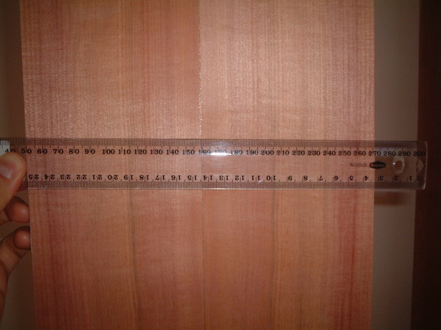

The glue I used was called "Crosslinking PVA" and was labelled as heat-resistant. I guess that's why I was afraid to see it dry completely...
It is summer here in Australia, with 30+ degree celcius days here in sunny Perth. I had left the veneer in the same room for a few days before applying.
Will try again soon, with foam roller and report on my findings.

Titebond II is a PVA glue and it's application includes use for hot presses, which make it fine for the iron-on method.
Using a foam roller cover, I find I need to thin the Titebond with maybe 10% water to get it to roll on easily, rather than just pushing it around with the roller. I put a thin coat on the back of the veneer and 2 heavier coats on the substrate. When it turns from a light yellow to translucent amber, it's dry enough to work with. As with anything you've never done before, I recommend a test piece if you can spare a little material.
I've never heard of Australian Myrtle, let alone work with it. It sounds like it has some sort of backer on it to hold the flitches in a sheet form, so it should be ideal.
I'm amazed tho that using wood glue, the veneer actually shrunk and pulled across the substrate. Even if it had swelled some from too much glue, once bonded, it shouldn't have enough internal stress to pull open a seam.

Clean trimming and very light sanding of the edge will keep it looking crisp. I use 3m's Stick-it silcone carbide paper. It comes in rolls 4 1/2" x 10 yards. It is excellent paper and we make sanding blocks out of 3/4" MDF that are 4" wide x ~8" long. We wrap the paper lengthwise around the blocks in differing grits. This enables you to do proper flat sanding of substrates, using 80 grit, to final cleaning and easing of finished edges using 220 grit. We use these blocks all around the shop for sanding duty as well as some tool sharpening (using longer strips on hard flat substrates).
