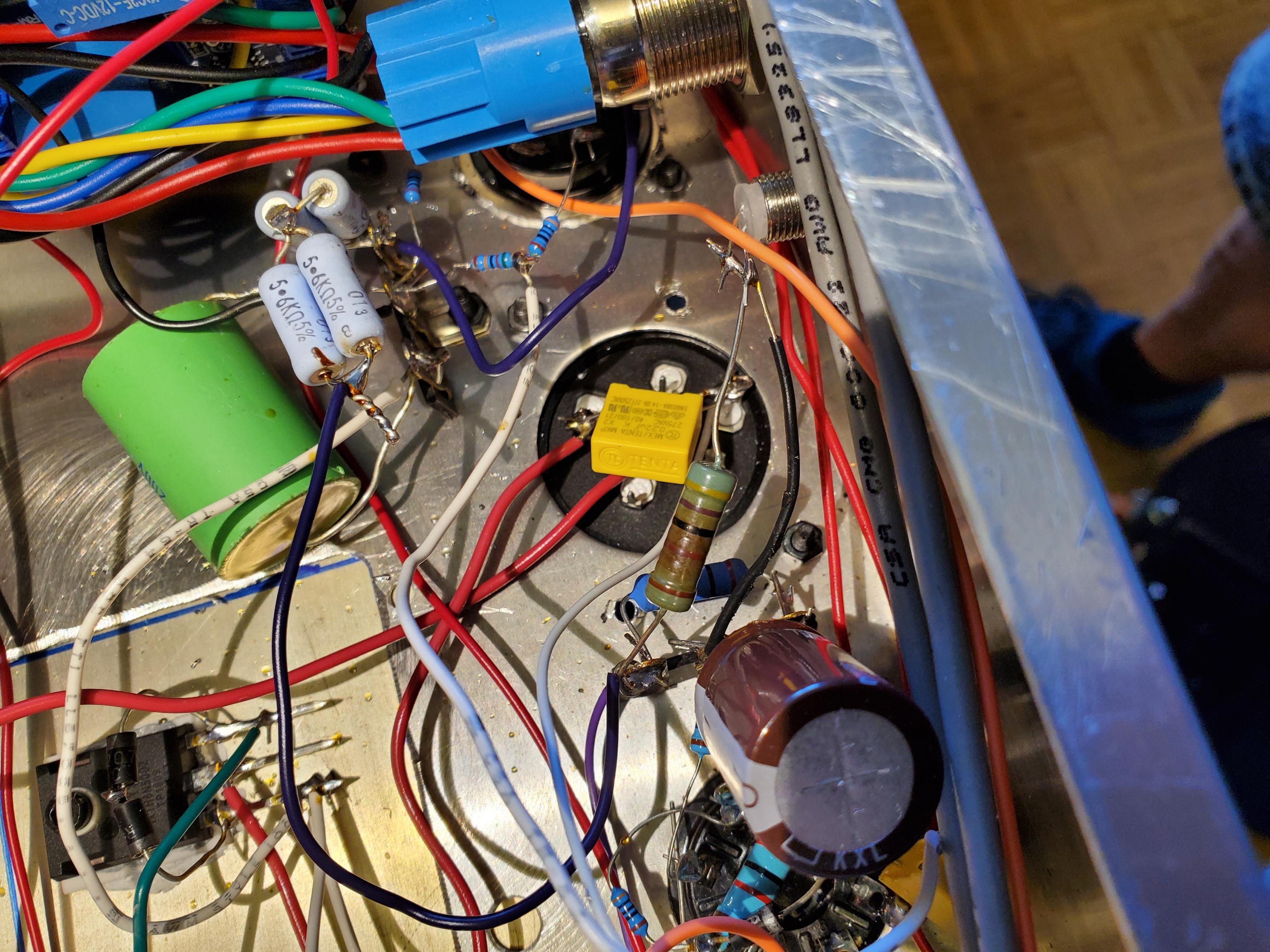

№ 4 — for resistors P = E² / R … = 8² V ÷ 150 = 64 ÷ 150 → 0.43 W. Why the 5 W model? I'm not against it generally, but still … a solid 2 W would be smaller. [/indent]Nothing really matters as long as the P is well below PMAX

Here's a picture of a 3W 47k resistor used as a dropper for an LED. It dissipates 1.5W... It's also in a chassis that is basically an oven. As a rule, I build with the largest resistors practical now! Those 5k6 resistors are series/parallel connected for Pd of 12W with a circuit that needed 2.8W 🙂 I had them already though, so why not?
Since the burning resistor is just a dropper for an LED, I don't care at all that it's discoloured 🙂 If it explodes and takes the LED with it, J'men câlice 🙂
