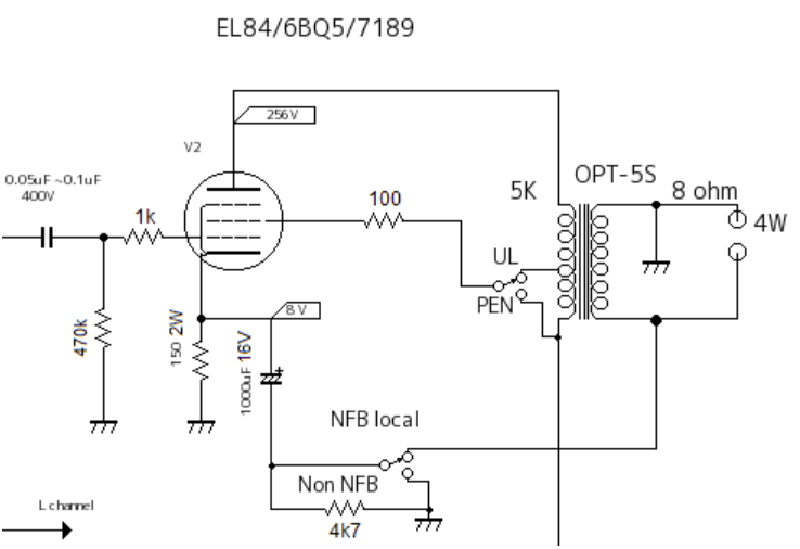

I was looking at the schematic. In post 1 and thinking, "there should be a resistor in there" and then seeing Ketje's schematic in post 3 reassured me that I'm not crazy after all (much).
I meant to ask earlier but what is the function of the 4.7k resistor in the schematic posted by Ketje?
It's in parallel with the resistance of the OT secondary.
Since the resistance in the secondary is ~.4 ohms the resistance with the 4.7k in parallel is .39997 ohms. So what's the point of having the 4.7k in there?
What am I missing?

Only for a swith with "centre off" to have three possible modes of feedback.
The resistor keeps the cathode capacitor charged to prevent a plop while switching.

Thanks.
I'm undecided about adding a switch but, if I do, it will probably be a simple on/off between the cathode and and the positive side of the cap. So the choice would be between Local NFB and an unbypassed cathode resistor (degenerative negative feedback).
In that situation the 4.7k wouldn't be necessary, correct?
I would insert a resistor in a different place, I didn't look at the drawing closely enough.
How I have accomplished a similar thing, whether it is correct or not...well...its not for me to say haha.
I take the cathode resistor (and bypass capacitor, if used, as parallel pair). I insert another resistor between that and ground. I inject the FB into the node between the two resistors.
I thought Ketje's drawing showed that, but it does not, due to the separate ground reference symbols.

The original schematic that I found online, which Mona modified, shows an UL tap but my OT is not UL. So there won't be any Pentode - Triode - UL switch. The amp will operate in Pentode only.
FlaCharlie,
1. You can incorporate a Pentode / Triode Wired switch if you want to (use a 100 Ohm screen resistor).
The switch connects the 100 Ohm screen resistor to B+ (Pentode mode), or to the plate (Triode wired mode).
Again, only change the switch position when the amp is really off.
2. If you look closely at Mona's schematic, the top of the bypass cap is always connected to the cathode. The 4.7k resistor will keep the cap charged when the switch is Between position 1 and position 2.
When the bottom of the cap is connected to the secondary, than the very low impedance is in parallel with the 4.7k (therefore the 4.7k does not take any significant power from the 8 Ohm secondary).
When the bottom of the cap is connected to ground, the 4.7k is shorted out by the switch (no problem).
Yes, it is a little hard to see, I hope I have explained it well.
The cathode either sees 1000uF to direct to ground, or it sees 1000uf through the secondary to ground.
(Or, when the switch is mid-position, the 4.7k keeps the cap charged (so little or no "Pop").

I think it would be helpful for me to restate the information about this project that I wrote in the first post:
I have a SE VM that originally had the preamp section connected with an umbilical. The amp section only has a 5Y3 and a pair of 6BQ5s. I want to drive it with either a stand-alone tube pre I built or a SS pre. So I won't be using global NFB like the one that went to the stock preamp through the umbilical.
My amp does NOT have an UL tap like the one in the schematic. I want to get as much power out of it as I can so I want to stick with pentode instead of converting it to triode.
So it's either pentode with no FB or some type of local FB. Are there other local FB methods that I should consider?
If the switch is used to connect the cap directly to ground, thereby bypassing the cathode resistor, there will be no NFB. My understanding is that operating a pentode without any NFB is not considered such a good move sonically. Therefore some form of NFB is in order.
So it will definitely use the Local NFB scheme shown which connects the 1000uf cap through the secondary to ground.
The other option I'm considering is to install a switch that would remove the Local NFB through the OT secondary and use an unbypassed cathode resistor which, as I understand it, would result in a lesser amount of feedback (aka degenerative feedback) than the cap to secondary connection.
In order to remove the cap from the circuit it must either be disconnected from the cathode on the + side or disconnected from the OT secondary on the - side.
So, where should the switch be installed? Or does it matter?
Is there a way to install it so that it can be switched, while the amp is on, without creating a "pop"? Or must it only be switched before the amp is powered up?

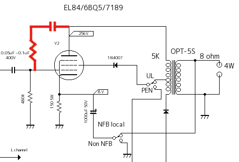

A cap from plate, then a resistor to g1 for local feedback.
But probably less effective?
"sg"? I assume the "s" must stand for short and the "g" for global. But it seems local to me if only a single stage is present.
I don't recall ever seeing this method but, as I said in my initial post, I'm open to considering other methods.
Are you saying it's just a cap and resistor, in series, between the plate and g1? What values would be appropriate? And why would it be less effective?
Please elaborate. A schematic would be helpful.

I struggle regarding feedback so I can't help that much, but here is the principle. Capacitor DC blocker then a resistor to form a divider network with the existing Rg (480K).
From what I've read here and there, a local feedback won't be very effective for noise/hum issues. But we are supposed to build a clean and quiet amplifier *before* applying feedback anyway.
