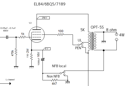

Questions About This Local NFB Scheme
I'd like to hear some comments on the local NFB scheme in this schematic I found.
I'm also wondering about its use of a 1N4007 in both the B+ and G2 supply. What is their purpose? Would there be a problem if they are omitted?
I have a SE VM that originally had the preamp section connected with an umbilical. The amp section only has a 5Y3 and a pair of 6BQ5s. I want to drive it with either a stand-alone tube pre I built or a SS pre. So I won't be using global NFB like the one that went to the stock preamp through the umbilical.
My amp does NOT have an UL tap like the one in the schematic. I want to get as much power out of it as I can so I want to stick with pentode instead of converting it to triode.
So it's either pentode with no FB or some type of local FB. Are there other local FB methods that I should consider?

Thoughts…
№ 1 — the SPDT switch could be a cetner-OFF 3 position type, too, to good effect. Would produce 'degenerate cathode' negative feedback, which I personally like.
№ 2 — if № 1 done, then also add a 100 kΩ resistor from the switch's pivot to ground. This allows the capacitor to pre-charge, which in service would allow it to be switched in and out of circuit minimizing a pop.
№ 3 — The UL/PEN switch is fine. The 1N4007 is there to prevent inflow of electrons to the screen grid. (as a reminder, the diode symbol 'points' to the blocked-flow direction).
№ 4 — for resistors P = E² / R … = 8² V ÷ 150 = 64 ÷ 150 → 0.43 W. Why the 5 W model? I'm not against it generally, but still … a solid 2 W would be smaller.​

Thanks for your thoughts on this . . .
#1 & #2 - I was actually planning on building this with local NFB only, so the switch would be eliminated. But I do like your idea. As I understand it, "degenerative cathode" negative feedback is just using an unbypassed cathode resistor. Correct?
Would it provide more NFB than the cap (when in local NFB mode) or less?
#3 - There will be no switch here because my OTs don't have an UL winding.
I've only used diodes in power supplies so I'm puzzled by their use here. So the end of the diode with the stripe would be connected to the screen grid. Correct?
But why would you want to block the flow of electrons to the screen? Wouldn't that result in no voltage on the screen?
And what about the diode in the B+ line going to the primary of the OT?
I'm obviously not understanding this.
I was considering the addition of a 100 ohm resistor as a screen stopper. Would that be better than using the diode or could both be used? (I've never used screen stoppers before either, only grid stoppers)
#4 - Yeah, the 5w is overkill. I'll probably use some 2 or 3w wirewounds.

I was looking at the schematic. In post 1 and thinking, "there should be a resistor in there" and then seeing Ketje's schematic in post 3 reassured me that I'm not crazy after all (much).
Though, I have often just split the Rk in halves (not equal per se), bypassed the upper half of the divider only, and used that node to inject FB and wiggle the cathode ground reference around

When I looked at the alternate schematic you posted I was focussed on the lack of diodes and the addition of the screen stopper.
Just now I noticed that the bypass cap in yours is connected to the negative speaker lead and the 8 ohm lead is grounded.
Why is that?
Is this accomplishing the same thing as having the secondary connected in the normal way but with the cap to the 8 ohm lead and the diode in the B+ supply?
Or is the original schematic I posted just wrong?
The feedback has to have the right phase, if wrong you get positive feedback and oscillations.
One could as well invert the primary but if was easyer to do it like this :sorry:
Mona
So is the phase reversal only necessary with this type of local NFB? It's obviously not needed when using "normal" NFB.
It that because the "normal" variety goes back to a previous stage while the "local" variety affects the stage where it originates?

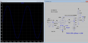

To answer all your questions it will depend on the a lot of components with optimised value for each. If only compared using the values you listed 1) cap tied to OT gives more NFB or less distortion 2) No 3) you make sure both channels have the same phase otherwise it can cause phase cancellation at low frequency.
I put together a circuit for you review, it has best of all options, if you have a spare secondary winding for nfb.
Unfortunately, I'm somewhat limited because my OTs do not have an UL tap and they only have a single secondary. The schematic I posted in my initial post was just something I found online that used local NFB.
Re: your comment on #3. I understand that if one channel is out of phase with the other it can cause phase cancellation of low frequencies.
The earlier advice by @Ketje was that it would be necessary to reverse the phase of both channels when the local NFB to the OTs is used. Otherwise there would be positive feedback and oscillation.
To rephrase my question #3: If the amp was wired to allow a switch from the local NFB (with the cap to the OTs with their phase reversed) to a standard cathode bypass setup (cap to ground), would it also be necessary to have the switch reverse the phase of the OTs at the same time?

There is no "dot" marking the phase of OT wire so it's difficult to tell if it's reversed or not. In my attached sch, the phase is marked with dots. So if you wire up accordingly it shouldn't oscillate. But if you reversed the OT secondary wire, it might or might not oscillated but definitely will if output level is increased (so more than 360 degs out of phase). So first to make sure the wire phase is correct, usually the 0V is ground.
So the ans to your question is yes, it will oscillate and increase distortion.
This you need to remember: The input and cathode is same phase, adding same phase (say from OT) to the cathode will cause the cathode signal to become higher and simulated a high cathode resistor apparent value thereby reduced the stage gain and distortion.
