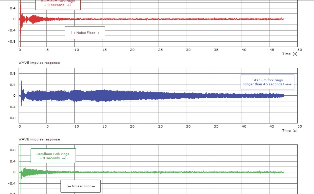

Further the impulse behavior to noise floor , residual ringing is best in class , for eg the residue noise after signal burst for Ti diaphragm is about 45 seconds , for Be diaphragm about 8 seconds .

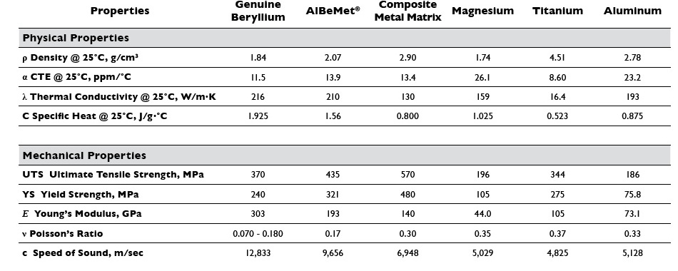

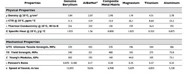

With reference to Be vs Ti Table , please find
3.1 Density
The density of a material, ρ, is defined as the mass per unit volume or ρ = m/V, where m = mass
and V = volume. For a given transducer geometry, a lower-mass diaphragm allows greater
acceleration of the moving system (F=ma), increasing both passband efficiency and highfrequency
extension (Kinsler & Frey; Eargle).

The Poisson’s Ratio of beryllium is unusually low. For acoustic applications, a low Poisson’s
Ratio results in reduced coupling of sound waves from one mode of propagation to another.
For example, an axial wave will remain an axial wave transferring less energy to transverse
modes of wave propagation. This ability to keep the different modes of propagation separated
can be of great importance in acoustics, especially at higher frequencies, or in imaging or surface
wave devices (Materion Electrofusion). In other words, a lower Poisson’s Ratio better
preserves the direction of the applied force.

Table 3: Predicted Bending Mode Frequencies
Natural
Freq(kHz) Aluminum Titanium Tin / Aln Beryllium Ben / Aln
1st mode 10.04 9.98 0.99 26.16 2.61
2nd mode 10.44 10.36 0.99 26.64 2.55
3rd mode 10.56 10.46 0.99 26.79 2.54
4th mode 10.62 10.52 0.99 26.90 2.53
5th mode 10.68 10.58 0.99 27.05 2.53
6th mode 10.76 10.66 0.99 27.28 2.54
First, notice that the Finite Element Model confirms the analytical solution above; if geometry is
held constant, beryllium’s bending modes occur at roughly 2.5x higher frequency than those of
the other materials.

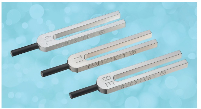

This confirms my dislike for Titanium diaphrams 😀 Even Aluminium looks better on the tuning fork graph 😉
Have you done tests on Phenolic diaphrams, if so could you post similar graphs please. I've heard some nice sounds coming out of one in particular.

dome. The modal density above the first bending mode is much higher than that predicted by
classical (flat) plate theory. Essentially, this lends greater importance to the first bending mode
frequency, since adjacent modes set in so quickly and densely above that frequency.
I strongly recommend Tad to take it on from here as they will benefit finally from the sale else the next post will have critical information on Tad drivers , and how to make Tad drivers from my side .
Best Regards
Suranjan

Be is superior , it does not end there , this is the just a few
1) Phase plugs , Tads is good but not the best
2) The shorting rings are missing ? in all compression drivers , ever wondered why ?
3) The obvious competition from ring radiators due to low moving mass & the d2 format .
