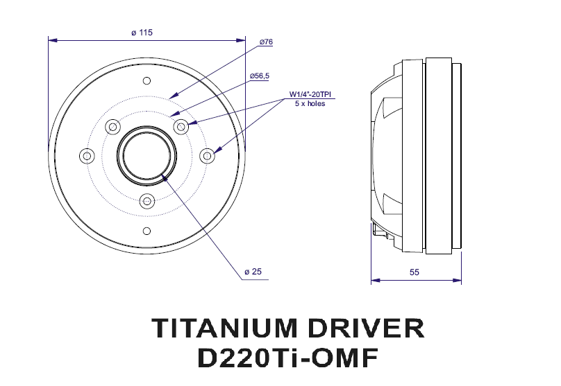

Question 1- Do the Selenium drivers, of the bolt-on variety, match up to the bolt pattern on the JBL 2345? I believe the 2345 has 3 bolts, 2" apart forming a triangle.
http://www.jblpro.com/pub/obsolete/Radial_Horns1.pdf
Selenium D220Ti-OMF-8 1" Titanium Horn Driver 8 Ohm 2/3 Bolt | Parts-Express.com
Yes, very likely.
The Selenium D220Ti-OMF-8 is Bolt on.
The Selenium D220Ti is Screw on.
http://www.selenium.com.br/site/assets/produtosfinal/292_pdfManual.pdf
Measures are in metric but I think they are the same. Confirm on your side (JBL's).
(Note: PE shows wrong (link) pdf for Ti/screw on).
Thank you...I see the triangulated screws. Another question- When I connect the capacitor, do I do it between, say, a female 1/4" jack positive lug and the positive driver lug? I plan to build a box to hold the lens and driver, so I can connect the speaker wire with a 1/4 male plug. Do I have this part right, or is it someother way I am unfamiliar with? Thanks in advance...

Note: There are small differences in the mounting dimension due to the measurement standard used for design of a particular driver. Some require M6 Cap Screws (metric), others require 1/4-20 cap screws (English) for fasting the driver to a horn, and the BCD's very 0.005" or so. These differences should not present a problem when fastening drivers to the horns. All listed here have a 1" dia. throat exit.
