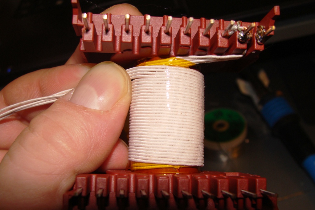

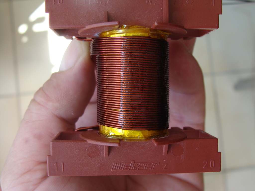

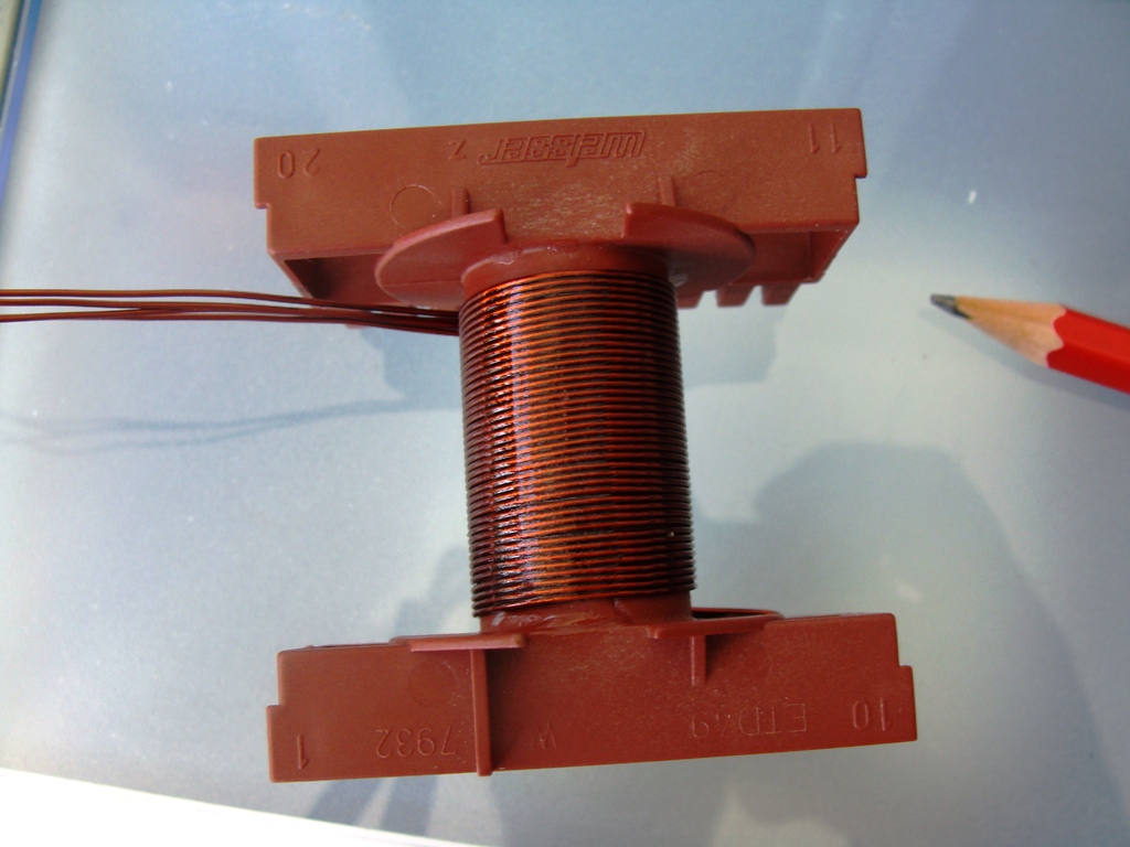

I really believe using litz wire until 50 kHz it is a myth
We can calculate the skin effect and we would notice the use of normal 0,6 mm diameter wire is just enough.
For pretentious guys it can use silver plated wires.
Mircea.

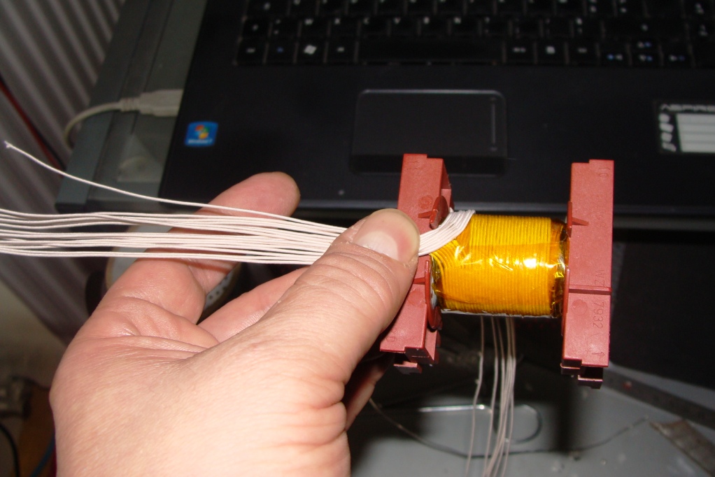

I have just bought a 30m roll of 25mm wide ~1.6mil/thou thick, including adhesive, Kapton.
Is this suitable for the interlayer insulation film?
I have some experience with litz wire but like I said it is a myth until 50kHz.
Kapton tape is just fine but you must pay attention between primary and secondary winding.
I used aluminium tape like un shield but of course, not in short circuit.
Primary winding split in two part.
Mircea.

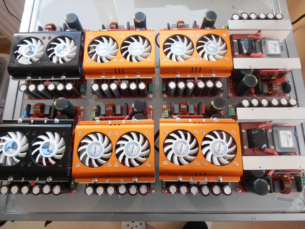

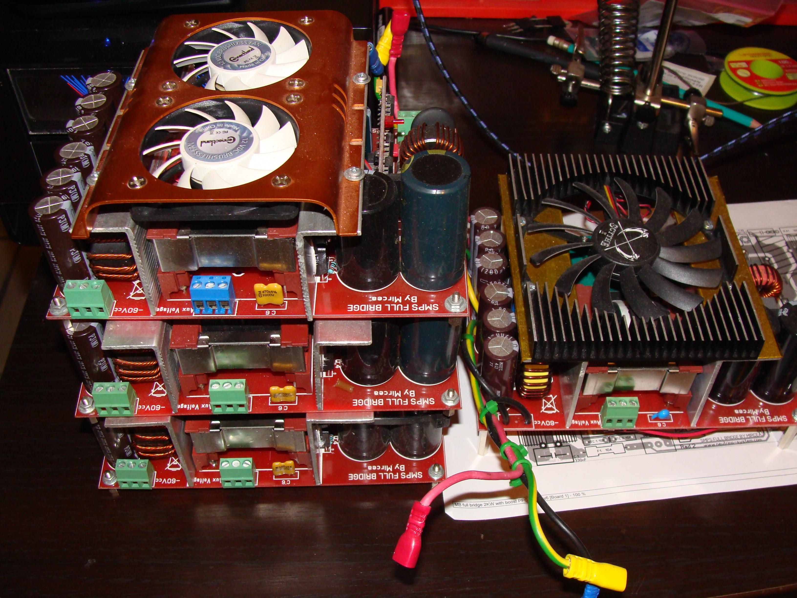

I'm talking about hard switching until 50 kHz not about resonant mod
I can post a small clip with my SMPS full-bridge hard switching based on a ETD49 core 3C90.
9A at 110Vdc almost 1 kW. Not bad in my opinion.
https://www.youtube.com/watch?v=eMJUEA1k8cg
https://www.youtube.com/watch?v=56iD4KfRcjQ
If you have some tests with your prototype you can post?
Best regards,
Mircea.
