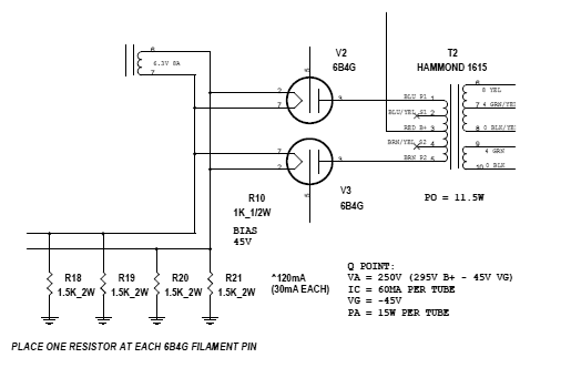

I'd like to build Pete Millett's 6B4G PP amp where he uses 1.5k wirewounds tied to ground per each 6B4G filament connection without bypass capacitors.
It seems to me that for the cathode bias of 6B4G without bypass capacitors, the internal resistance will be increasing to more than 2Kohm. Is there any benefit in doing so, especially in an ouput stage? I know that for the preceeding stage(s) we can use that technique to lower distortion (gain also). I see in other amps that in most of them with cathode bias, they'd use bypass capacitors.
Thanks for your help!
Actually, if you look close, and consider that the 6B4 filaments are effectively a dead short, the cathode bias is made with four paralleled 1K5 resistors. For push-pull class A triode stages only tiny (hopefully! because it means that the stage is well balanced) signal voltage appears across the cathode resistor. This is very similar to the way that only small signal voltage appears across the B+ supply.
I see 375 Ohms?
I see 375 Ohms?
I think the OP's concern must be about increased source impedance at the anodes, but this is class A push pull, so it doesn't happen.

Thanks PRR, Chris!
It dawn on me that I was worried about increase source impedance at the anodes not the internal impedance of the tube (my tube knowledge is somewhat limited). Now that I know due to you clear explanation above.
