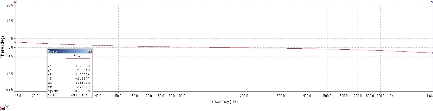

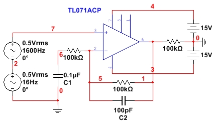

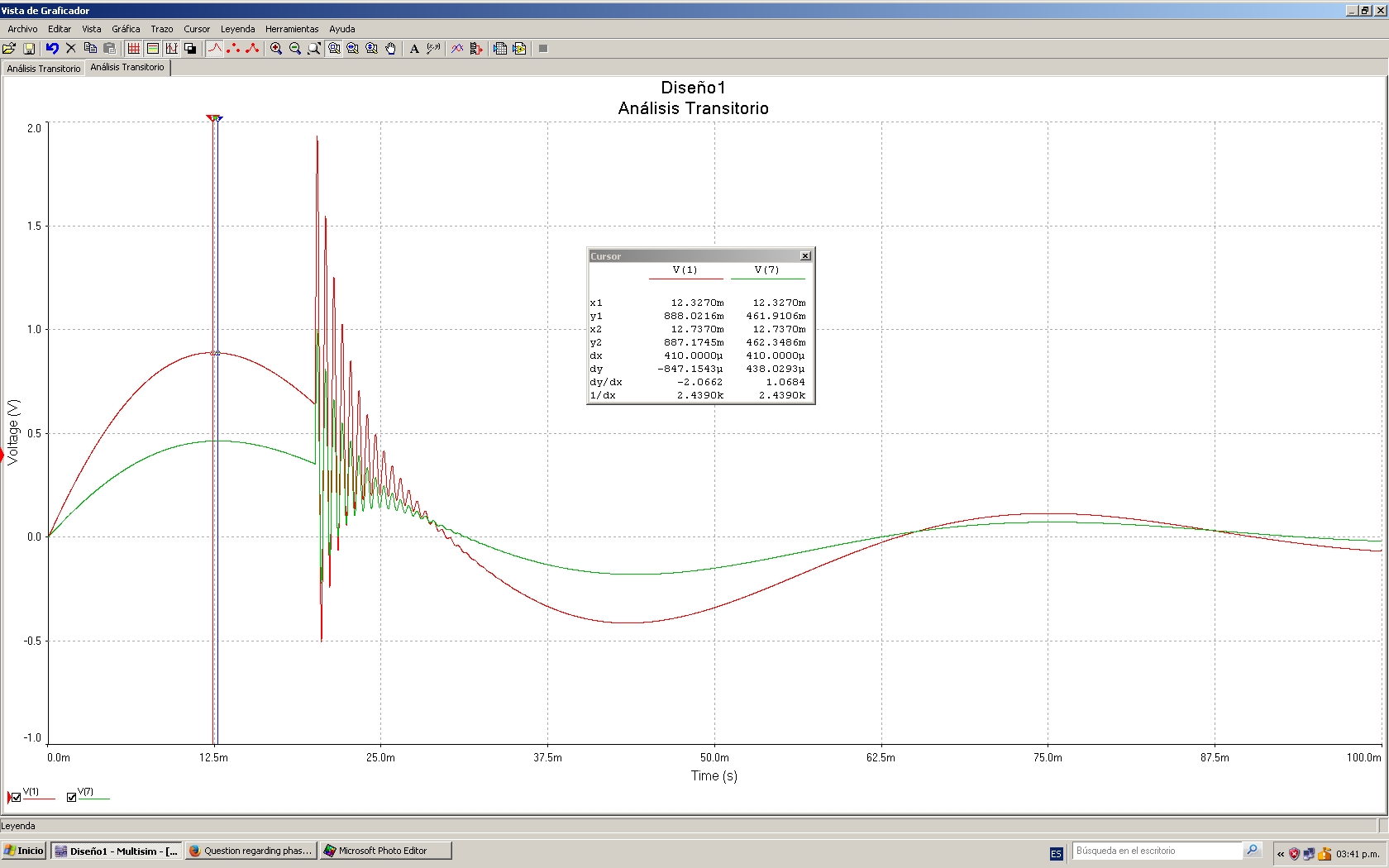

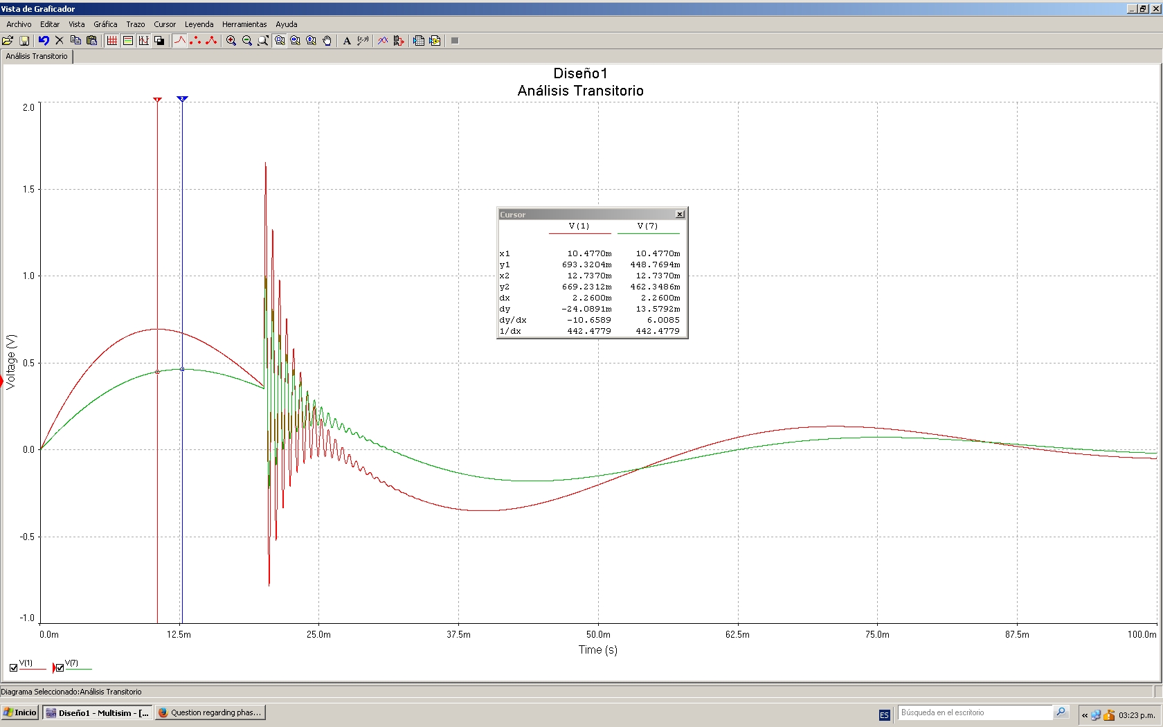

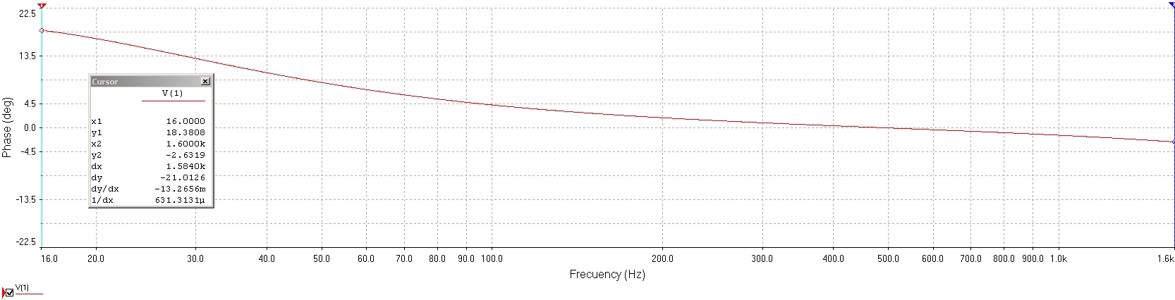

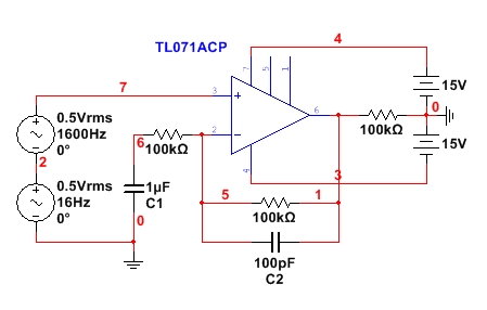

The very simple experience that I can contribute, shows that the differences between the phases of two amplifiers alters the precise temporal occurrence between the different sounds of a musical passage. For example, if you take two muffled sounds, but of frequencies well differentiated from each other and of different occurrence in time, and if these same signals are passed through two amplifiers whose phases differ significantly around the margins of the band audible, it will be verified that the temporal difference between these two sounds will be modified to a much greater extent in that amplifier whose phase deviates more than ideally. All this occurs simultaneously with the alteration of the amplitude envelope of the signal and the energy with which it is imparted to the output.
At the output of the amplifier with the phase farthest from the ideal, the first peak of the damped signal with the lowest frequency moves away from the first peak of the highest frequency damped signal.
