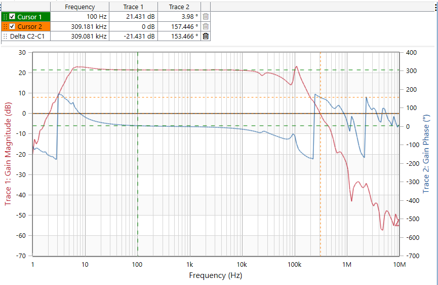

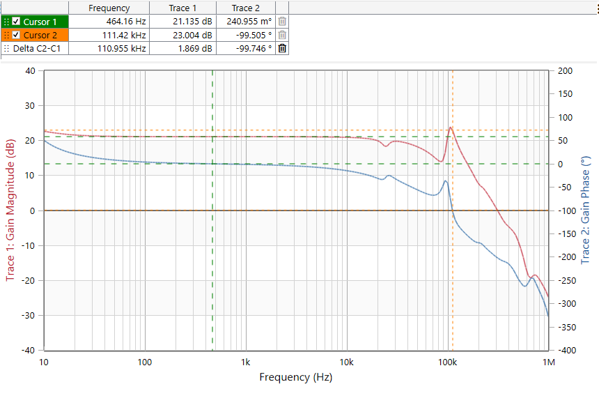

Just to put some info -- this is a Heathkit Williamson W-3M-- I put the amplifier onto the VNA to look at the frequency response from 10Hz to 1MHz -- a 4 ohm resistive load. This is the output @1W.

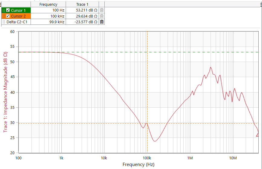

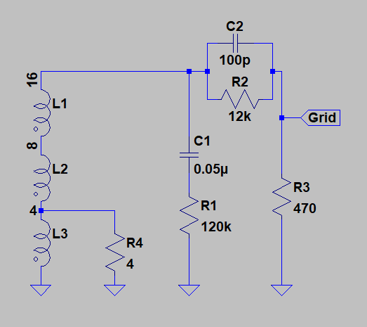

This appears to have been a Heath wired amplifier -- has a somewhat different compensation/feedback scheme than in the schematics I've seen. I injected a test signal into the 16 ohm traf output and plotted the impedance (with a 4 ohm dummy load).

Ta muchly jackinnj. Nice bit of kit to be able to do those wide-bandwidth plots !
The previous plot of phase made it difficult to discern the 180 deg HF crossing, but this recent plot sort of makes that frequency easy to discern now at about 220kHz, where gain is still about +6dB (!). Going out beyond 1MHz sort of shines a light on whether your resistive load is still pretty much resistive - I typically use PRO2 range of resistors with the comfort that the datasheet shows negligible reactance out to 10MHz.
The LF end shows only a slight peak at around 8Hz, with 180 deg at 3Hz but still with about +7dB gain margin. It suggests the CR networks are dominating the LF response and the OPT LF corner is a lot lower and below 1Hz.
