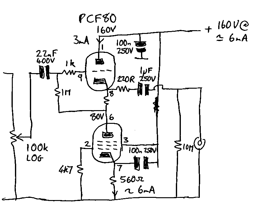

Long time ago, EC8010 suggested that : "a pair of PCF80 would make a very nice line stage/buffer. Use the triode section as a cathode follower, and sit it on the pentode section used as a constant current sink. Use a 300mA DC constant current regulated heater supply, and you'd have something with performance completely out of proportion to price."
I've a dozen of those tubes, transformers, caps, resistors and so on. Cost would we be near zero 🙂
For the cathode follower, ok, I found some articles explaining me how to design them. However, I've some problems to find a simple ccs using a pentode. Could someone link me to one ?

Let's see if I can give you a good description. At least for now, I do schematics by hand with pencil and paper.
You stack the triode on top of the pentode (triode cathode connected to pentode anode). Connect triode anode to B+. Connect pentode g2 to B+ via 1 Megohm resistor. Connect pentode g2 to pentode cathode via a small cap. Ground pentode g1. Connect pentode cathode to ground via series combo of variable resistor and 10 Ohm fixed part. Use Ohm's Law to set the current by measuring the voltage drop across the 10 Ohm fixed resistance. I like battery bias; so, connect + side of 6 V. Lithium device to triode cathode. Connect - side of battery to 1 Megohm grid leak resistor. Connect grid leak resistor to triode grid. Cap. couple triode grid to wiper of volume control. Cap. couple (4.7 muF.) triode cathode to O/P jack. Wire 1 Megohm resistor across O/P jack.
"You stack the triode on top of the pentode (triode cathode connected to pentode anode). Connect triode anode to B+. Connect pentode g2 to B+ via 1 Megohm resistor. Connect pentode g2 to pentode cathode via a small cap. Ground pentode g1. Connect pentode cathode to ground via series combo of variable resistor and 10 Ohm fixed part. Use Ohm's Law to set the current by measuring the voltage drop across the 10 Ohm fixed resistance. I like battery bias; so, connect + side of 6 V. Lithium device to triode cathode. Connect - side of battery to 1 Megohm grid leak resistor. Connect grid leak resistor to triode grid. Cap. couple triode grid to wiper of volume control. Cap. couple (4.7 muF.) triode cathode to O/P jack. Wire 1 Megohm resistor across O/P jack."

00940 said:Long time ago, EC8010 suggested that : "a pair of PCF80 would make a very nice line stage/buffer. Use the triode section as a cathode follower, and sit it on the pentode section used as a constant current sink. Use a 300mA DC constant current regulated heater supply, and you'd have something with performance completely out of proportion to price."
Sorry about the delay (took me a while to find an envelope to draw it on). Here it is:
I would do it the other way. Pentode as the signal input tube. Triode's cathode to negative rail through the current setting R. Triode's grid to the negative rail.
The triode will be a fine load for the pentode's cathode, and the pentode's plate will be more tolerant of B+ ripple. Pentode's anode to B+, g2 to one end of a 100k resistor, and B+ to the other. 0.5 uF to 1 uF cap between g2 and the pentode's cathode.

That's not as advantageous as it might seem. The ripple on a triode plate will be attenuated in the CF output by a factor of mu (20 in this case). Whatever ripple is present on the screen will be passed unattenuated. Now, you do have an RC rolloff, but with the values you give, the attenuation isn't any better than mu anyway. Sure, you could go up another factor of 10 on the cap, but that increases size and cost.
It's pretty easy (see my preamp article) to get the ripple down to ridiculously low levels, so why not put the big cap toward that end? That way, one can take advantage of the much superior CCS characteristics of a pentode plate.

ALright, I pulled the sheet on this beastie. It isn't a very good tube for the use you all propose. Two EF184 will cost $5USD and they have 15 mA/V transconductance. That amounts to ~50R output Z for a cathode follower. They have 90kOhm plate Z so they make fine sink-CCS too.

Bandersnatch said:Two EF184 will cost $5USD and they have 15 mA/V transconductance. That amounts to ~50R output Z for a cathode follower. They have 90kOhm plate Z so they make fine sink-CCS too.
Agreed, EF184 is a very nice valve indeed and if you're going to gp to the trouble of nice metalwork specifically for a cathode follower line stage, then it's a much better choice, However, if you need a triode cathode follower with pentode CCS in an existing piece of equipment and have room to bash a single hole with not much HT, then the PCF80 could work very nicely.
I take the point about ripple rejection and g2. My back of the envelope sketch used the minimum voltage possible and the curves were for g2 = 170V, so I just took g2 to the HT. A better idea would be to do some tests with a lower g2, allowing RC smoothing to g2.
