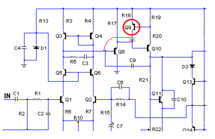

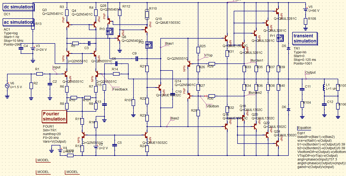

Here's an attachment.
I presently have both a VI limiter and a TRIAC shutdown circuit in there.
The VAS consists of Q10 and Q12 with Q8 acting as a common collector to not load transistor Q3. One problem is that when Q13 turns on to perform V-I limiting, Q10 supplies more current than it can handle. A current limiter can be placed on Q10, but then Q8 still tries to force Q10 to a particular voltage.

Hi profdcd9
I see several things to add, verify or change.
1. Add delay to the VI circuit. Cap across R26 & R27
2. Add base R’s to Q5, Q6 or verify they are stable?
3. Add current limiter to Q10.
Duke
Duke
Topology Tweak
Move the collector of Q9 from its current location to the base of Q8.
You might have to tweak C9 a little...it depends on how big Q9 is.
Check it for stability under limiting behavior.
48v rails in combination with 4 pairs of output bjt’s.... I would remove the VI limiter. I can make you a quick simulation regarding SOAR Tomorrow if you would like.
You might be able to back off on the protection limits...but you still need something to prevent short circuit disasters.
see enclosed upload

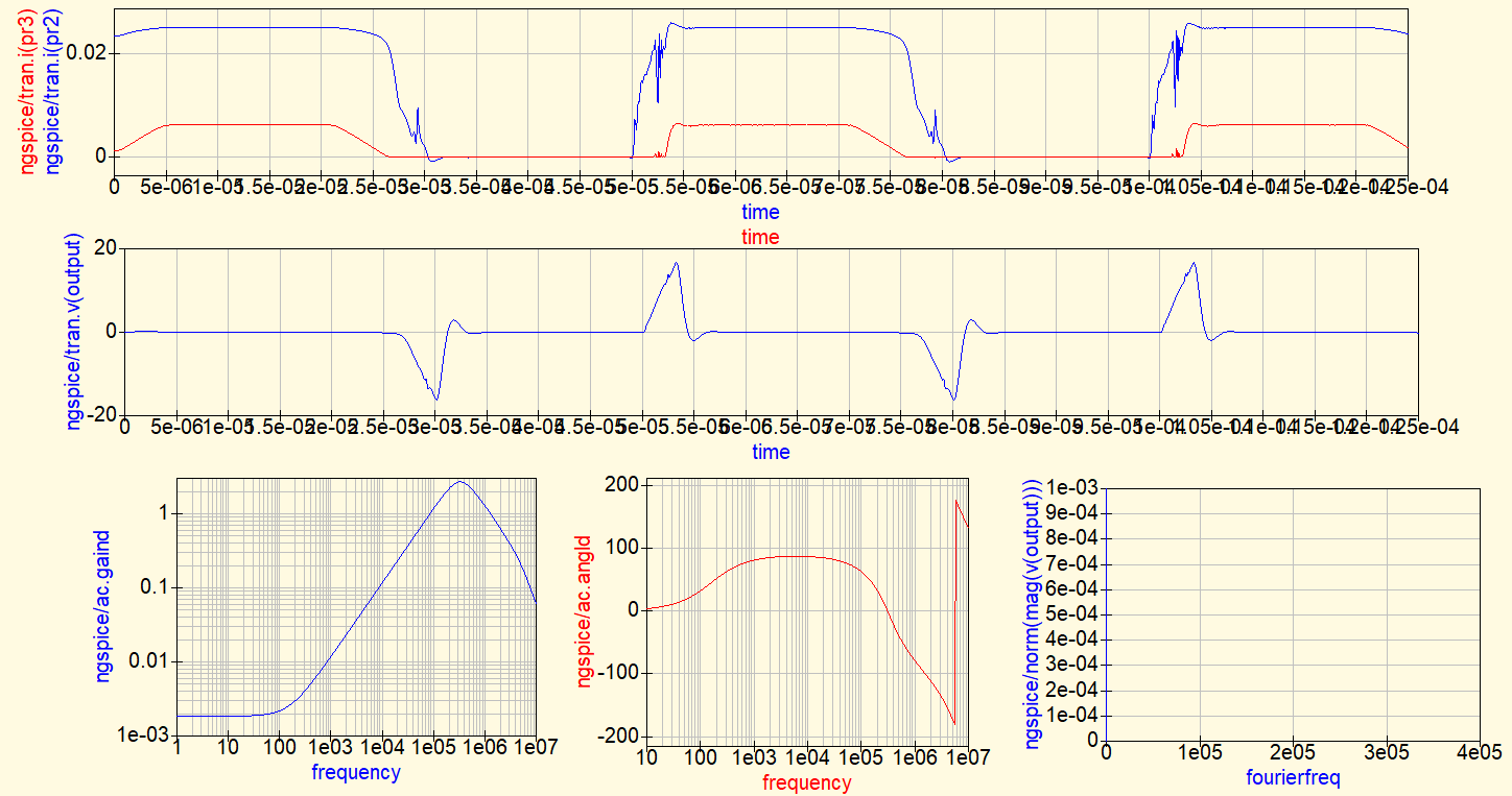

I tried what you suggested and it seems to work. I don't know why I didn't think of that before. It seems like the sensible thing to do.
I did a simulation of it with a short circuit. The VAS current is limited to about 25 mA and the output transistors have some spikes of 20 volts (due to inductance). But it seems like this would be much less likely to cause a disaster.
I'll have to give it a try.
Thanks!
Yes...I think the driver should be a bunch happier now...
My only concern would be a short circuit on the output of the amp...that was what I had in mind because I hadn't looked carefully enough, and mad a bad assumption!

Where are the collector diodes on the VI limiter transistors? Normally these are needed to prevent bad-driving the limiters in the opposite cycle at high output levels.
